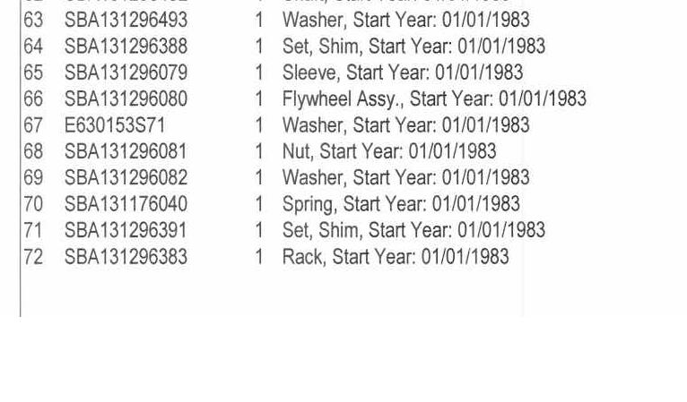

The same thing happened to me after I drained the oil from the injector pump. I figured that I had air in the line so I tried bleeding by the book for a few days but no dice.
Solution for me: Removed engine oil filter. Removed cover / plate on injector pump. Made sure that the "spring" (sits on a guide rod) was lined up with the (rack) aka item #72 in parts diagram. Replaced oil filter and added oil back to injector pump.
She scared me when she fired up because I had it set on "rabbit" mode for bleeding purposes.
It doesn't even look like there is much to hold that spring in position except for the guide rod so it would be very easy to put it back wrong.
It is a very weak and flimsy spring. Hard to believe that it makes that much difference but it did.
P.S.: I don't remember if your 1700 oil filter is in the same place as my 1710 but if it is then it is a whole lot easier to remove the cover plate if you take off the oil filter. I did not drain the engine oil first. The only oil that came out was from inside the filter.
My tractor was sitting on a slight incline.
   / Changed fuel injection pump oil and now Ford 1700 will only idle #26
The only thing I would add to Kent B is that is of utmost importance to put a witness mark on injector pump base and the timing cover so the same injector timing will be duplicated. The procedure to make sure injector fires at the right time is not that easy and might be finicky. I have read the procedure and though, I just go ahead and mark the timing while all is working well.

JC, I am brand new to this forum. I just bought a ford 1700 (really like it). I have read many of your helpful post. I am having the same problem as Pclausen was having with the injector pump oil change and now it only will idle. I followed the train of "how to fix". Unfortunately this did not fix mine. I was looking to see if you had any other suggestions. I know this is an old posting and don't even know if you are still an active member, I thought I would give it a shot. The only thing I have not done is take one of the lines off that runs from the injector pump to the actual engine head (the metal tubings - 2 of them). I got one off but not the other one yet, could there be an "air bubble" in there that is causing the problem. Thank you in advance for any advice.
