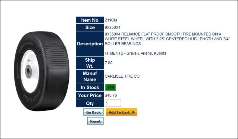

I replaced mine with these 1 piece Carlisle wheels but still have the old 3 piece Marathon wheels.
They may still reusable with the Carefree replacement tires.
