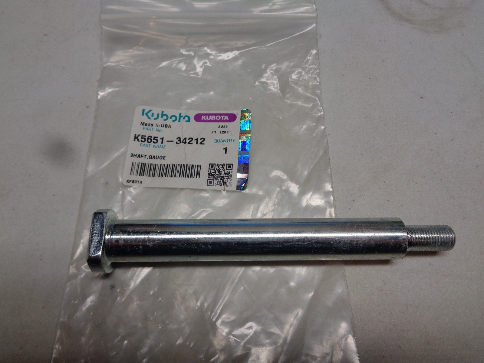

.... A couple of points about the recommendation from arto98607. The wheels he linked too are the right size, but they are white instead of orange (if that matters to you). Also the axle for the wheels would take a fair amount of work to make. I have a lathe and welder and I could make the axle from drill rod as arto98607 suggests, but new axles were $40 each on eBay and my time is worth more than that if I were to make them myself. They are not simple:

My F3060 has a rear discharge deck (RC72R-F30) with very simple axle shafts of straight 3/4 inch "rods" with 5/32" cotter pin holes drilled at each end.

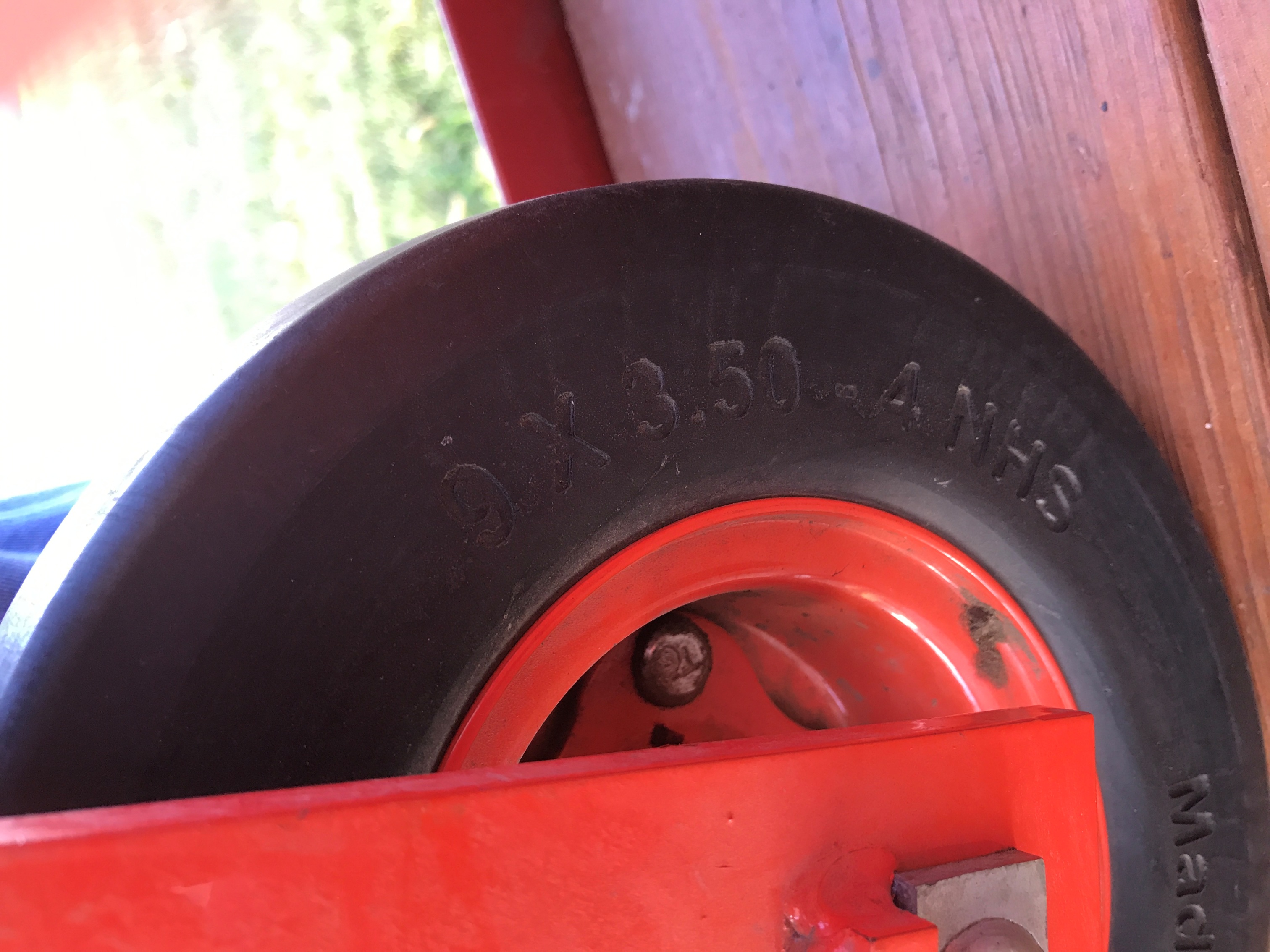

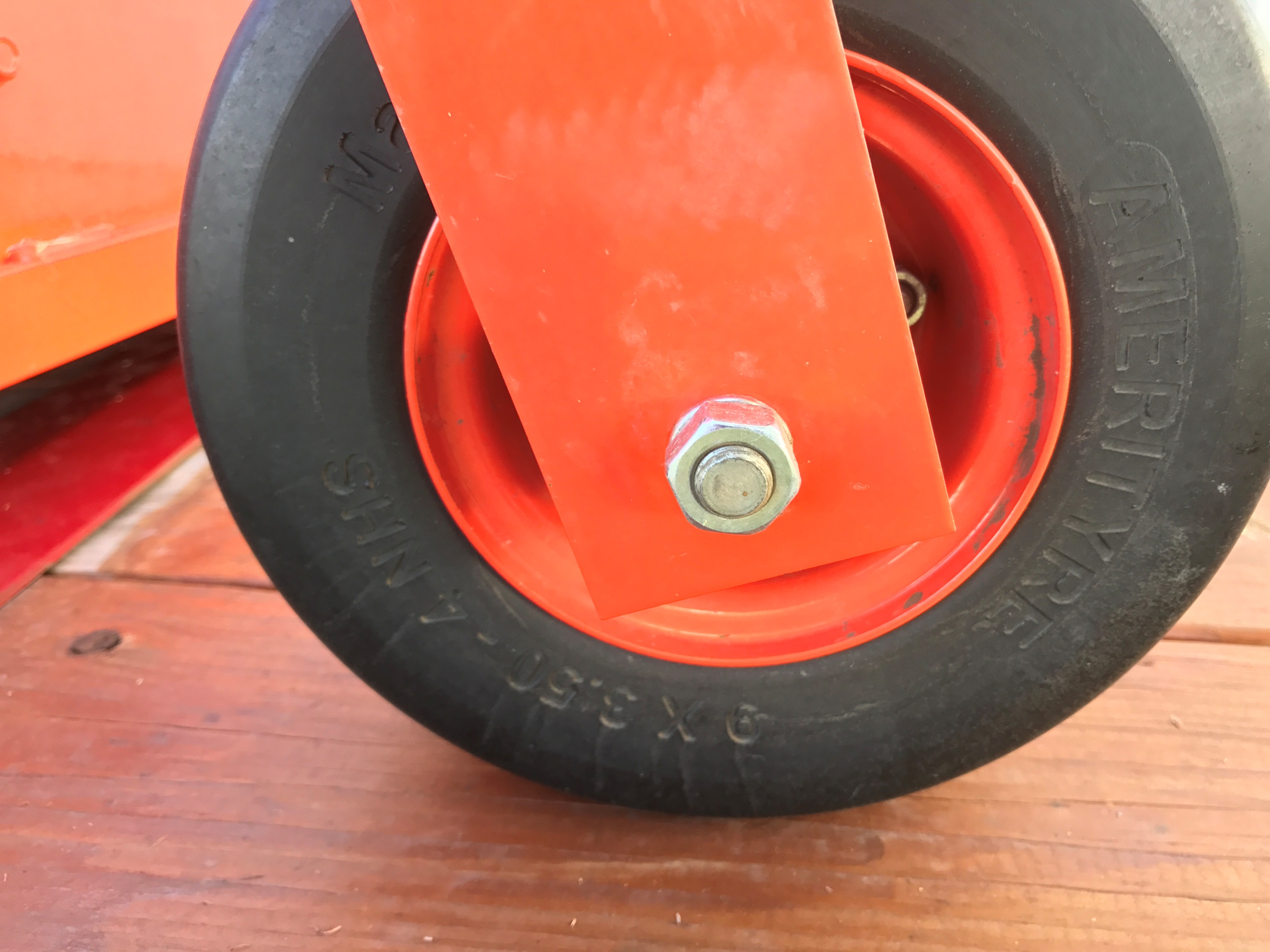

Here are a couple of pictures of the tires. The factory rims were used.
Are they completely solid or do they have a hollow core. Will they flex any?
   / Changes to new F2690 #28
Don't know about the Amerityre, but the Carefree ones I have are a high density solid polyurethane foam, flexes a bit, probably about the same as a properly inflated pneumatic, maybe a bit less. The nice thing about the gauge wheels on these mowers is they are a three piece wheel. You can unbolt the wheel half's and assemble them back together inside the solid foam tire. With one piece wheels, you have to have them pressed onto the rim using a special cone and press.
Thus, these wheels can be converted to solid core by just purchasing the tires. I bought the tires and then discovered I needed new wheels (roller bearings worn out) I have since found I can by the wheel and solid tire combo for less than buying them individually so I am selling the tires.
You can buy the tires direct from from Carefree Tire - part number TI-9350-4275S.
9/3.5-4 inch Smooth Tire, 2.75 inch Bead Width - Carefree Tire
This is a 9 x 3.50-4 (2.75 bead width) for $24.95 each plus shipping and tax (if you live in TN). There are other sources and brands - Ameritye like 628pm has - being one. Be sure you get the 2.75" bead width. Available on eBay as well. If you are shopping for the wheel / tire combo, be sure you know your shaft size and hub width. Many suppliers list the 4" x 5/8" hub as correct for these decks. Mine needs a 3/4" x 3 1/4" hub.
I was lucky to find new axles on eBay for a reasonable price as well. Keep these wheels greased.....
Good luck.
