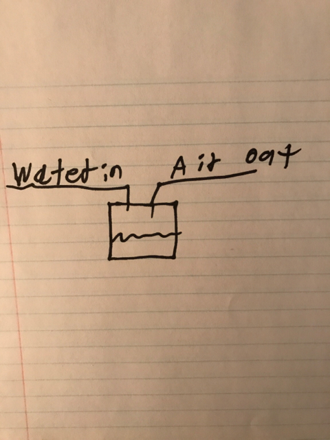

Looks like a liquid/air separator will be too expensive. I may try the $10 vacuum pump that hooks up to an air compressor. Otherwise it may be the $5 squeeze bulb with tubing. Still a pain.....
   / Changing fluid-filled tires - how to drain the stuff out? #23
It doesn't have to be an elaborate separator. Something simple like this would work as long as you don't over fill the bucket. The biggest problem is something cheap like a 5 gallon bucket is likely to collapse under the vacuum pressure. IMG_8940.JPG
   / Changing fluid-filled tires - how to drain the stuff out? #24
That may work. Won't be pulling much vacuum. Thanks for the tip.
