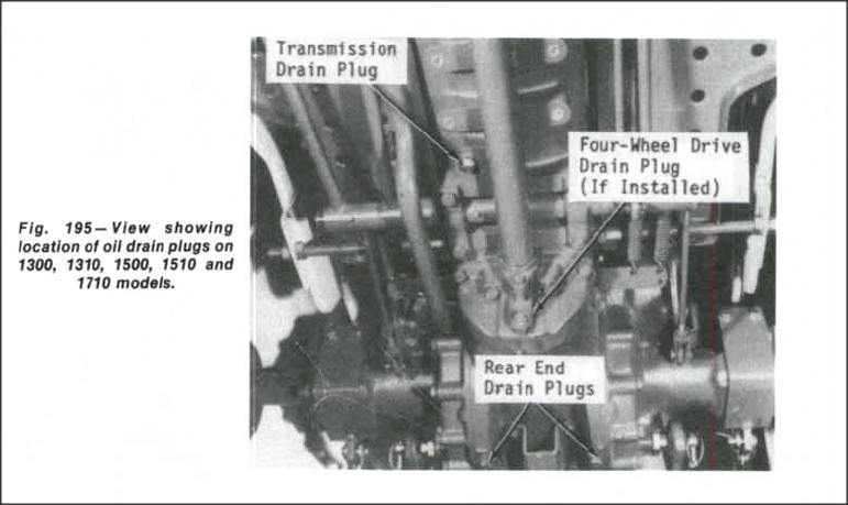

I own a 1993/94 Ford Newholland 1215 compact tractor and after 870 hours I will be replacing the hydraulic fluid and filter. I am the second owner of this machine and I do see evidence that hydraulic fluid and filter have been changed previously. We no longer have a Ford/Newholland tractor dealership in our town forcing me to service my tractor personally. I need to know where the specific location is for the hydraulic drain plug (this is a manual shift model, clutch and all). I presume the manual gearbox has its own type gear oil and drain plug location. I just need to drain the hydraulic fluid, flush the system and replace the hydraulic filter and fill the system up with the appropriate grade and viscosity fluid. I have not obtained the service manual on this model. Going forward, I will locate a good source for the service manual. At the moment, I just need to service the hydraulic system. Any ideas on this model could prove helpful. I suspect most members here have much larger tractors though I presume they all share service similarity for the manual shift models. Thanks for any assistance I can receive here on the forum.
I am automotive mechanically inclined, just have not worked on tractors.

The transmission, rear end and hydraulics are all the same. Drain at the rear end plug and you have drained as much as you can.

Look under the tractor and you should see several drain plugs, like shown in the enclosed photo covering Ford 1300, 1310, 1500, 1510 & 1710 models.
Just like Tractor Tech said above, my 1310 uses the same oil (Ford 134 or equivalent) for hydraulics, transmission & rear axle.
Manuals should be easy to find from eBay or dealers like this who sell online:
