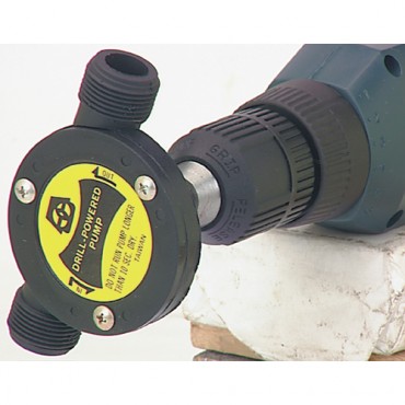

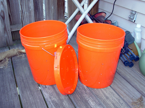

For the OP... 2ea 5gal buckets from Home Depot, 1 drill pump and some hose = fast and done.
(then use a small drip pan to get what the pump didn't)
