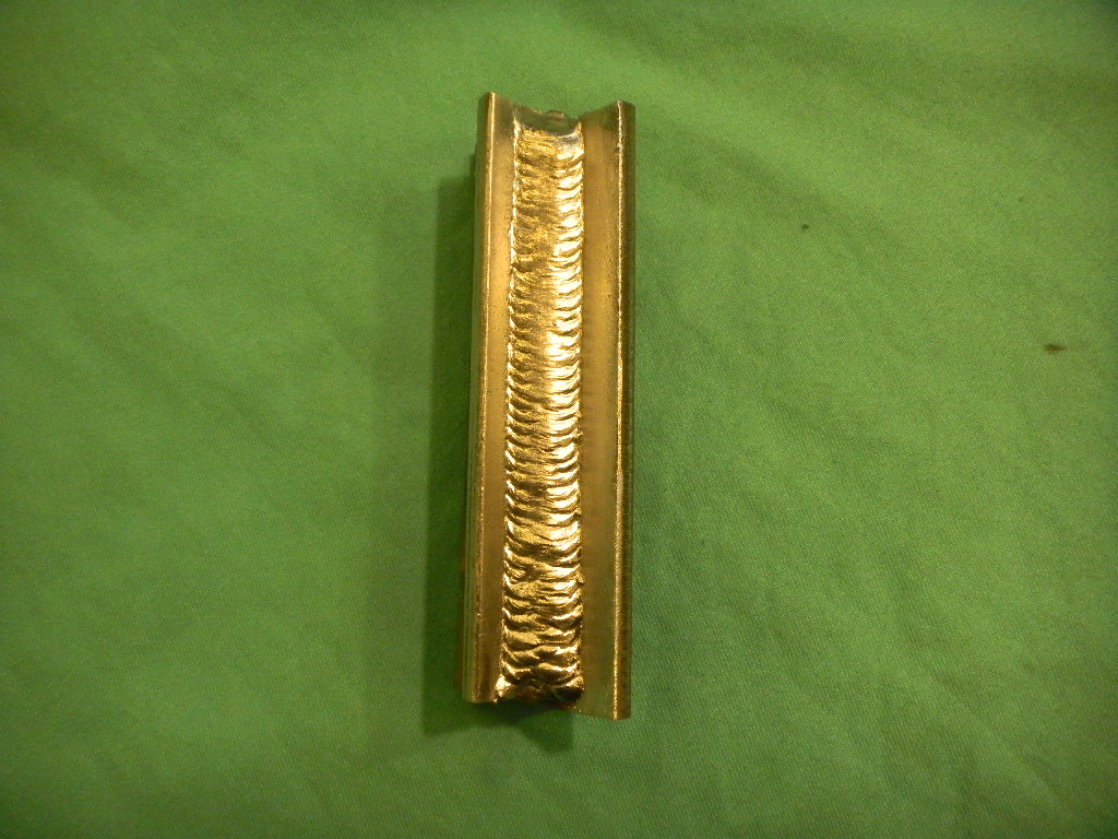

I'm confused by you guys who are using regular MIG setups to run aluminum wire. I though spool guns were necessary to run aluminum as it is too soft and pliable to be "pushed" from the machine to the regular gun tip. That is why spool guns were invented so there was less distance to push the aluminum wire. No?

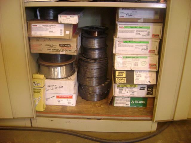

Is it just Lincoln Innershield wire, or others ?
   / Changing liner in a mig gun ? ? ? #16
Been so long I had to go back out to the shop to make sure.:laughing:
Hobart's Fabshield 21-B has a lube, but not near as heavy as Lincoln's wire.
   / Changing liner in a mig gun ? ? ? #17
Do you always use name brand wire, and is there a really big difference?
   / Changing liner in a mig gun ? ? ? #18
You know, I never really thought about it! But looking at that cabinet of wire I guess I do. Few days ago I went to the welding supply, asked for a roll of Lincoln .045 L-56 wire, (love that stuff). They no longer carry Lincoln! Sold me a roll of some wire, but I can't remember the name. Just went out to look, no name on the box, so it must be a no name brand:laughing:. Haven't tried it yet, but the salesman, (known him for 25-years) says everyone likes it better than the L-56.:confused3:

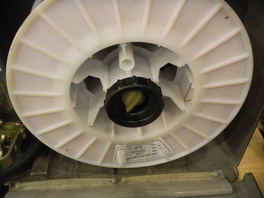

I'm confused by you guys who are using regular MIG setups to run aluminum wire. I though spool guns were necessary to run aluminum as it is too soft and pliable to be "pushed" from the machine to the regular gun tip. That is why spool guns were invented so there was less distance to push the aluminum wire. No? .
You can run aluminum through your mig. You have to run the stiffer 5356 wire and not the 4043. The thicker the wire the easier it is to feed. You need to keep the cable of the mig gun pretty strait,and you don't want a lot of tension on the rollers or it will egg shape the wire. Spool guns are much easier and you can run the softer wire. You also need 100% argon.
