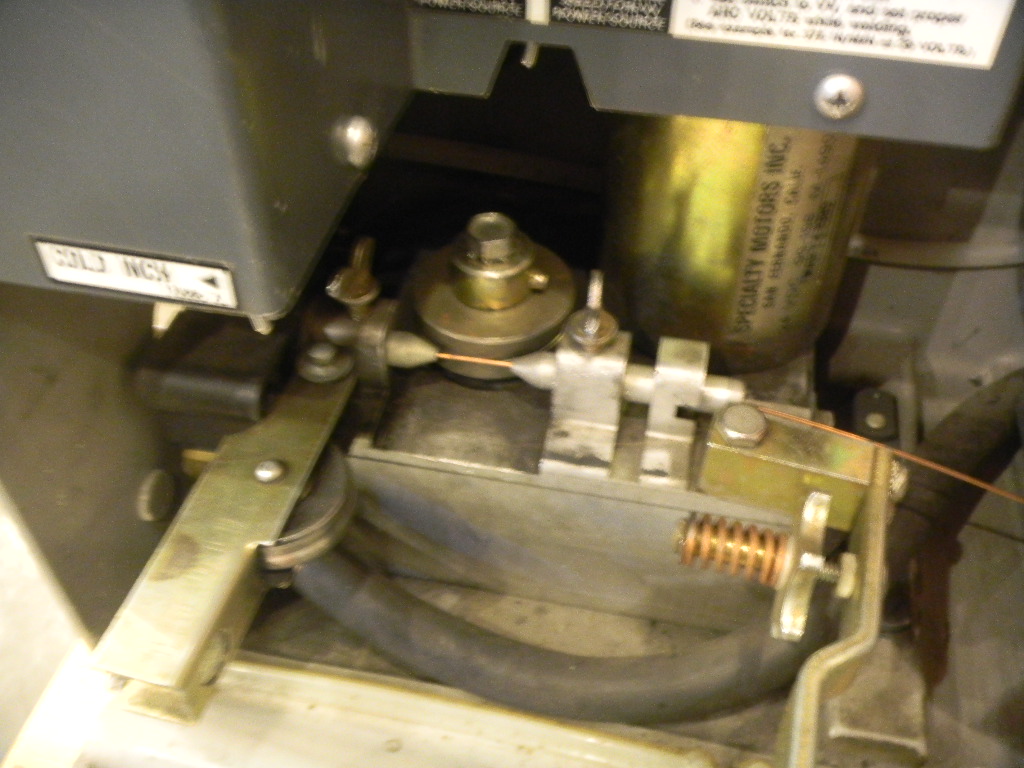

A couple pages back, the poster said there is a 3/4" gap after the feed roll. I would say the outlet guide is missing. there should not be Any Gap..

This is how I like my guide tubes placed.

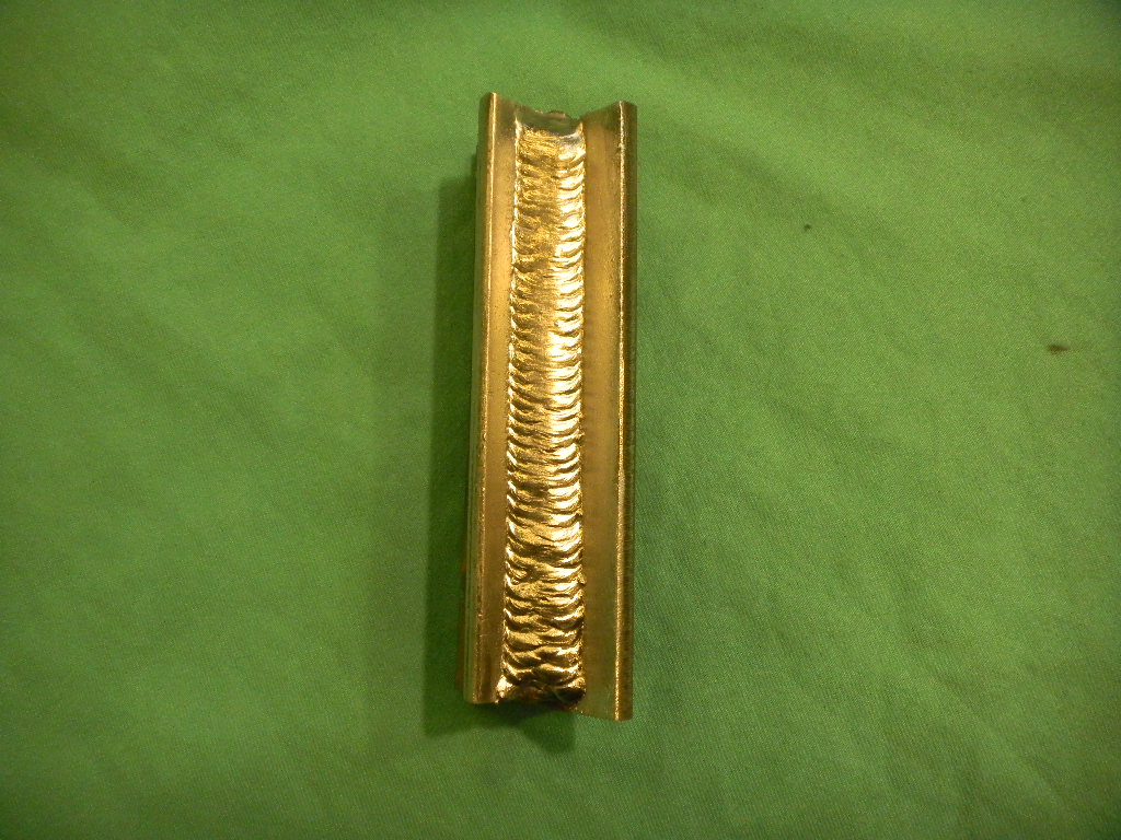

Hi J_J, I ran some of that no name wire this morning. It seemed to run a lot like Lincoln's L-56, but little more splatter than I would like. Now that could very well be I don't have my settings on the new Invertec. A lot of bells and whistles on this machine, may take some time to figure out!:confused2:
This was .045 wire vertical up weld.
