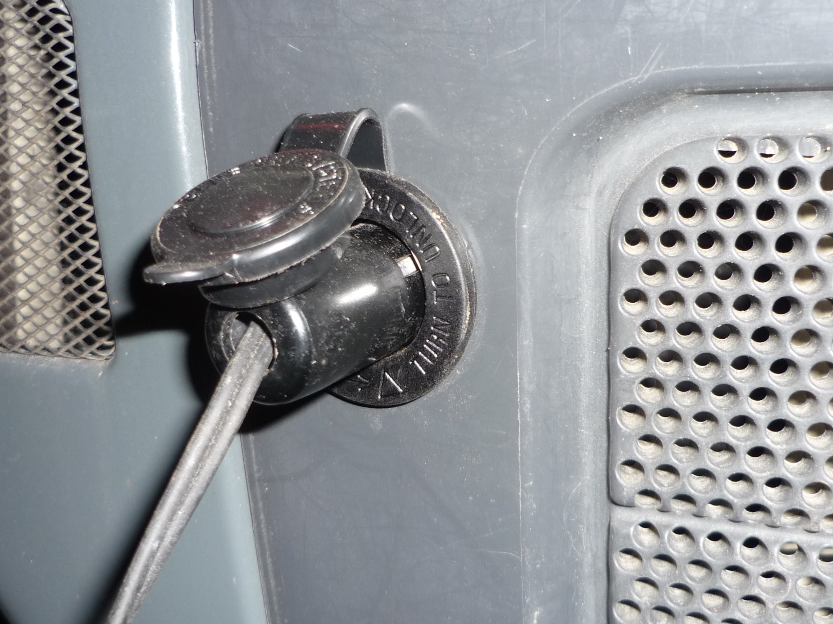

Maybe just because of dumb luck, I have had no problems with my tractor batteries. I do use a cheap HF battery tender, and I installed a 12V ciggie lighter outlet to make it easy to plug a tender in, and unplug it when the tractor is used.
That's exactly what I did. Except I added a switch on my dash for the outlet. I used that to run a sprayer last summer, just shut it off with a flick of the switch.
