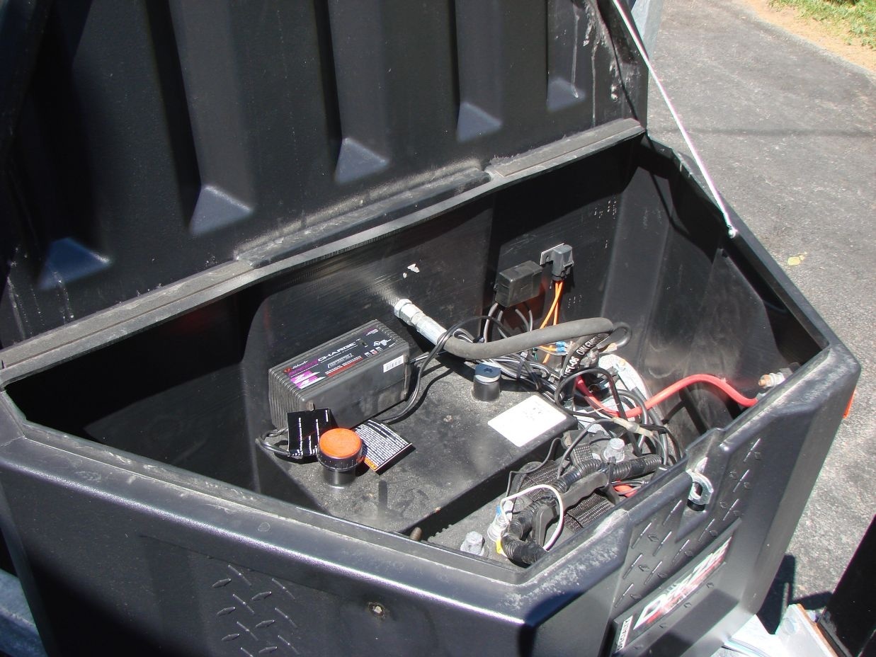

Yup. Short trips can take a dump trailer battery down fast. Now if your trailers dump is also powered down then the battery can't keep up. I keep mine on a trickle automatic charger whenever it's not hooked up to the truck. That way I know I'm heading out with a fully charged battery.
