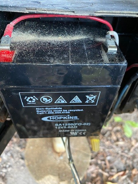

Yesterday I had about 2500 lbs of lumber on my trailer to be delivered so I decided to check its battery voltage before pulling because it had been about 1 or 2 months since the trailer was towed. I measured 12 VDC. Good, I thought - now can it deliver the current to lock the wheels? I said in an earlier post that the battery is about 10 years old - I really don't know when I bought it but it was certainly between 5 and 10 years ago. I disconnected the plug to the truck battery and pulled the lanyard to disconnect the trailer battery and started to pull it and all 4 trailer wheels locked. Wow - pretty good for and old battery. I bought it from eTrailer - see pic below.
