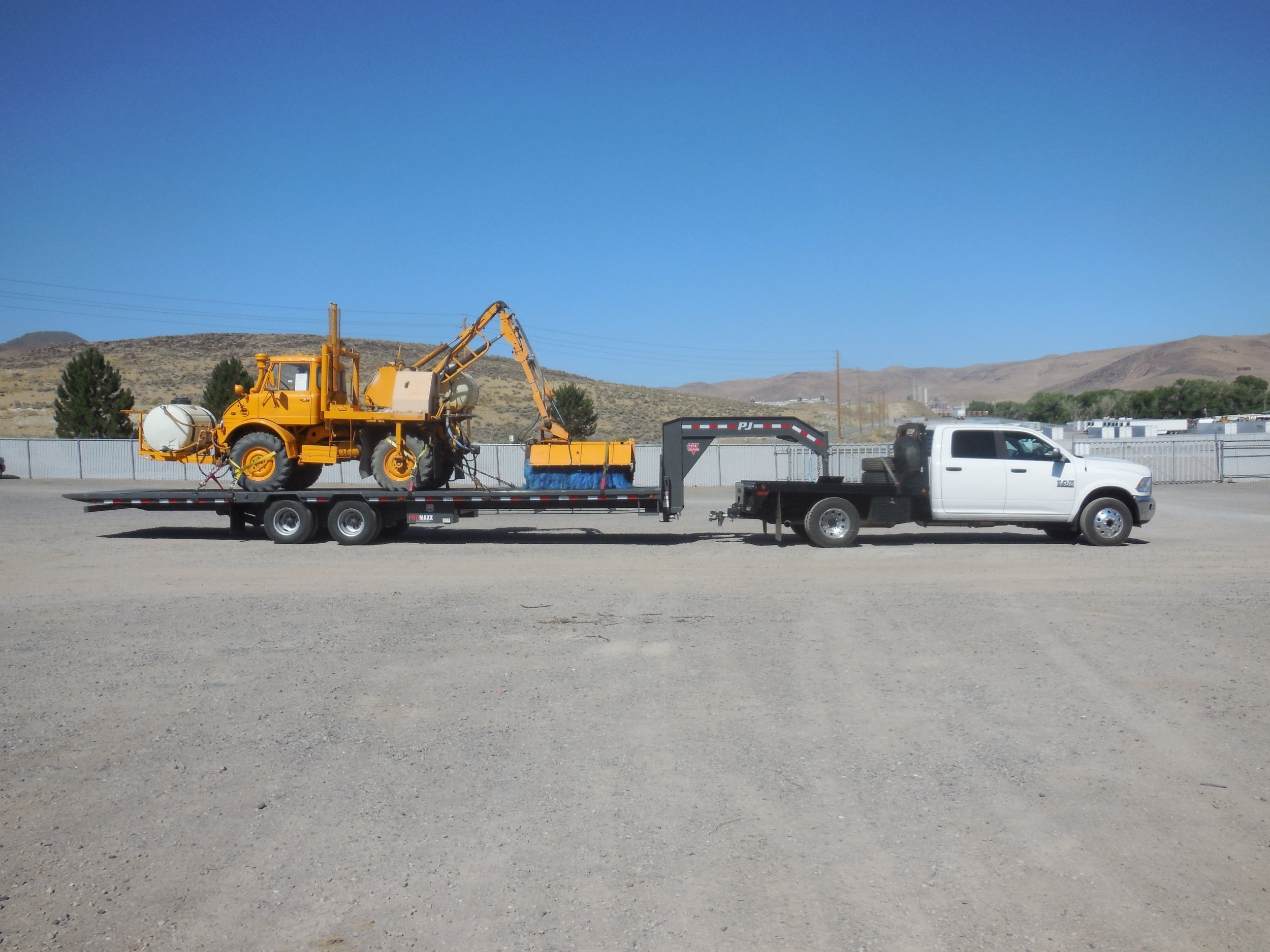

As promised, a tie down job I'm not proud of. Didn't trust just the few chains I had. Not that the lasso straps on the tires would do much good, but still.
Unimog?
Are you using it as a street sweeper?
Or a very different project build?

Yep, a Unimog. It was a tunnel washer. Bought it because it was dirt cheap for an MB4/94 equipped with all the good stuff - front and rear PTOs and hydraulics, working gears (2,000:1) etc.
At first I figured I'd put a hydraulic flail mover on it and cut the grass along the ditches, but with the whole rear apparatus being controlled by switches instead of levers that really wasn't feasible. Aside from the fact that it would'be been a two man operation no matter what.
Then I thought it would be ideal for cleaning the panels at some solar panel place. And it might well have been, but we (thankfully) don't have any of those anywhere near here.
So I removed all the add-ons and sold it for twice what I'd paid. Anybody need a PTO driven articulated broom? It's much like a backhoe except for a lateral break-away feature.
