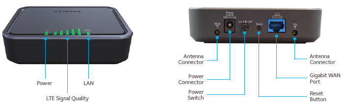

This is the NetGear Modem I'm using and it's on Amazon brand new for $120
NETGEAR 4G LTE Broadband Modem - Use LTE as Primary Internet Connection | Unlocked | Works with AT&T, T-Mobile, Verizon (LB1120)
Then I have a NetGear Nighthawk Router behind it for the WiFi. You can use any router of your choice.
The modem itself has no WiFi built in, just an ethernet Port, so you have to use a router behind it for WiFi as well as DHCP
I would stay away from the NetGear M1. No external antenna's means your WiFi signal will be crap.

Yeah, that's not the device we're talking about. Similar, but different. The LB1120, as you mention, can't be used as a wifi router, though in the config we're talking about that doesn't matter much. I think that it also only allows 2x carrier aggregation vs 4x on the Nighthawk M1/MR1100, which means it likely supports only half the throughput. This is the same reason the Mobley is roughly 1/4 the throughput of the M1 (it is no aggregation = 1x). The LB1120 might be a great option for someone wanting to double the performance of their Mobley. But for another $35 I think the M1 was definitely a better choice for me.
As for your antenna comment, I assume you're talking about cell signal, not wifi? The lack of antenna is a very situation-specific thing. In my case I've tried external antennas on the Mobley and on the Unite Explore that I briefly used and found zero benefit. I don't have great cell signal strength in my location (3-4 bars mostly) but I'm getting 40-50Mb/s throughput with the M1 so it ain't crappy for me. Also, your phone doesn't have external antennas... is its signal 'crappy' too? To each their own.
ETA: When I wrote the above I thought you were the same person stating that the M1 was available for $120 and was claiming yours was that. I see now it is two diff people with different intents, but the above info is still valid so I'll leave it.
