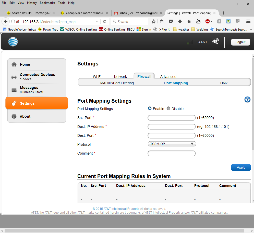

Port forwarding page on Mobley
   / Cheap $20 a month Stand Alone Unlimited Rural Internet through AT&T Wireless #977
I have ar300 router attached as a modem to the mobley. I cant see my wan ip on the mobley, but when i go into my routers wan setup ( which is assigned a mobley LAN IP) it also shows a GW IP as 10.64.x.x , which indicates the mobley WAN is NAT'd.
