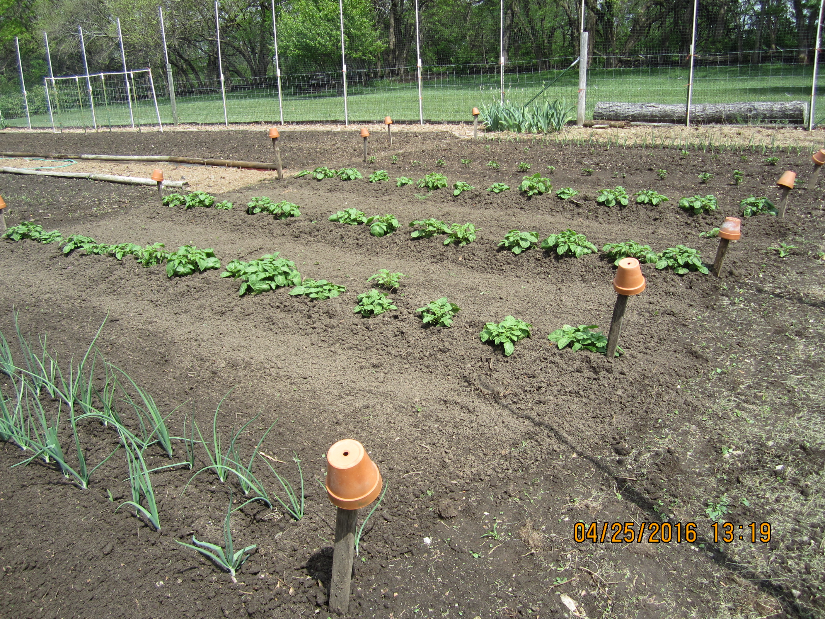

Here is how I handled the deer problem. Field Fence and barbed wire up 8' high!
