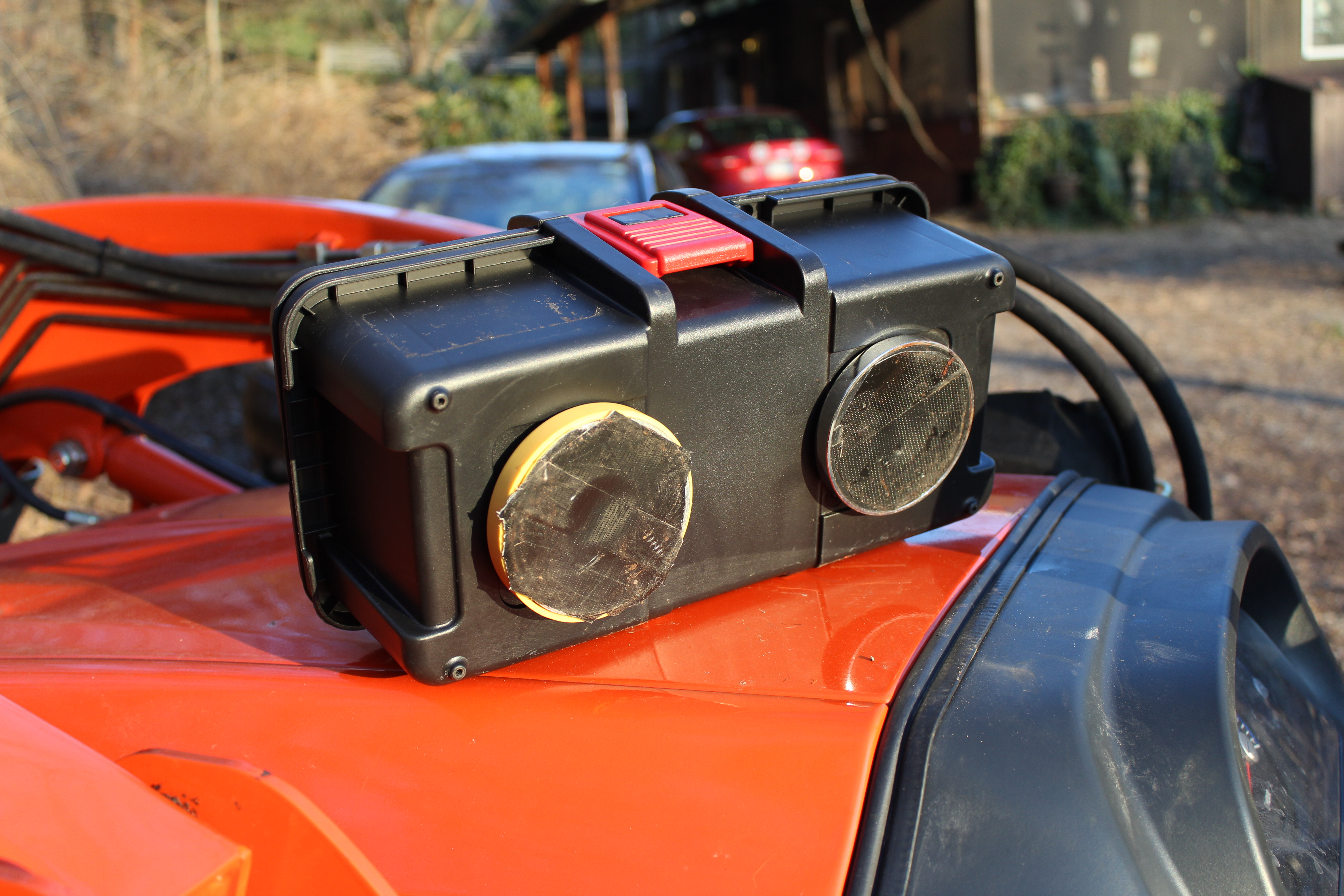

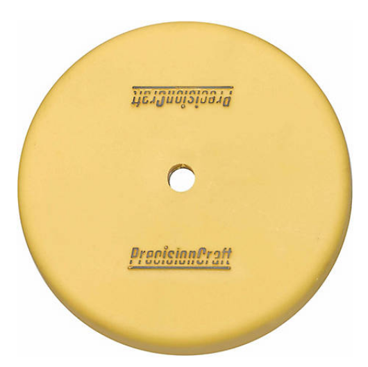

I wanted a quick and easy tool box to keep me until I could afford a better one. I got 2 round magnet bases (from TS for $7 each)
I bolted them to the bottom of a plastic tool box.

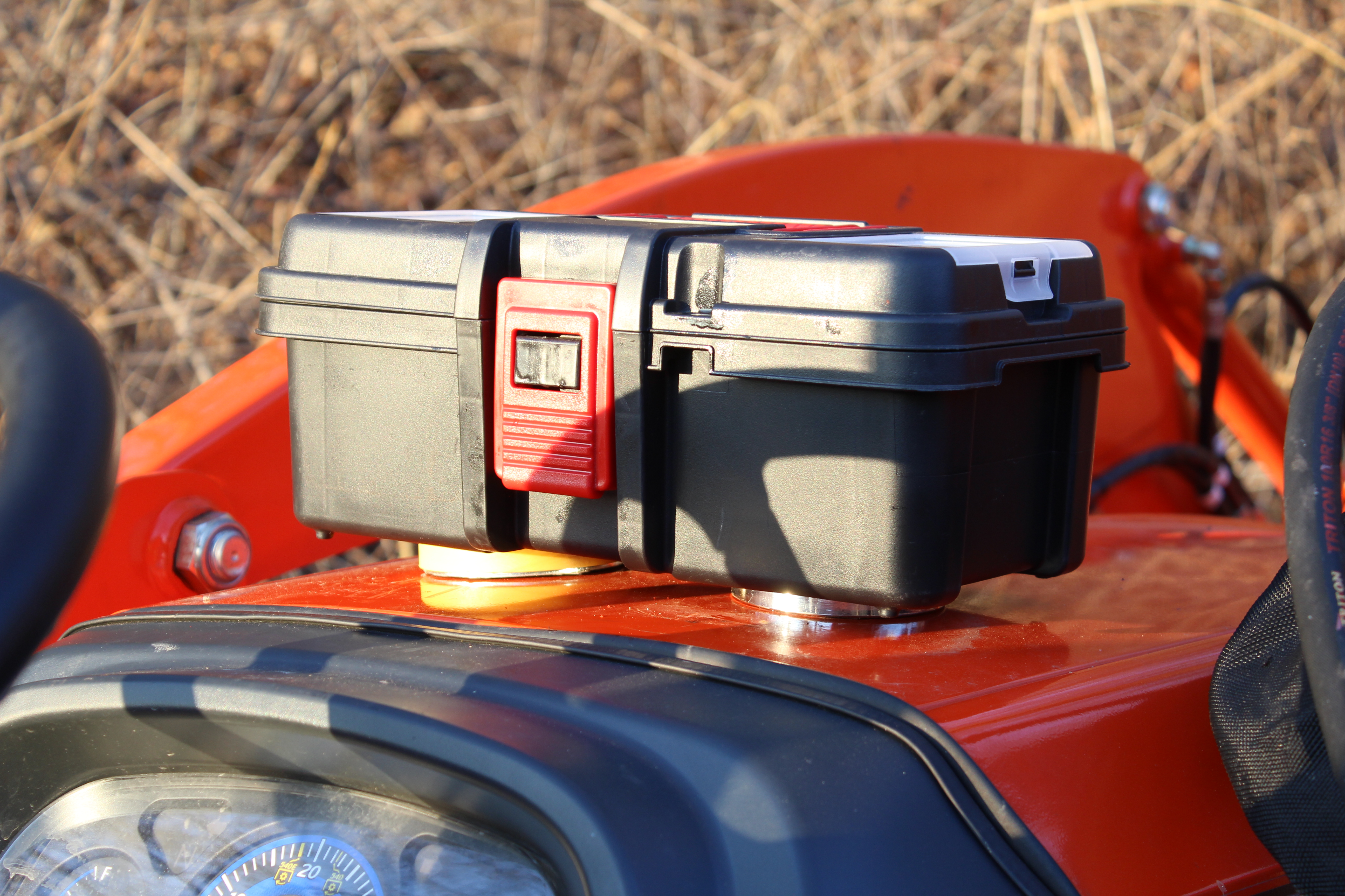

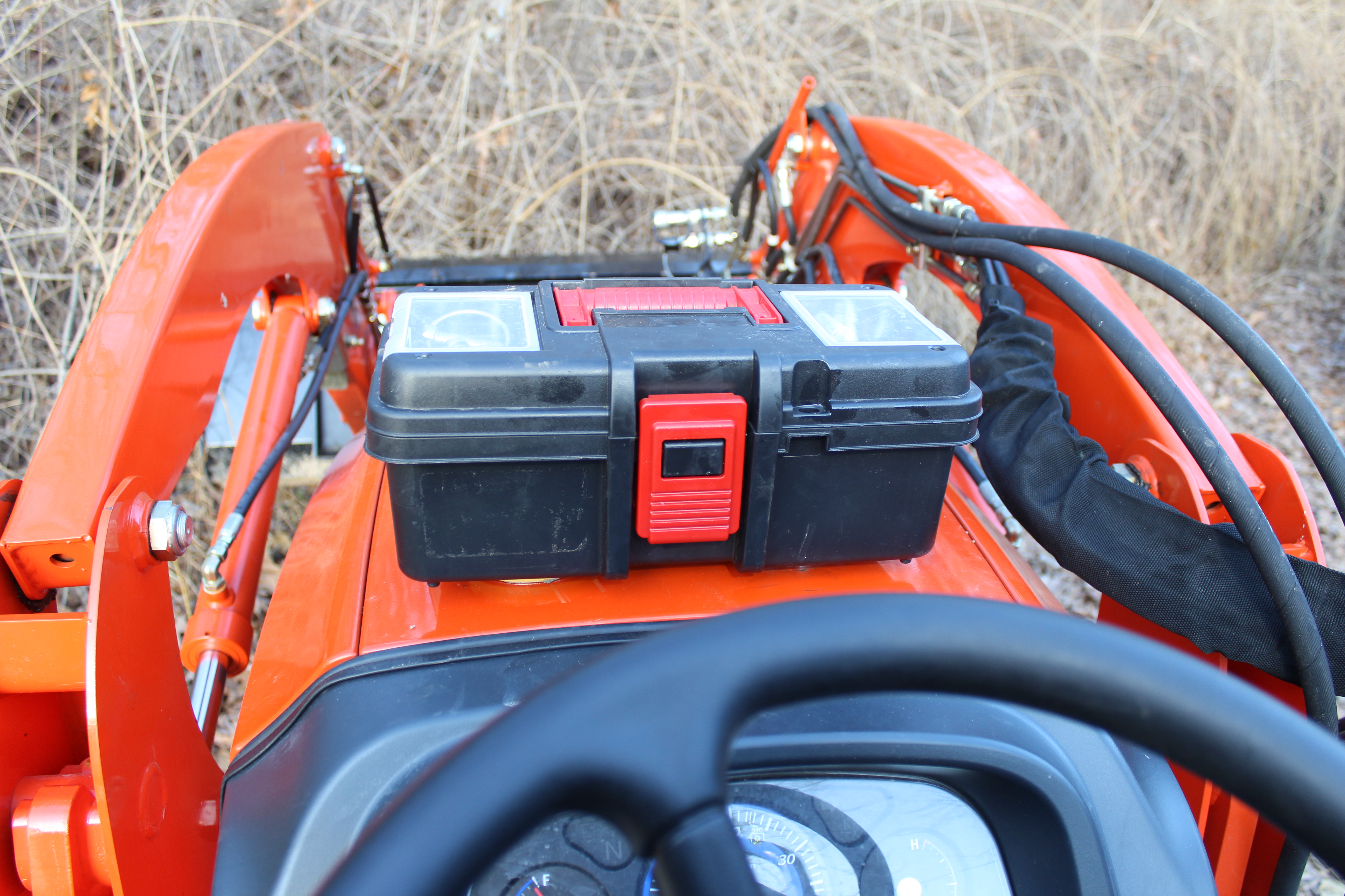

It works so well I am not getting any other. Holds well on the hood and is small enough that it does not block line of sight.

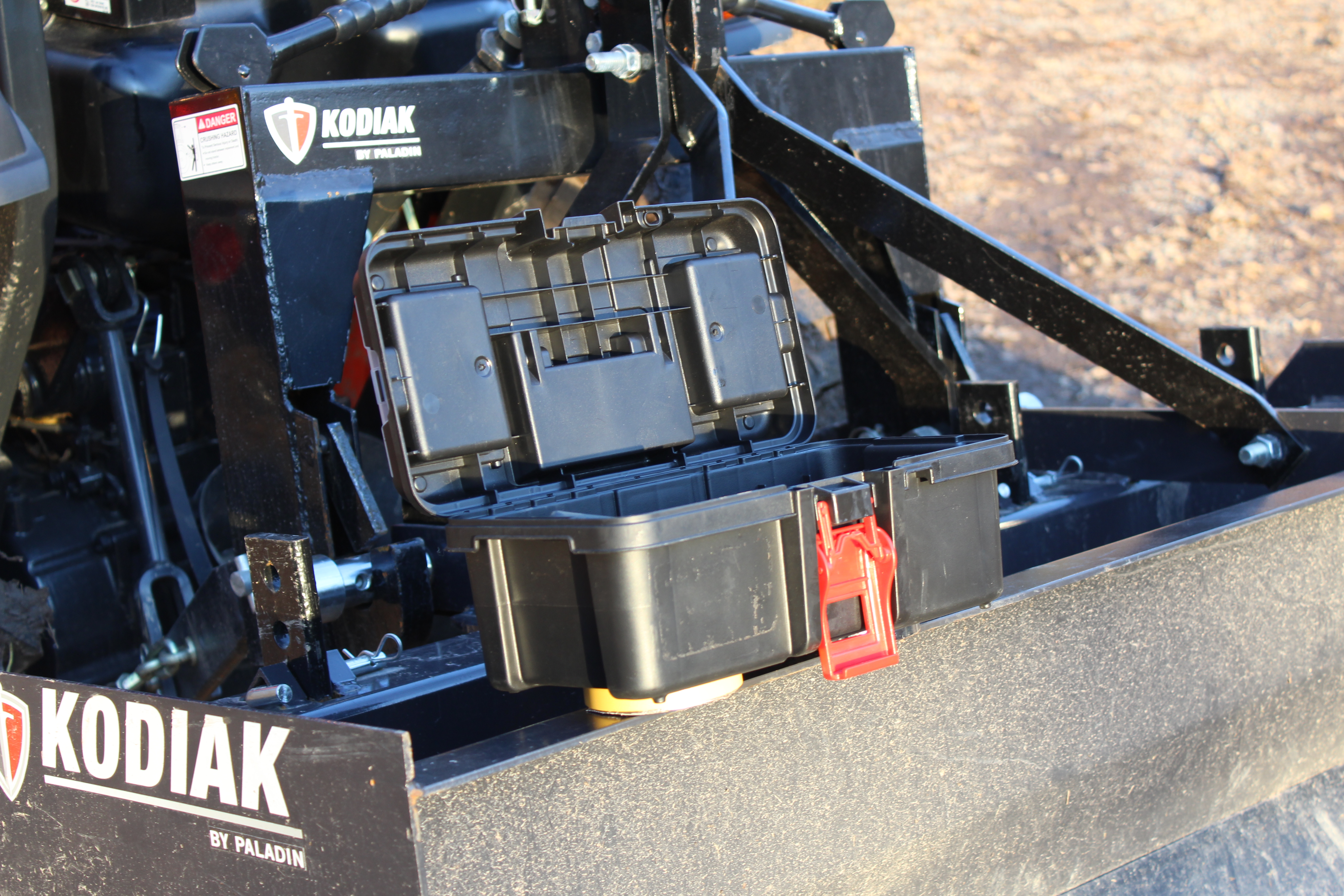

Plus it is portable. If I m working on the back of the tractor I can slap the box onto any handy metal surface like the BB.
The only drawback is small compartments in the lid get wet in the rain, but the main compartment does not.

Use Fender washers inside the tool box. The bolts will hold better.
I also put duct tape on the magnet bottoms to prevent possible scratching the paint.
