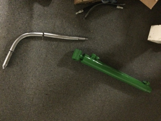

I don’t mind back dragging at all…it’s good for business😉
this one was bent in two directions, and even needed some gland work too.

I believe a cylinder with larger diameter cylinder rod will be available in the near future. With that being said that stump bucket really shouldn't be on that loader. There is way too much leverage - if the bucket is at a steep angle and you are driving forward (and you will be if you are trying to pry out stumps) something is going to get stressed - in this case the cylinder rods.
   / Cheap FEL cylinders keep bending #199
Not OP, but this is my tractor. MASSEY IS AWARE OF THE ISSUE AND IS FIXING IT UNDER WARRANTY along with the joystick that has done nothing but leak or jam. Needless to say I'm over this tractor, but at this point just giving the dealer and manufacturer a chance to make it right before taking further steps. It's been over a week since my last contact, which included a request for details on exactly what is being done, but so far no response.
As some have pointed out it's likely missing the linkage and they will be putting larger diameter cylinders on it. Yes, the cylinders are bent in the video as I wasn't just recording myself working. I simply recorded this video to show the exact motion and position I was in when the bent. This is the 2nd set of cylinders to bend. I watched them bend the 2nd time, exactly in the fashion the video shows. I was curling the bucket downward and at about 2/3 extension they just popped. Tractor was not moving and I did not lift the wheels off of the ground. Cylinders were perfectly straight up to that point as I was watching them like a dog after all of the hell I went through after the 1st set bent. After they kinked this time I jumped off, said a few very inappropriate things, and then got back on it and recorded the video.
Dealer did tell me to get a stump bucket, so that is certainly helping my case. We have a small bobcat in the family so I will only be using it on that going forward to prevent this from happening again.
This is not my first MF tractor and boy do I miss my 451. We beat the ever living crap out of that thing and it always asked for more. It unfortunately was severely damaged when I stupidly left the high/low shifter in neutral after starting it just to lift the bucket off of the ground to keep some logs from rolling out of the bucket. It was parked on the crest of my driveway and rolled backwards about 20 feet hitting a tree and it essentially split in half at the transmission. Dealer fixed it, but there was some contention on the amount of $$ spent on repairs so we worked out a halfway decent deal and traded it for this 2750e.
