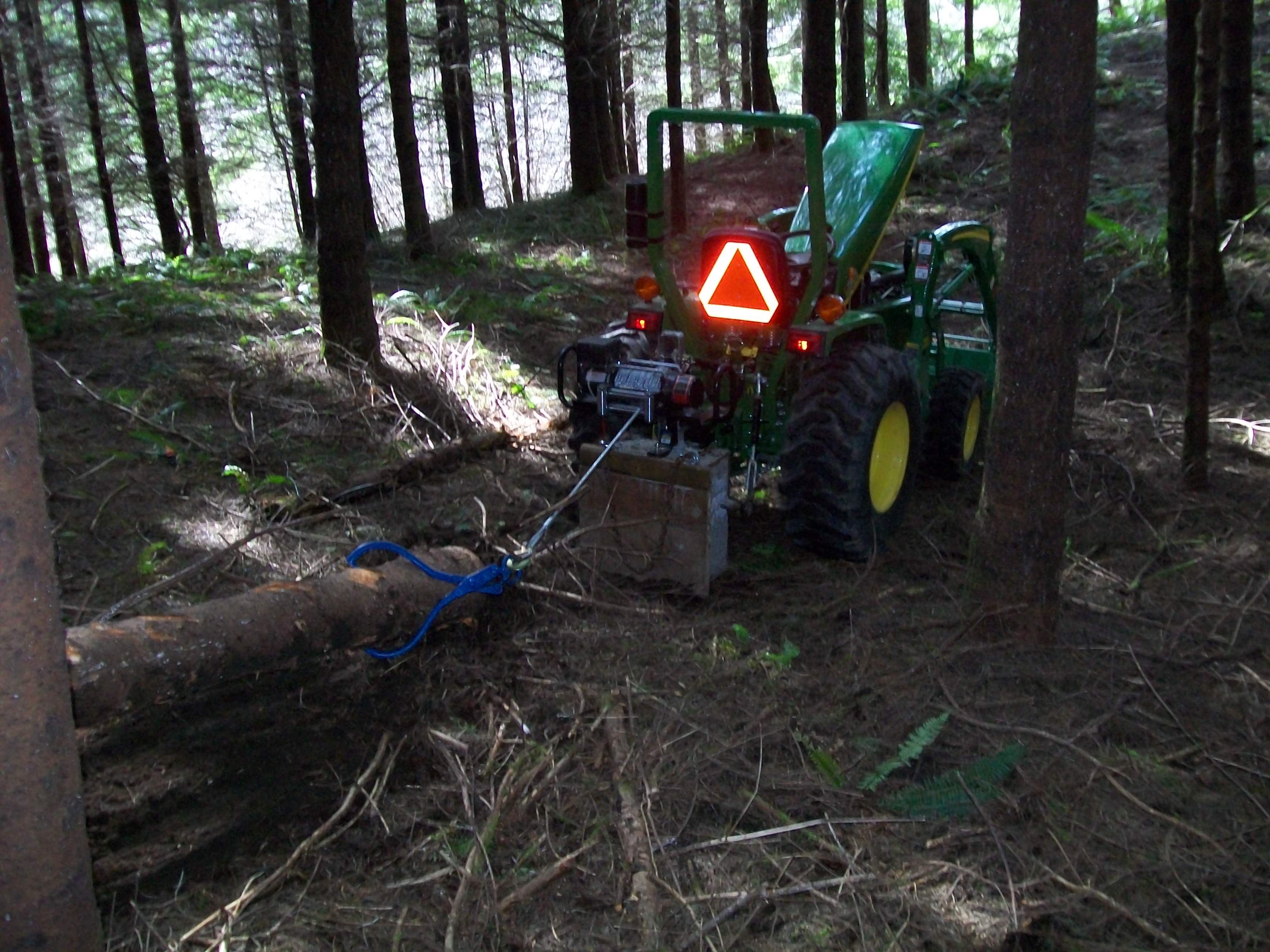

So Mud,
Even though you're pulling high above the rear axle, that counterweight is keeping you from flipping back, is that right?
How much does your winch setup weigh? I've got a small Kubota as well. I'm wondering how I can do this in a similar manner without hurting myself. The remote switch must make it safer.
Thanks for posting so many detailed pics.
The small winch which (3000 lbs) that i am now using on the B7100 Kubota on top of a 300 pound ballast block with the 2 inch receiver mount weighs about 50 pounds (I can lift it).The 9000 lb pull winch i am using on the the John Deere 3005 on top of a 450 ballast block weighs about 80 pounds (I can barelyt lift it). I doubt i will ever pull much more than two tons with the JD. I brake the tractor, drop the ballast block to full ground contact and drop the front loader with the bucket dug in. So far the logs have moved and the tractor hasn't.

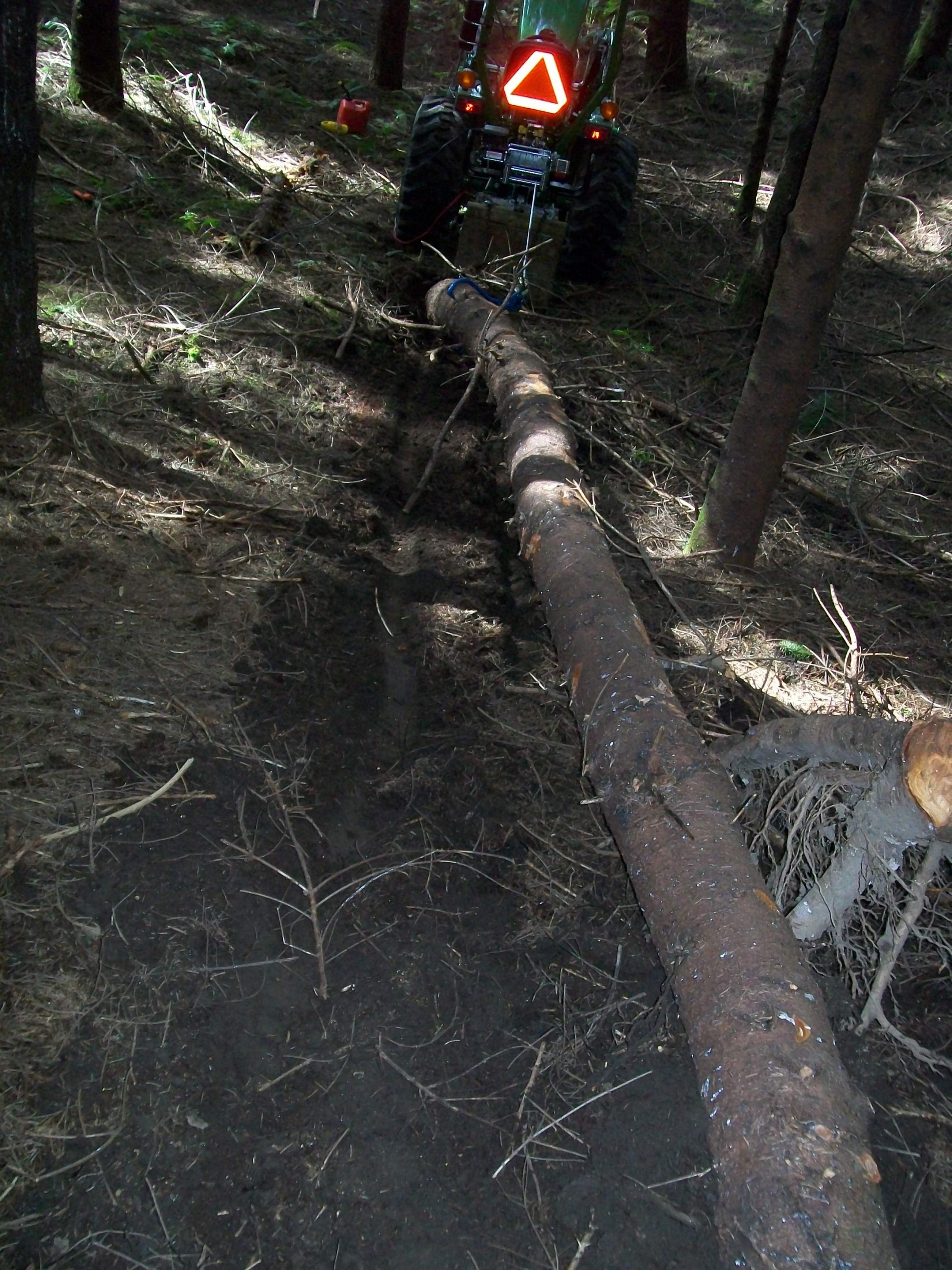

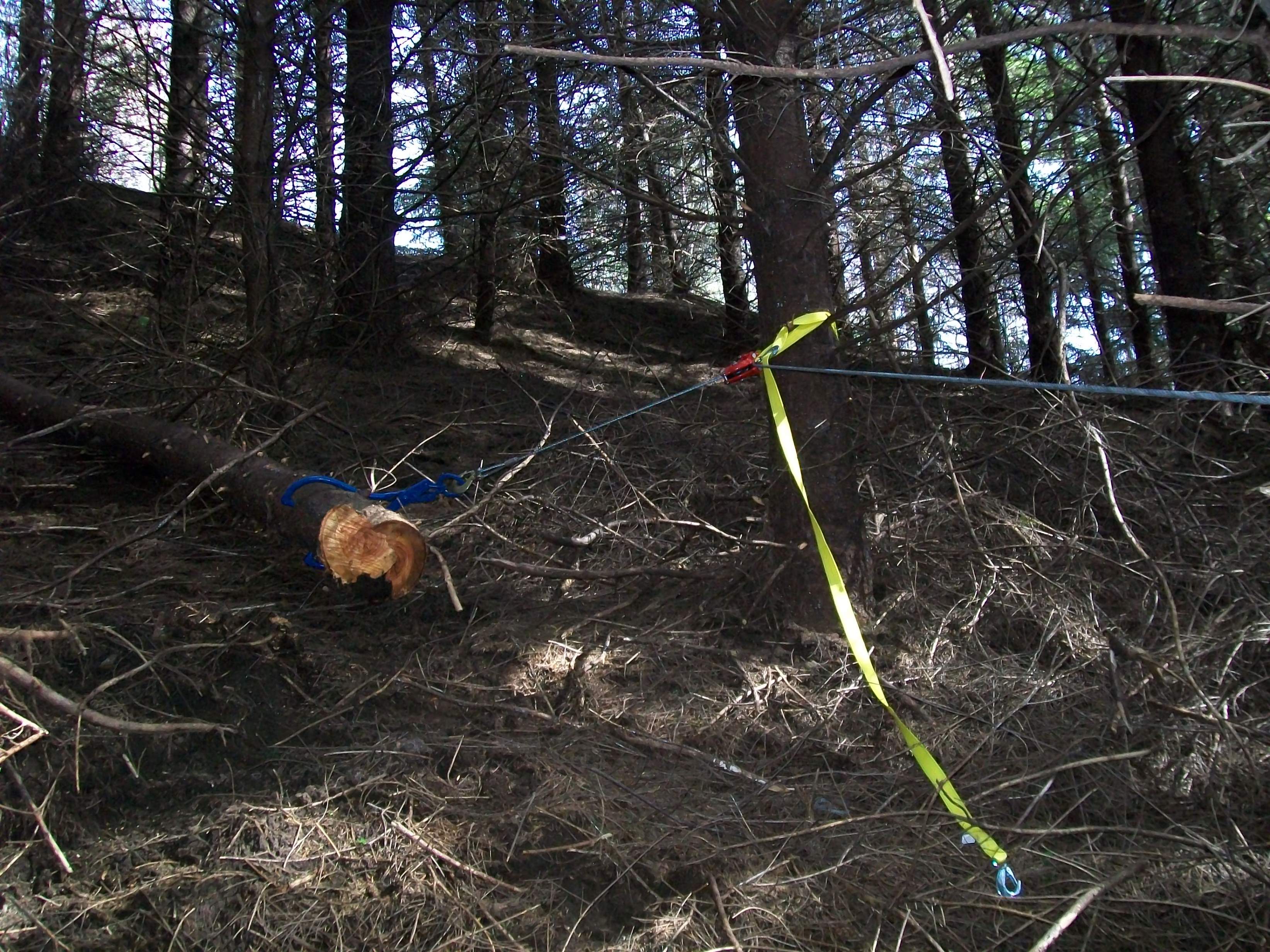

Well I tried it out today with some bigger trees. Still cleaning up from the big windstorm that knocked over about ten percent of my tree farm in 2007. Built the winch to get the trees off the hillsides. Pictures didn't turn out so well - I apologize for the flash. The winch worked very well. The tractor was solid, the winch didn't budge in its mount. All the logs yarded just fine. Two points to make. First the Harbor Freight Chicago Electric 9000 pound winch worked like a champ - a good buy for $300 on sale. Second, I was concerned that the battery wasn't powerful enough since the winch calls for a 660 CCA and my JD 3005 has a 550 CCA. No problems at all with the smaller battery. I did keep the engine running all the time. I was looking for some heat from the winch since I read about that in another post if the winch were overloaded. Stayed cool the whole time. Pictures attached.
