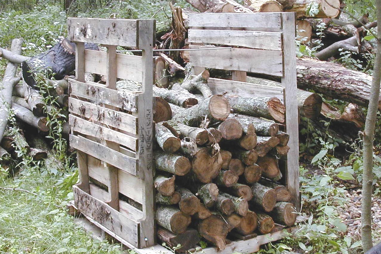

Looks good, and similar to the ones I make from three pallets. Just throw a square of used rubber roofing material over the top. Keep the sides open.
I stack all my split wood on just one pallet, but the limb wood that I don't split goes in these 3-pallet bins. I hold the two upright pallets together at the top with a 1/4" threaded rod through the center stringers. One through the bottom usually keeps it in one piece. Drop some scrap plywood down the center to keep it from racking apart when empty and being moved about.
I get about 3' x 3' = 9 sqft for a total of 18 sqft, which is 9/16 of a face cord, which is a bit more than 1/6 of a full cord. Size of pallets differ, so others may get different numbers.

I find using 5 pallets makes the structure sound. And pallets are free, while threaded rod isn't, so I'd rather "waste" pallets. Otherwise I like the idea.
But why not use them for split wood too?

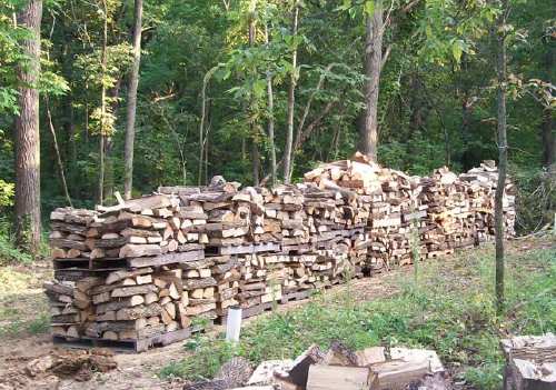

Don't need the extra pallets for split wood, and just the two standing pallets are in my way for loading and unloading wood. To heat my home I go through about 24 to 30 pallets of wood a year. I let it dry for 2-3 years before burning.

ah, gotcha. And lets throw something else in - you stack wood a lot prettier than I do:p

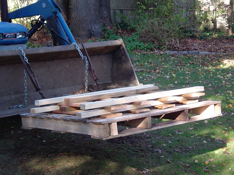

I was looking at what others on the forum were doing with firewood and did not see any racks made this way. The stone quarries use a similar setup, although it's smaller to handle large flat stone. I thought I'd modify it for firewood. Just add a couple of 2x4's to a standard pallet. Cut some slots for uprights and you're done. I figure each pallet holds a little less than 1/4 cord of wood. They come apart for storage and are mostly free.

Interesting. I'm going to argue that the all pallet method is cheaper and easier though - I thought of doing something similar, then it occurred to me, why pay and cut 2x4s when I could just use a few more free pallets?
Fundamentally, having something that can be easily moved around by the tractor is really nice though.

Beenthere -- nice, pretty stack of wood. You must have much more level ground than I do, a stack would never remain stacked while being moved on the ground I have here! Besides, I see the advantage of sides being that it makes stacking a lot easier :)
