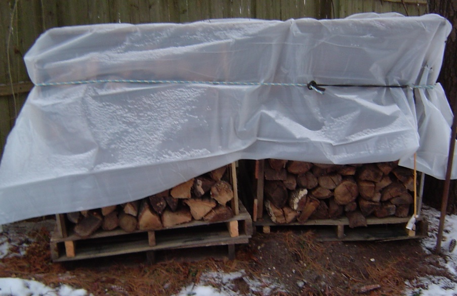

I like it!!! I think I will try the same thing but use some extra aluminum sheets I have laying around. Then trim it out. I want mine to be pretty!
   / Cheap, quick, Firewood Storage and Transport
#62
I won't call mine pretty, but its working well. Snowing right now, and the pallet/shed is nice and dry, right by the front walk. Dont underestimate the plastic part - poly is cheap. No need to store the pallets under cover if they are covered.

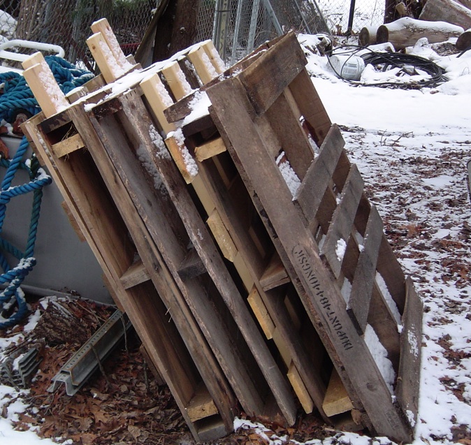

[QUOTE=I've been thinking about a new approach to seasoning/storing firewood, and this "pallet cube" idea has me intrigued.
I've been using the cubes for two years now and they're great!!
As I split the wood I stack it in a cube then use the tractor with forks to move it where it will sit for two years. I put a sacrificial pallet under it on the dirt.
I'm planning on reusing these for many years just have to keep them dry.
When empty I can take them apart and stack many of them in a pile that's only five foot high. In the spring I'm going to try bending up some rebar into a U shape to use for the sides with one strand of removable wire across the top. This should make things simpler to make. One 8 foot piece of rebar for each side. 40" high and 16"wide at top
After I load the cube. I use 1 strand of straightened plastic coated chainlink wire across the top to stop the side from spreading. I didn't do this when I first used them but the weight and leverage makes the top of the sides spread several inches.
I let my wood (oak) sit for 2 years before using
Here's some more pics.
Mike

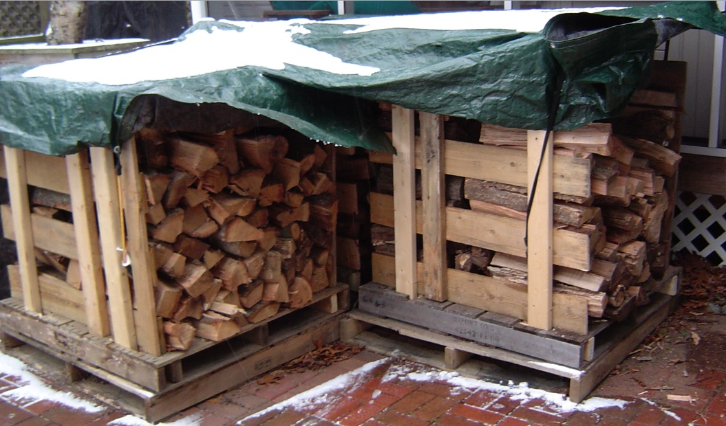

   / Cheap, quick, Firewood Storage and Transport #65
I like the foldable approach. I put my cages right back from being empty to getting filled. It is a year round process. Being wood to the ground, even with the sacrificial pallet, any issues with bugs/termites, etc finding thier way from ground to firewood? I am switching all my wood pallets to heavy plastic ones I have found.
   / Cheap, quick, Firewood Storage and Transport #66
Go to www.msc.com and search this item #: 65359010 It is for a 1000 ft X 20" stretcg pallet wrap roll ($32) one roll will last you a long time. If I fill a pallet 4' high without the cages (see my other post, above) and then give the pile a few wraps of this, I can drive out of the woods on the rough path and the wood sits still, yet air can get through to dry wood. Place a 4X4 tarp over the top of this pallet, secure it with a couple of wraps of this plastic, and walla- nice dry wood till next season.;)

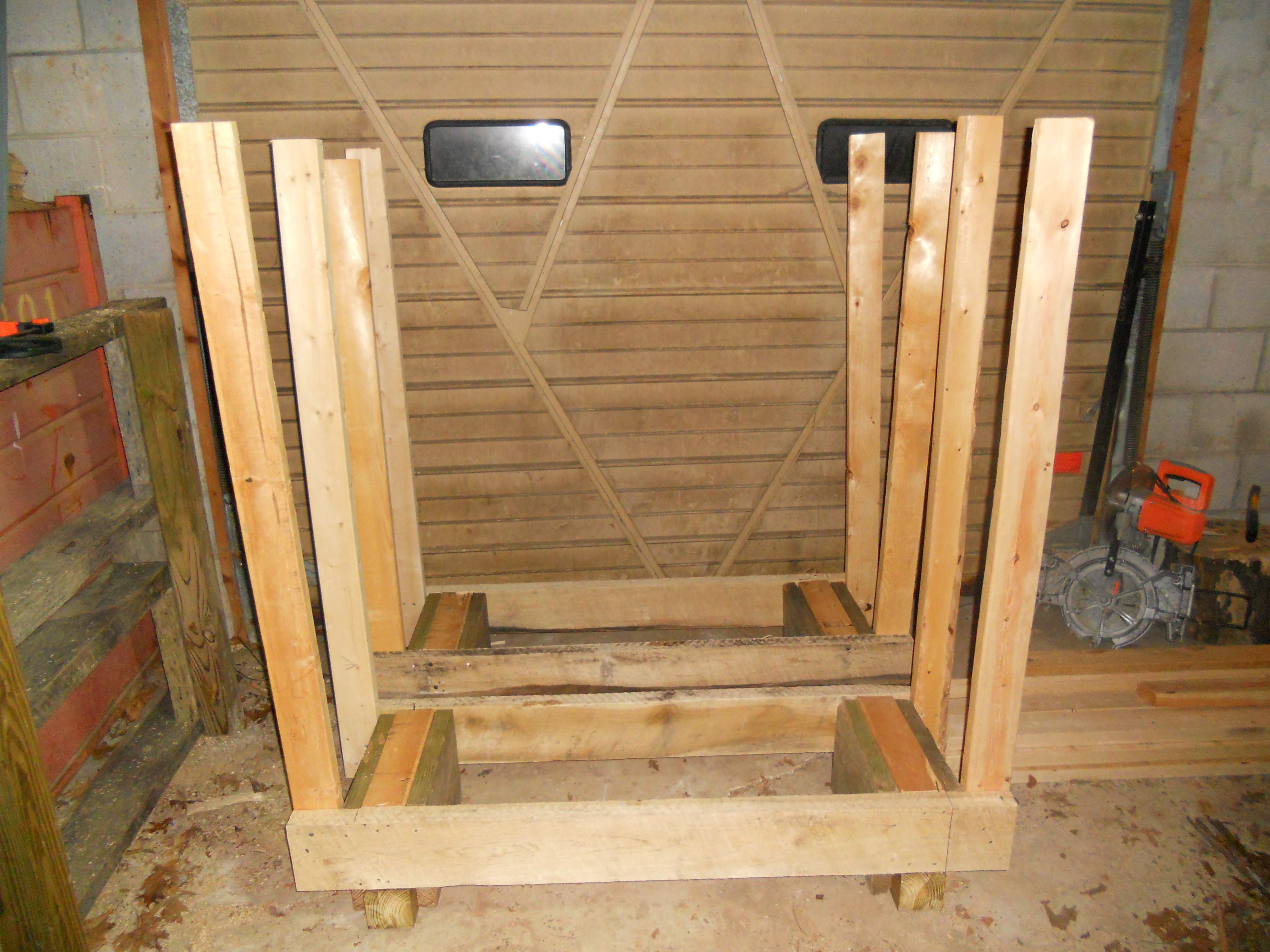

   / Cheap, quick, Firewood Storage and Transport #67
44 x 54

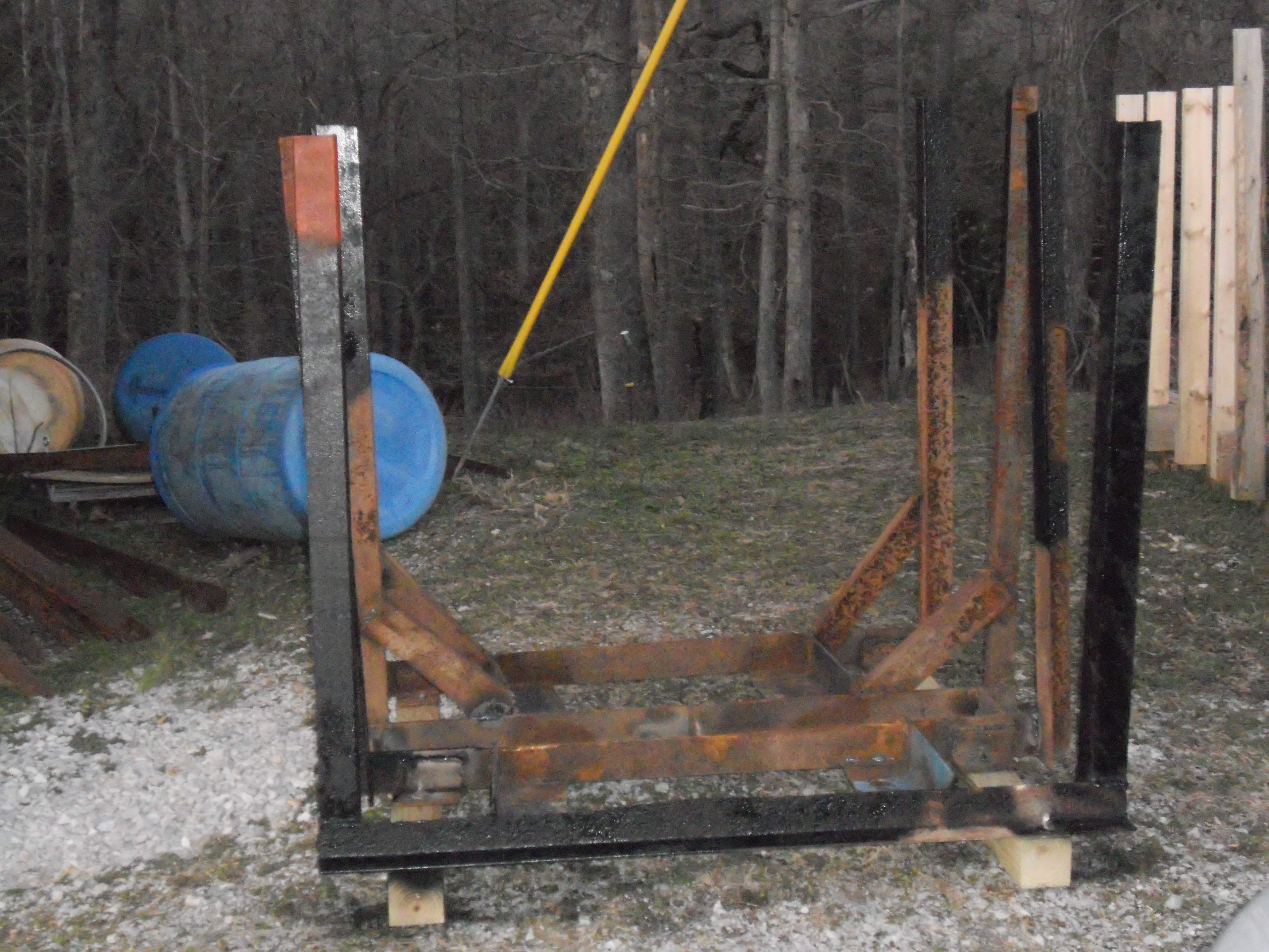

got a welder so i did a update. same size but the uprights should hold up better.
