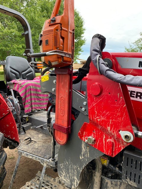

Here is my version of a homemade chainsaw scabbard, one for each side, I like to have an extra saw with me. The saws are both Husqvarna 61.

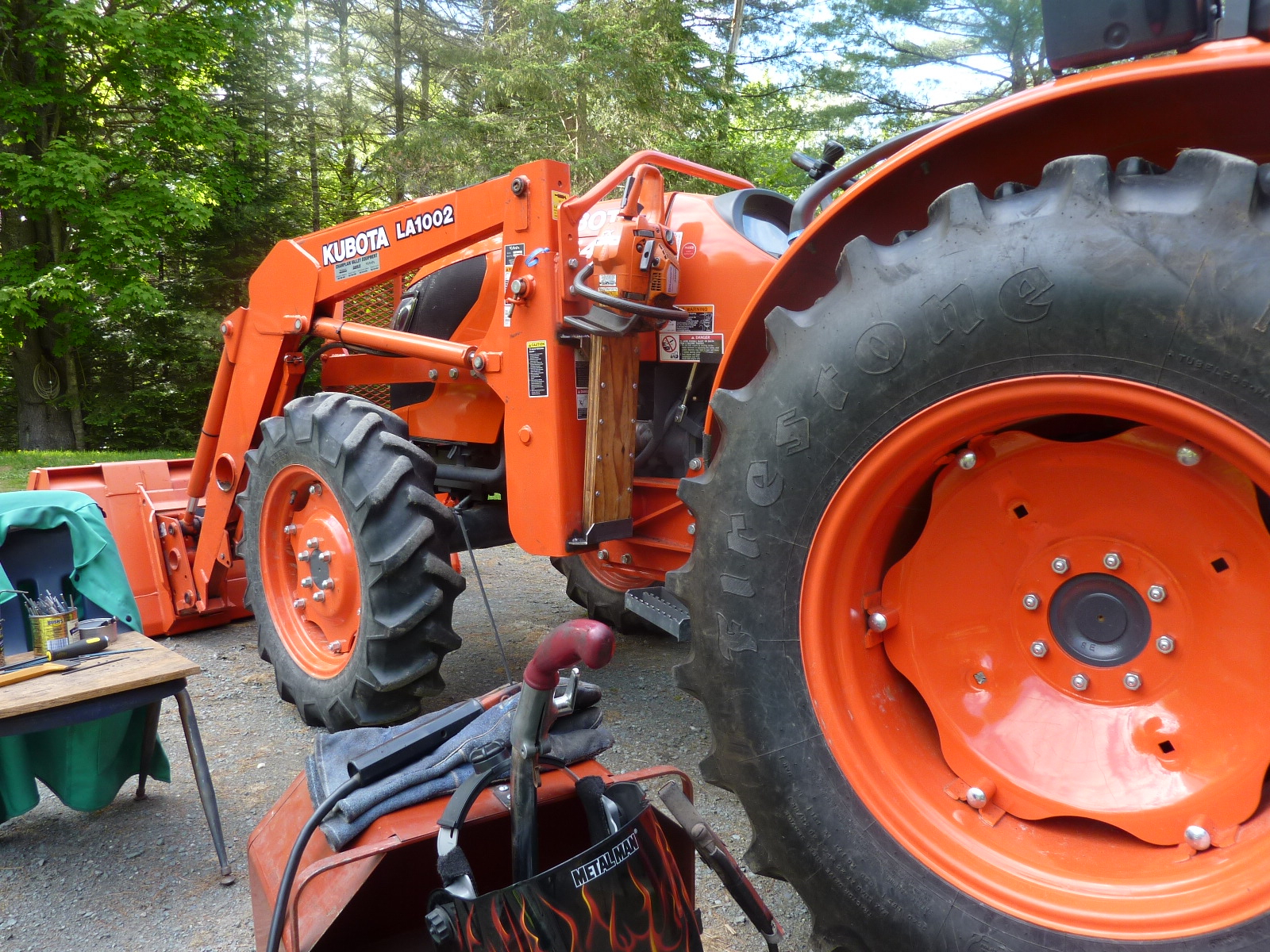

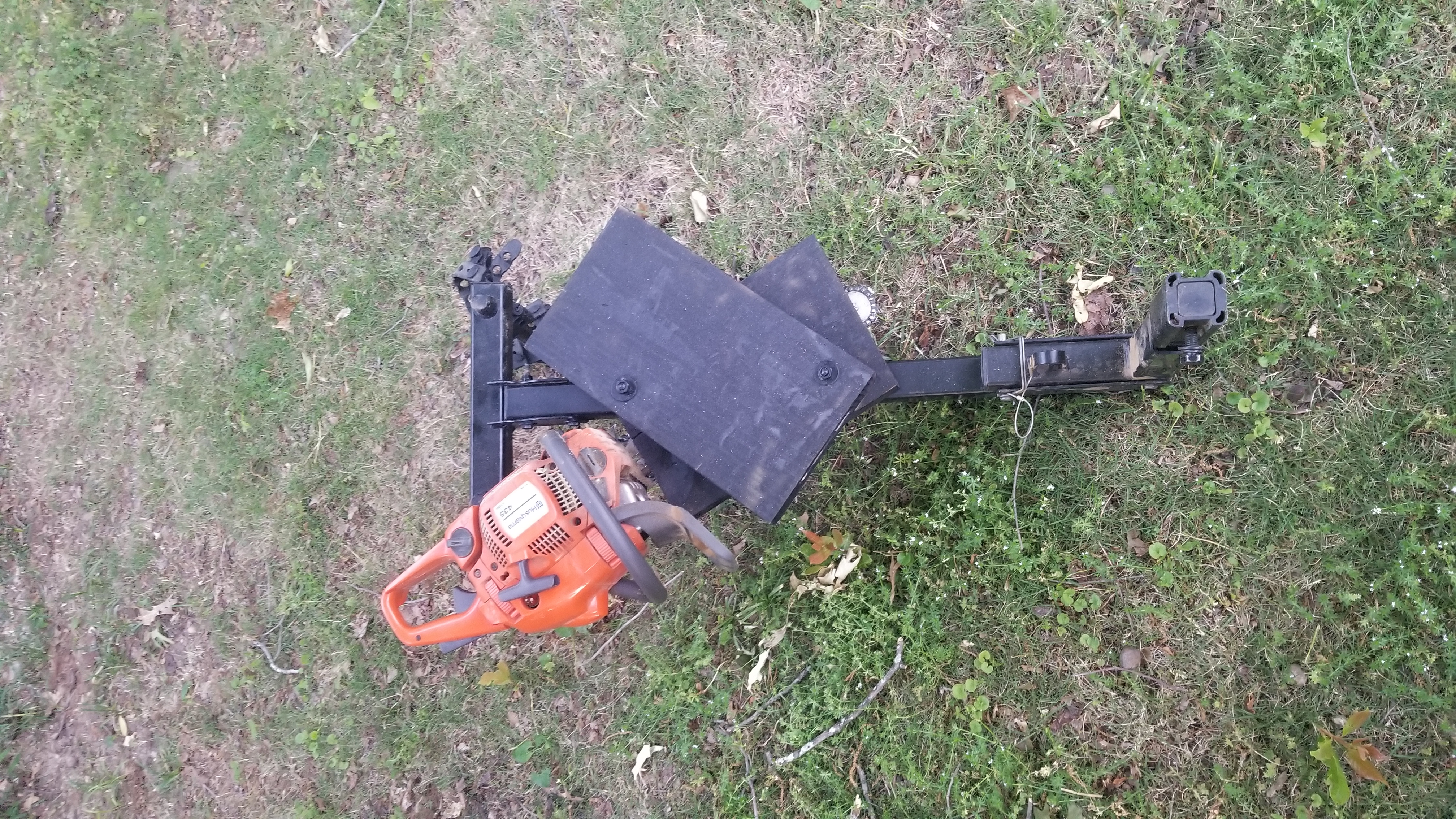

... I bolt on a piece of pressure treated lumber that I've made a bore cut into with whatever chainsaw I will be carrying. These two are affixed to my rack and they hold my ms441 and my little husky simultaneously. I paint the lumber black so as to look better, and this is a solution that can be bolted onto four wheelers cars trucks etc. The lumber is really cheap in comparison to scabbards, and I make the bore cuts safely by clamping the wood in a vertical position onto something sturdy so I can plunge into the lumber and keep the cut aligned.
I did the same for my first holder. I bore cut into plain 2x6. I did not use pressure treated, since most of that stuff is corrosive. (Though I suppose the chainsaw is not in there long enough to be a real issue.) It lasted for a couple of years before the board split. clamping it to one of the bars on my brush hog probably did not help it's longevity.
I think my next holster will be made out of some used plastic cutting boards: I'll cut two holster shaped side, and use smaller pieces as spacers along the edge. Just waiting for garage sale season to start up, so I can pick up the cutting boards cheaply.
I'm still debating about the best place to mount it. Hnging it off the outside of the FEL upright concerns me, since I often work in tight quarters in the woods and on uneven terrain. I'm afraid it will only be a matter of time until I smash my saw against something.
I will probably put something on my logging winch, but I still need a place for when the winch is not on the tractor.

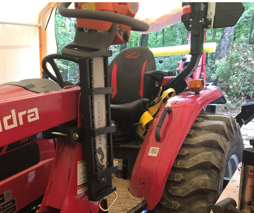

It took $3.00 in bolts to make this and used plywood.
I need it to last 3 months and I have more scrap wood. This was an awesome idea.

So I've seen no shortage of high dollar expensive chainsaw scabbards. Here is my solution. I use my bike rack that fits into a 2" receiver, which also doubles as my weed wacker holder when I'm driving around or in my tractor, and I bolt on a piece of pressure treated lumber that I've made a bore cut into with whatever chainsaw I will be carrying. These two are affixed to my rack and they hold my ms441 and my little husky simultaneously. I paint the lumber black so as to look better, and this is a solution that can be bolted onto four wheelers cars trucks etc. The lumber is really cheap in comparison to scabbards, and I make the bore cuts safely by clamping the wood in a vertical position onto something sturdy so I can plunge into the lumber and keep the cut aligned.

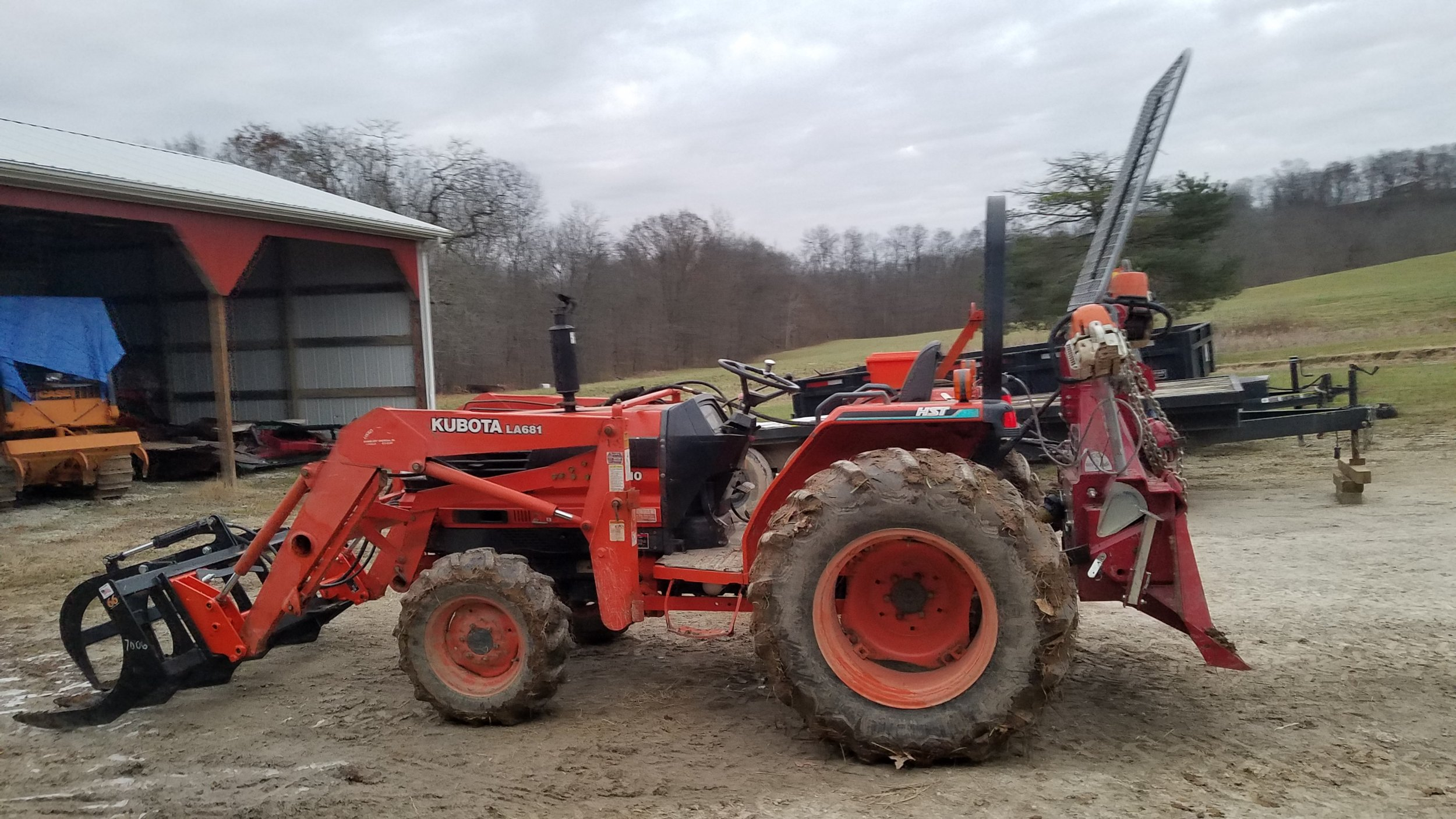

I welded a piece of 4 inch pipe to the side of the loader frame works for me
I welded a piece of 4 inch pipe to the loader frame
