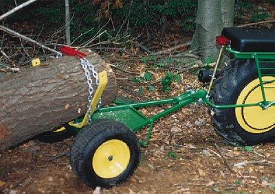

The attached pic looks very scary when you look at whats pulling the skidder. Especially if he has 1 brake....Don't know where I got the pic from...

This worked really well for me. Cheapo 3pt 2" rcvr hitch and tongs.
The picture is misleading...the JD750 is huge, it just makes the log look small.[:)]
