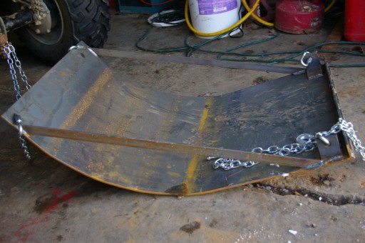

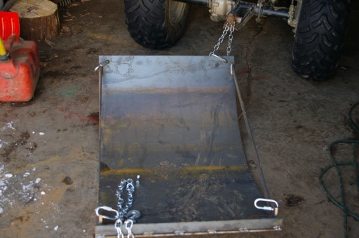

I made the log skidder to be just like the one in the attached video. I used it for 2 years now and have pulled down a lot of firewood. There are a few more vids on the website but I built mine just like the one pictured for the ATV.

Another tool to make skidding easier is a 'skid plate'. I made one from a piece of 1/8" plate, bent up about 30 degrees in front with a hole torched in the bent part, run chain through hole to log, work edge of plate under nose of log an pull, the log will _usually_ pull right up on the plate. No digging in and tends to ride up over small obstacles. A car hood from an old car might work. I don't think one of the tissue paper ones from recent cars wouild last long.
Harry K
   / Cheap way to haul logs
#26
Turnkey,
Thats what the video was about..It was similar to this one..
It was meant to be used with an ATV though....
