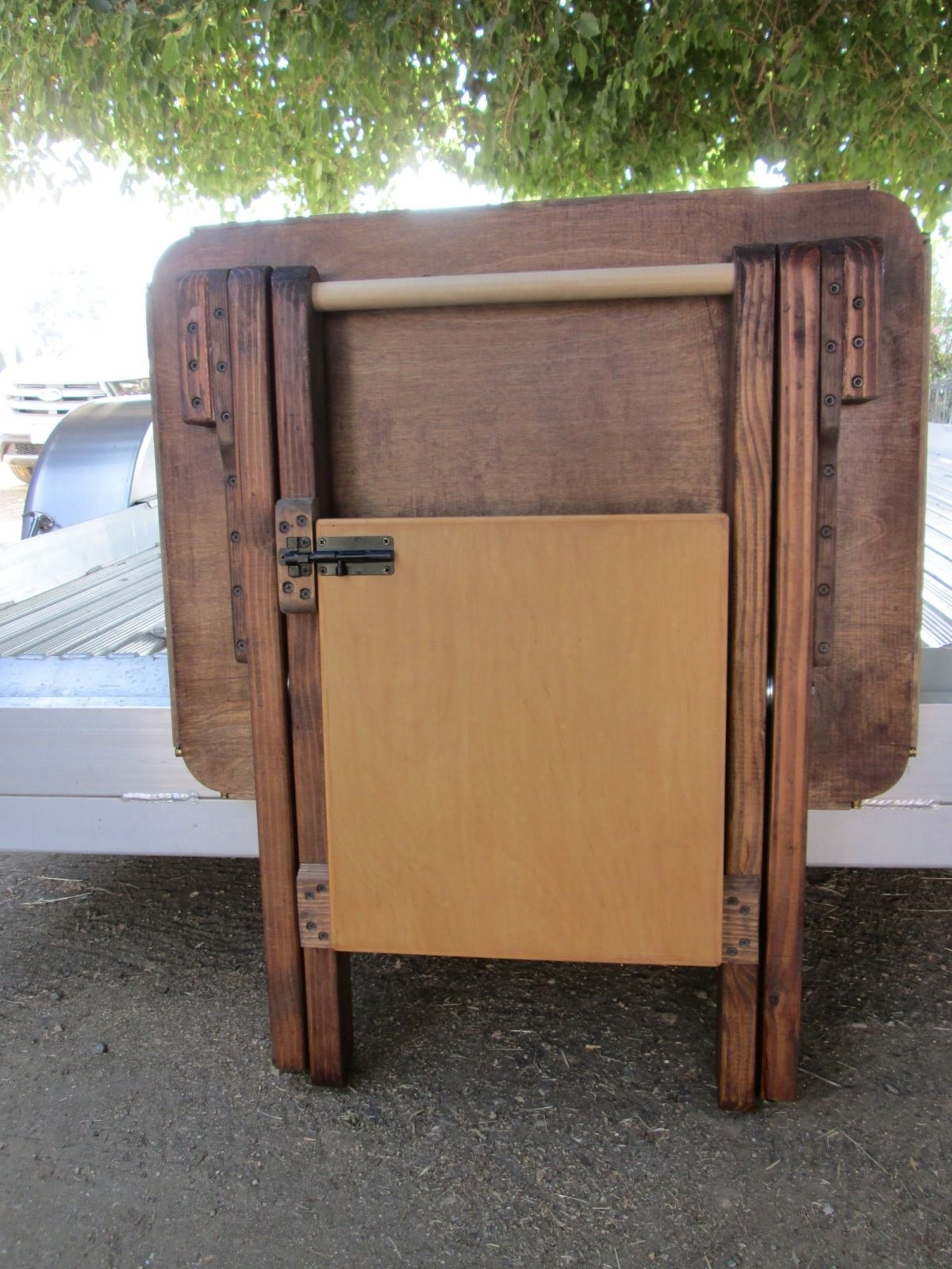

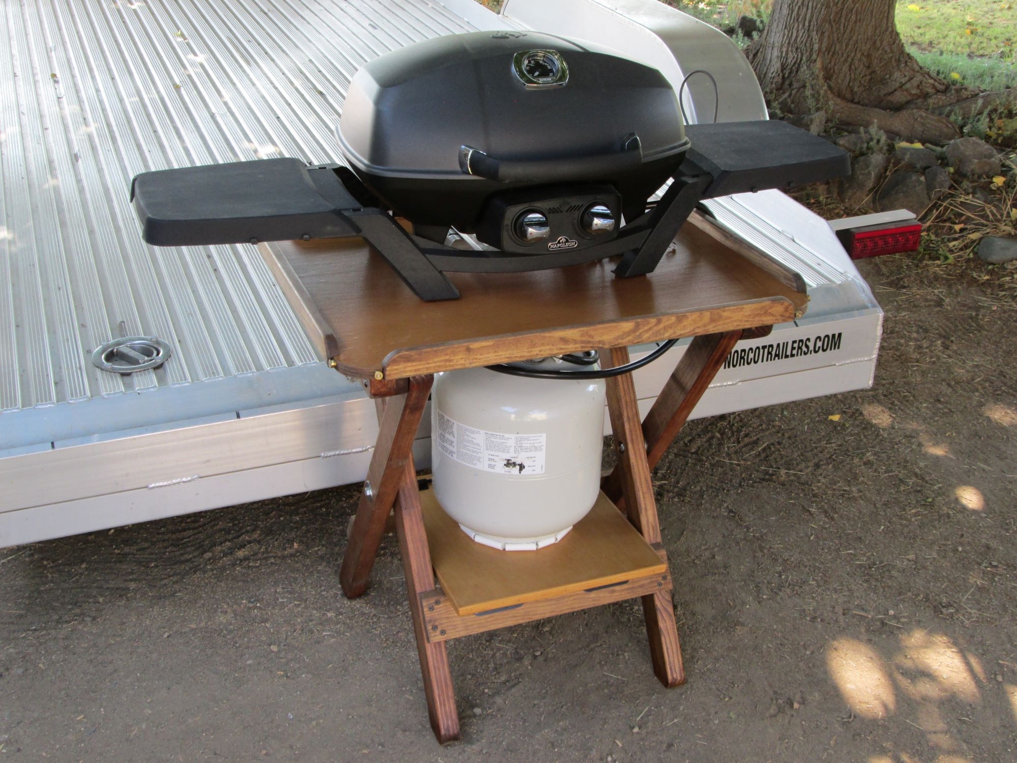

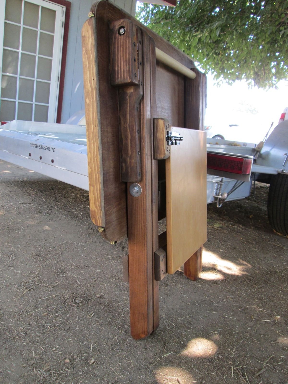

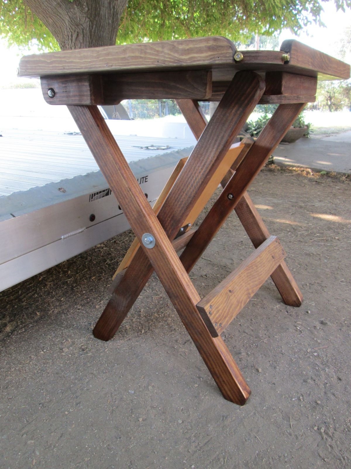

built a portable/collapsable BBQ table
/ built a portable/collapsable BBQ table #1
nickel plate
Veteran Member
Feb 25, 2009
1,124
CA
2002 New Holland TC40S
Table top: 24" deep 31" wide
Table bottom shelf: 17-1/2" deep 15-1/2" wide
Table height: 30-1/2"
2x3 legs and table top frame members, 1x4 cross bracing, 3/4" plywood, 1-1/8" dowel, table top edging is 1x4 ripped in half and rabbeted to fit the 3/4" ply top.
I looked around at the various tube metal framed commercial offerings ($100/$200) but needed a woodworking project so I built my own.
Both table top and lower propane shelf are brushed with several layers of "slurry" coated water diluted "Titebond" waterproof glue purchased from Lowe's.

/ built a portable/collapsable BBQ table #2
Nice!
I like your grill too.
It's just the 2 of us, so we don't need 500 sf cooking surface.
/ built a portable/collapsable BBQ table #3
I agree on set up and grill. We barely use 1/4 of our grill, but it's a SS Weber, it'll last forever. After 8 years, 6 of heavy use, it still looks brand new... when I clean her up.
bigtiller,
The BBQ is a Napoleon TravelQ Pro285 with the optional side shelf kit, they easily pop on or off but do lock tight in place when in use.
