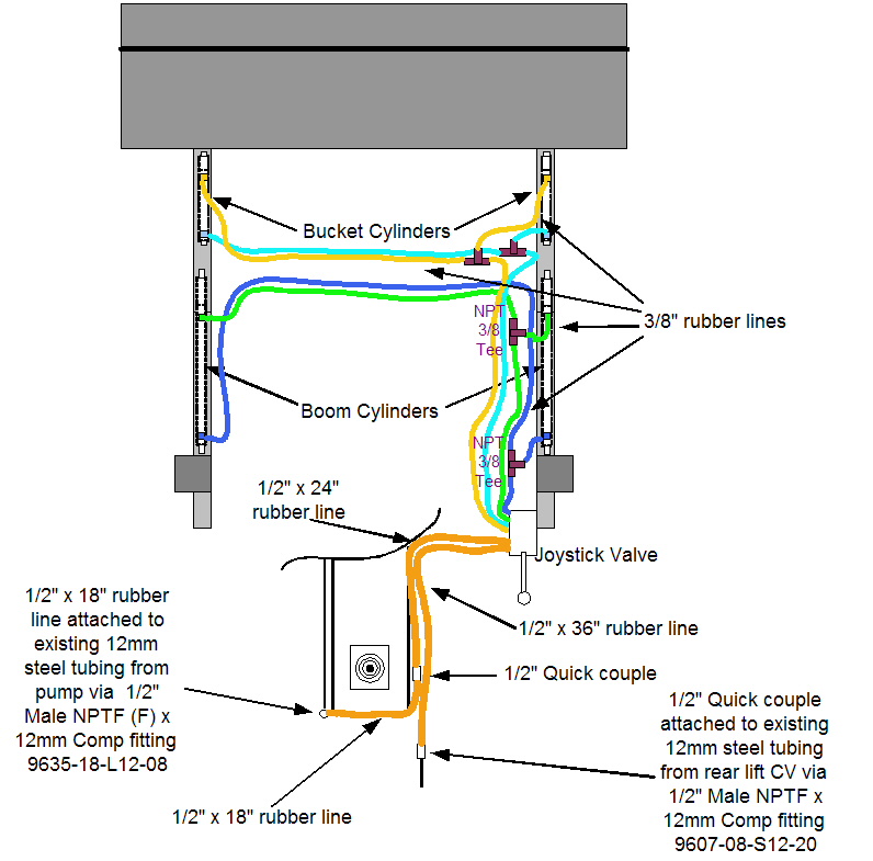

Yes I saw that. What's the GPM @ 2000 psi? I have all of the diagrams I made in AutoCAD stored on the shop computer- which I am not near at the moment. This one is converted to Jpeg. If there was enough interest here I could post the entire pictorial thread along with the CAD drawings.

<img src="http://www.tractorbynet.com/forums/files/hydraulics/434651-cheapest-place-get-1-36-a-loader-hydraulics-detail-jpg"/>

Can you make a little drawing of the loader you have in mine?
