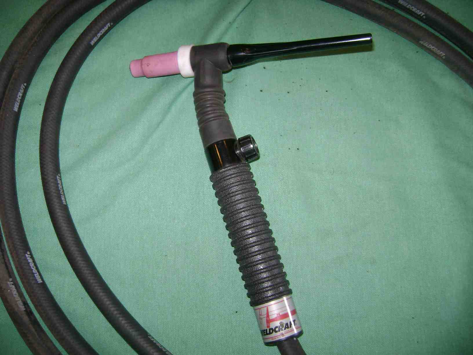

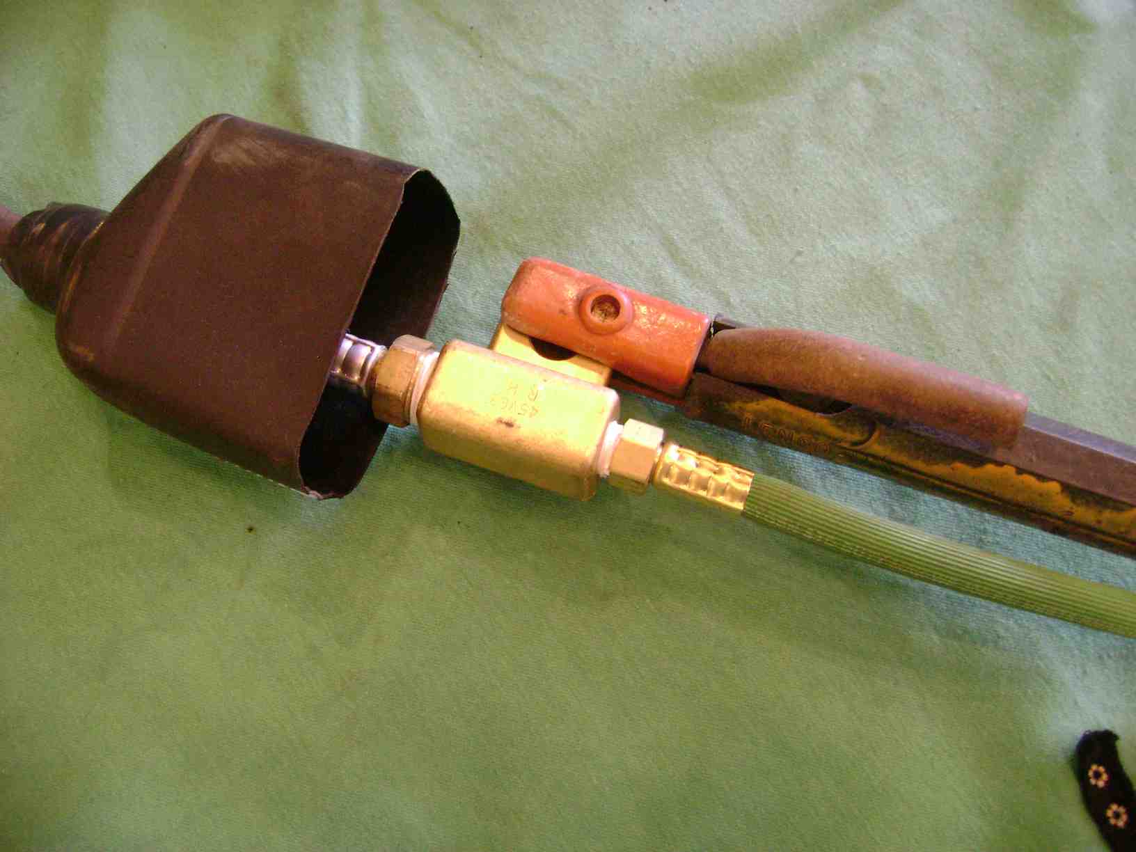

   / Cheapest way to try my hand at TIG? #2

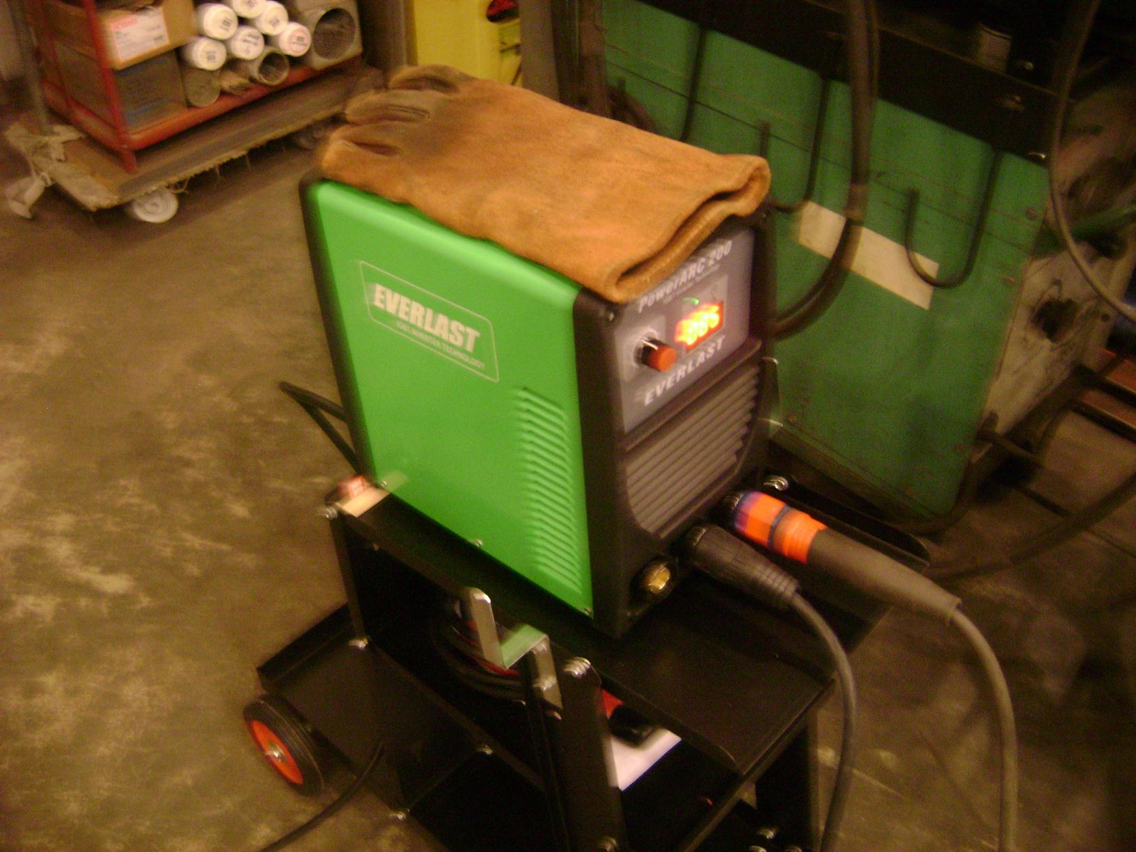

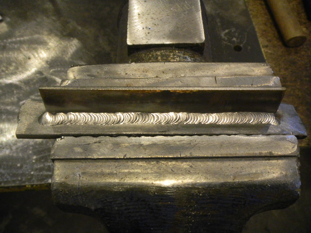

Tig does come in handy for quite a few things. In my opinion a Tig rig is well worth the money to have around. Here is a stainless steel to mild steel Tig weld I did with my Everlast PA-200 CC only stick machine.
