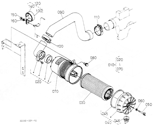

I've cleaned, changed and otherwise monkeyed with the air filter assembly, but I have yet to figure out how/where air gets into the system on my L2500.
If anybody's got an answer, you may have to talk real slo-o-o-o-w so I can follow you. /w3tcompact/icons/crazy.gif

Actually, since this discussion began I've only been able to look for it in my manuals. When I get back to the property (this weekend?) I'll pop the covers and take a firsthand look. I just don't happen to recall seeing anything that looks like an intake when I was changing the filter.
I'm curious now -- on your tractor, where is the intake relative to your air filter? Also, where does it show up in your parts manual and what do they call it?

Harv, on my B2710, the manual calls it the "inlet hose" even though it's a rigid plastic piece, round on the end that attaches to the "air cleaner assembly body" (in other words the can the filter's in/w3tcompact/icons/smile.gif), and flattened on the other end. It runs from the filter can forward just across the top of the radiator with the front end turned down, so it's sucking in air from just in front of the radiator.

What's referred to as an "inlet hose" on my 2500 goes from the filter canister to, I think, the intake manifold (see #090 in the attached diagram). The only other thing that appears to be a gateway to the outside world is a doohickey called an "evacuator valve" (#046), which, from its name and design, appears to be a blower, not a sucker (technical terminology).
Coincidentally, I finally got my Workshop Manual today, so I checked out what it says about the air cleaner system. No mention or picture of an air intake (probably 'cuz it's so obvious /w3tcompact/icons/crazy.gif).

Put you hand under the rubber nose (046), at idle you'll feel it "snorting" more blowing than sucking... Crank up the rpm's to 2500... now you have a "vacuum cleaner"... if you could "smother" the air intake, you would "shut" the engine down...
On "our" John Deere's you remove the rubber nose and dump out any trapped dirt... Ok Mr. Kubota owner? /w3tcompact/icons/smile.gif

Harv, my 4100 has both, an air intake tube just as Bird described leading out over the radiator and that rubber nose /w3tcompact/icons/cool.gif is refered to in the manual as a dust unloading valve. It supposed to be cleaned as routine maintenance every 10 hrs. Also there is an Air Restriction Indicator thats part of the system to be checked every 10 hrs or daily that when visible requires immediate servicing of both the primary and secondary air filter elements. Gee, I hope your not feeling a little green from being over here. /w3tcompact/icons/smile.gif
