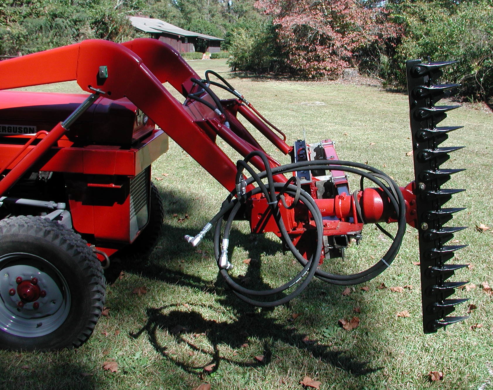

The purpose would be to keep about 3000 ft of wood trails (each) side trimmed. I can use my 36" sickle for the puny twigs but not for anything bigger than 1/2", and... sometimes those pesky twigs get stuck between knives, as you well know. This is why I thought a small side deck would be more ferocious. Sure it would cover smaller cutting areas, but in my situation it does not have to be a continuous trim.
   / Check my logic, please #27

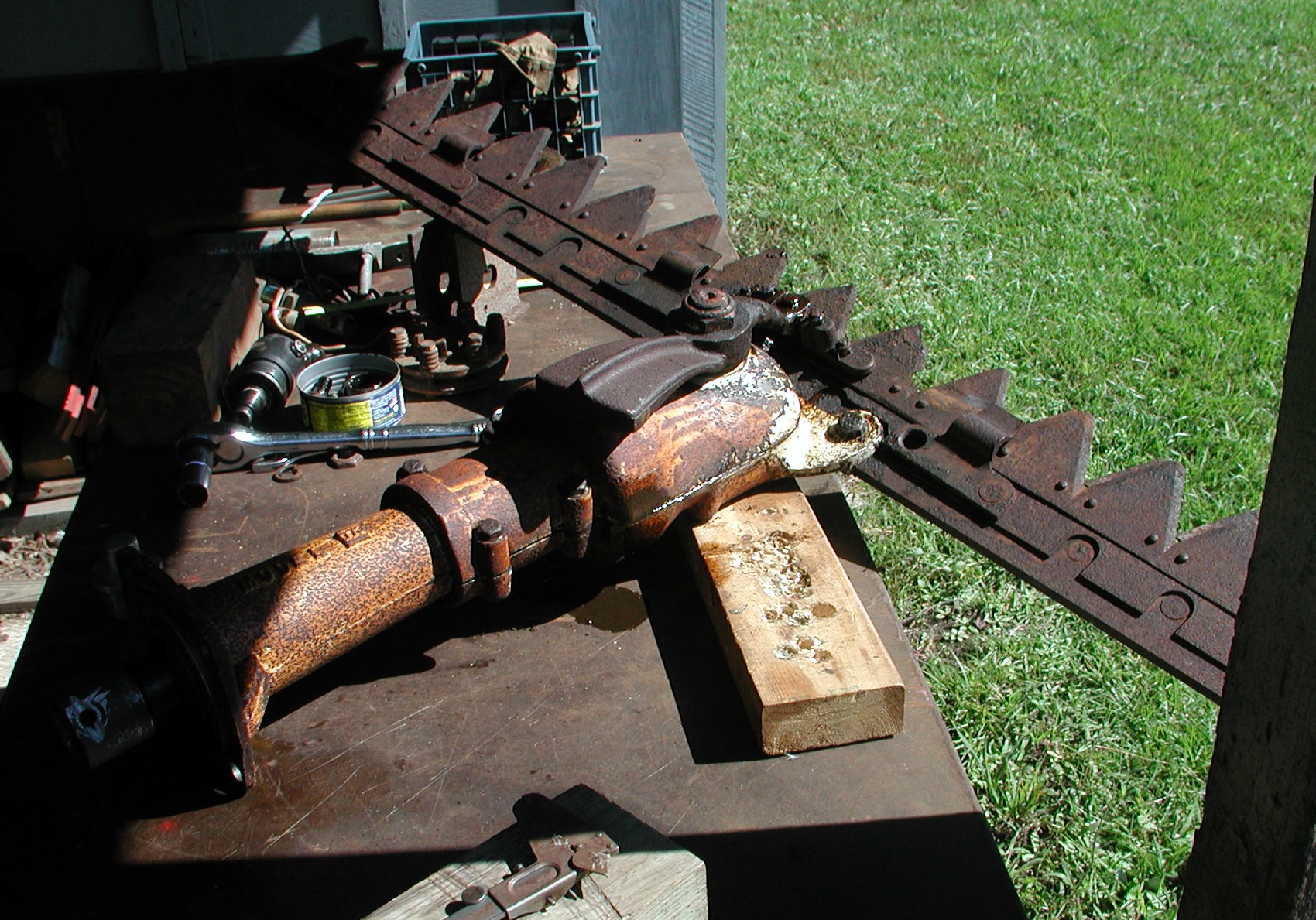

Why does your sickle only cut up to 1/2"?
Can we get a pic of it?
Mine cuts up to 1/1/2"....
#28
Here it is. It was originally a walk-behind Gravely Sickle, later modified for the tractor. Operated by the loader 7 GPM PTO pump. It seems to have the right speed.
Using motor #1.
