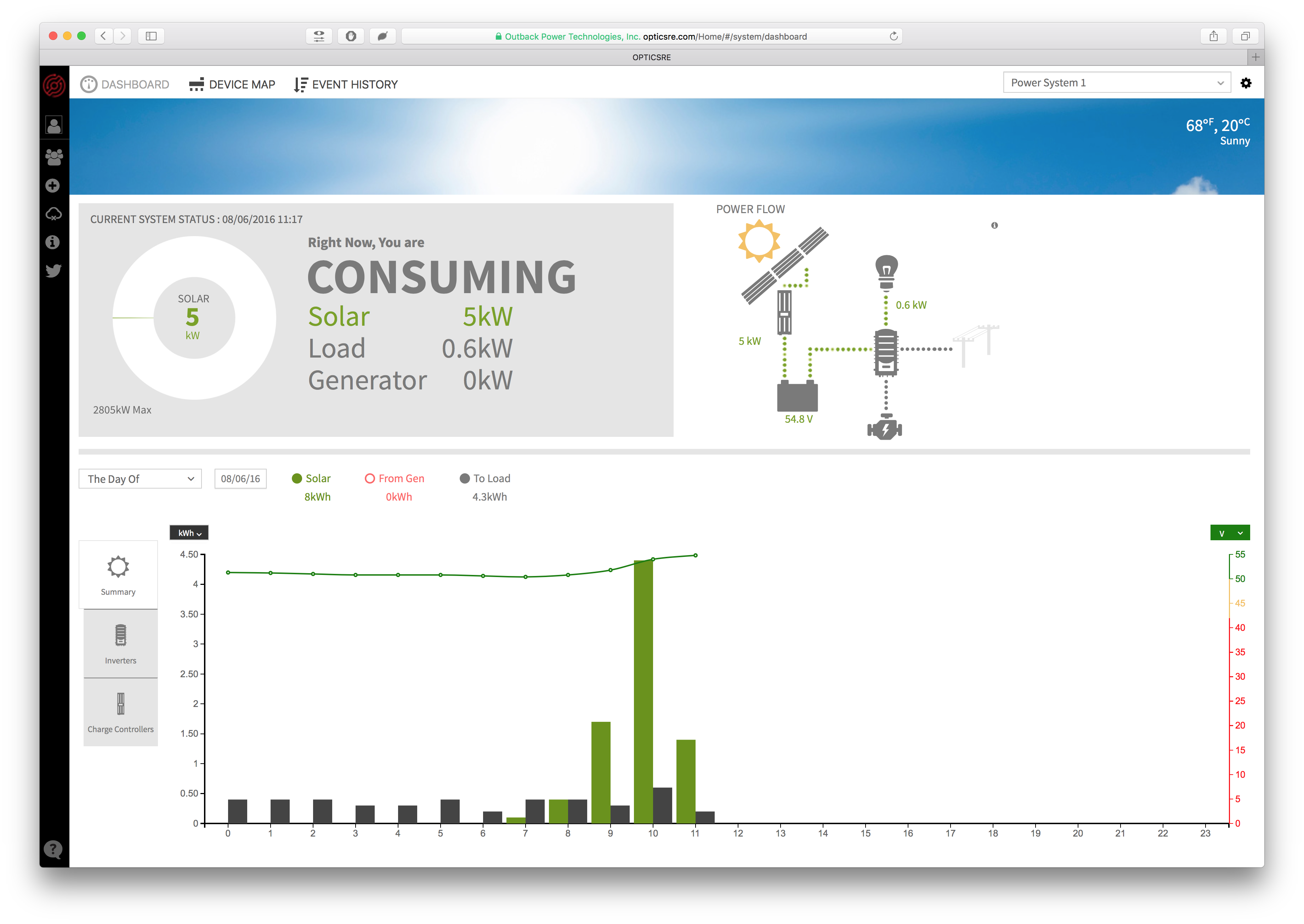

I got the second set of 12 panels hooked up this morning, and will work on the third set this coming week. I need to pour 2 more footings and get that other end of the rack ready to mount them.
Flipped the breakers and smiled as the power started rolling in. 5,000 watts at 11AM.

I have need to finish the conduit and put siding on the rack, but first getting things connected and cleaning up wire is the main task.

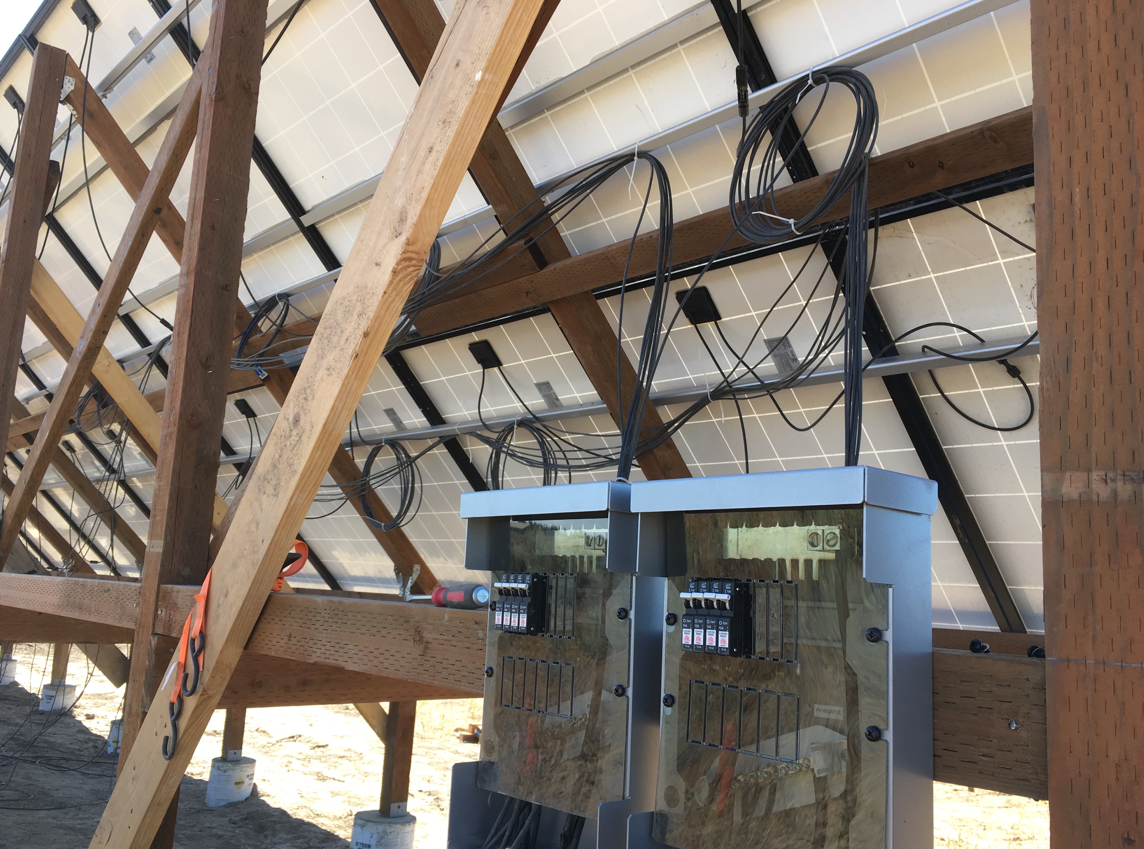

   / Check out my new battery! #64
~Moses
:thumbsup: Congratulations, and please keep us posted.
Rgds, D.
