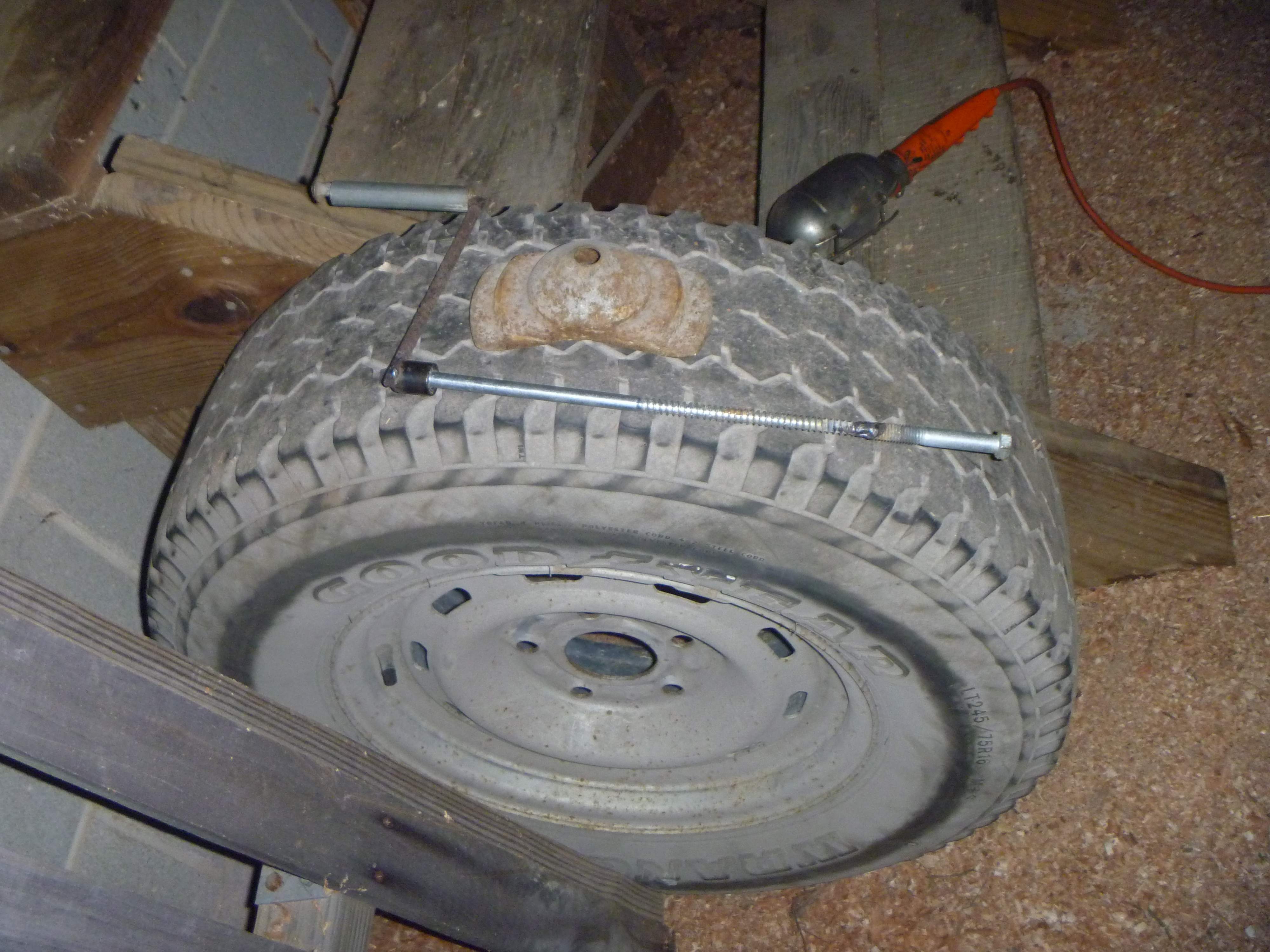

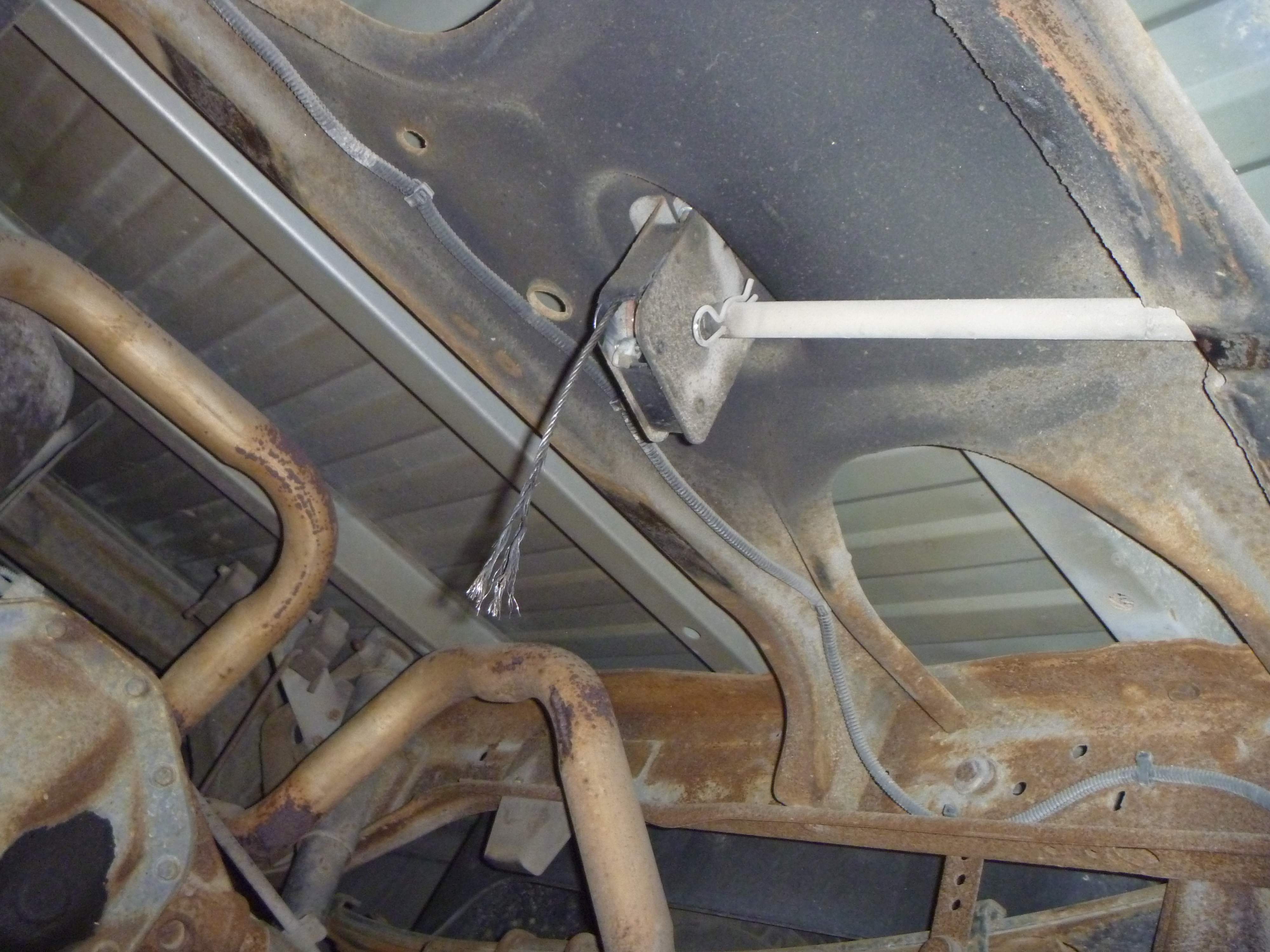

I took some pictures showing the break, spare tire and crank handle I made by welding bolts point-to-point. The cable looks bright with no rust. We don't have much highway salt usage in the winter in this part of NC so the cable hasn't fallen victim to corrosion. Would you guys replace the whole winch assembly? or swage a stop on the existing cable? I've had the truck about 12years and am yet to have a flat so the crank and spare have seen little use. The spare is almost bald and flat so little good it would do me if I needed it. I should replace it too.

I would replace the whole cable if possible.

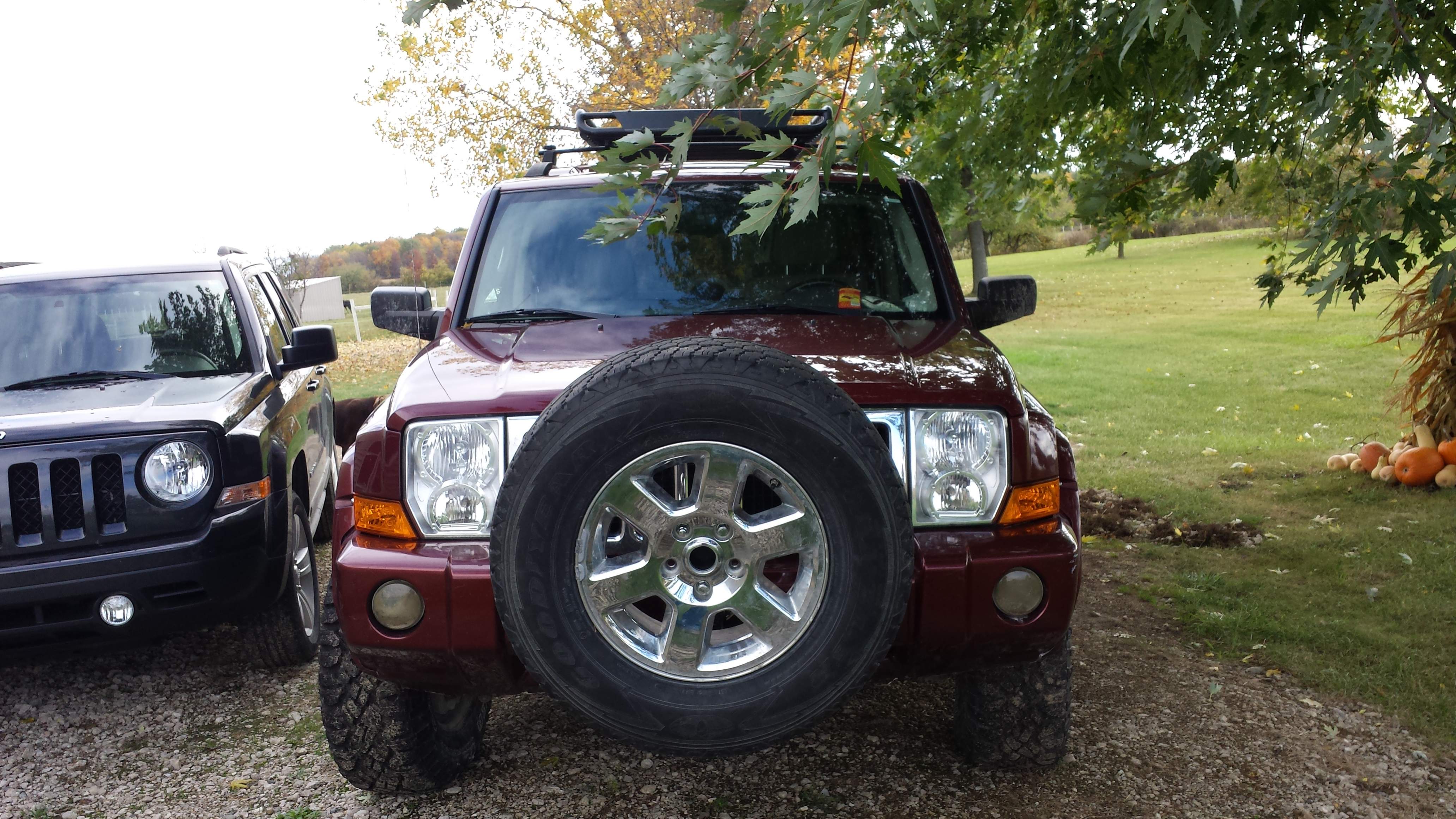

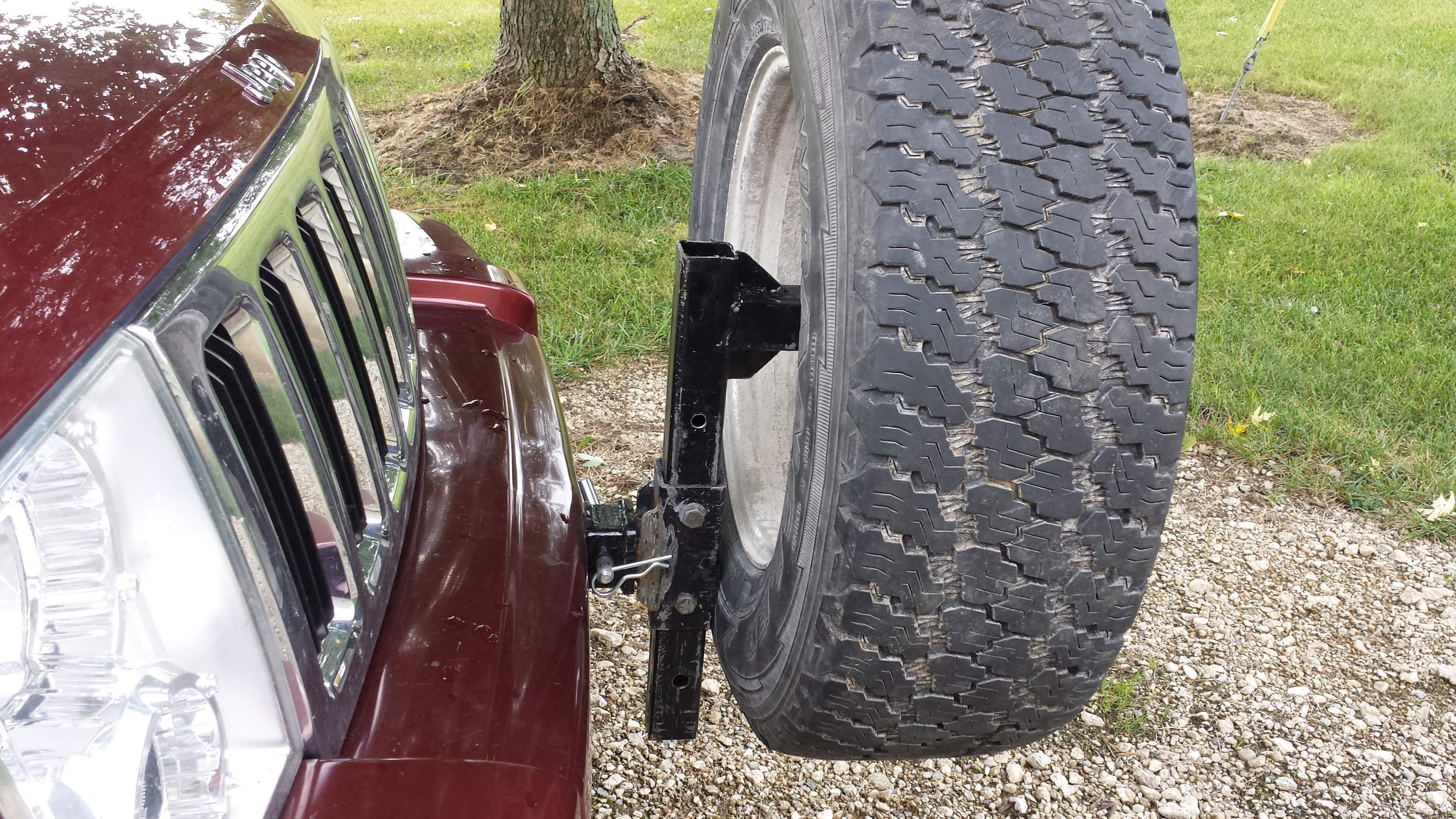

I always thought, if they brought back the front mount spare tire carriers, like the 1970's trucks, they would be a big hit.
You mean like this?
I can also mount it in the rear.
   / Check the spare tire carrier #18
Yes, exactly. That set up would be great, no issues with rusty cables, no taking up bed space. And the rear mount option would be great for those who have the front tied up with a snowplow.
