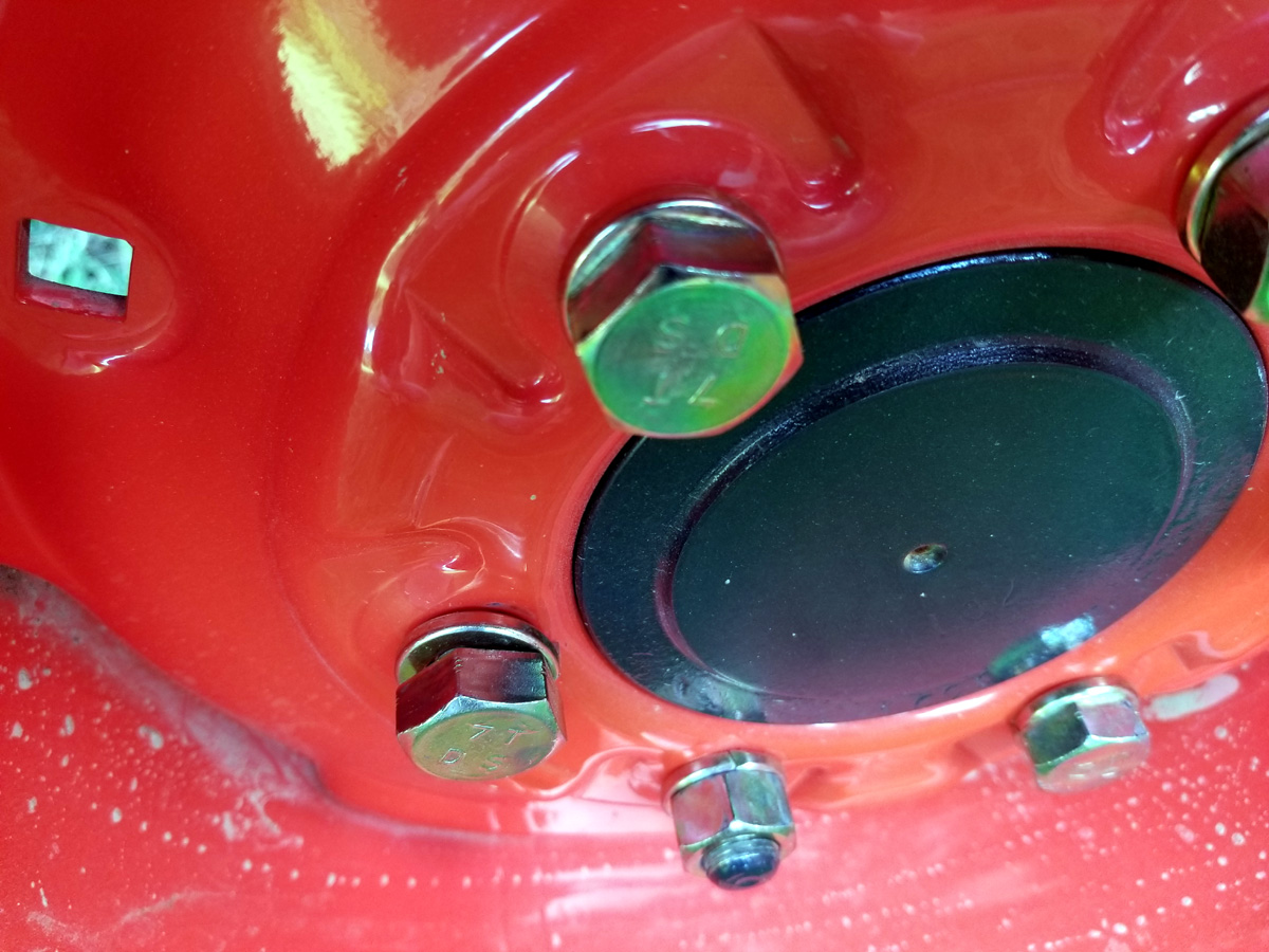

THANK YOU for this thread. I kind of dismissed it - my machine is brand new and I asked they guys to go back over it real good before delivery just to be sure. Figured no need to do this, but would keep in back of mind for when 50hr service time comes along and do it then. But then the replies along the lines of "this really applies to a new machine" had me worried enough I figured I may as well check even though barely @ 20 hrs now.
Rear tires, loader frame, all tight as can be. But most all the front wheels needed tightening, and in the pic you can see one backed off enough I could turn it with my fingers. So thanks for the heads up - I would have neglected this for a while longer had I not read it here!
