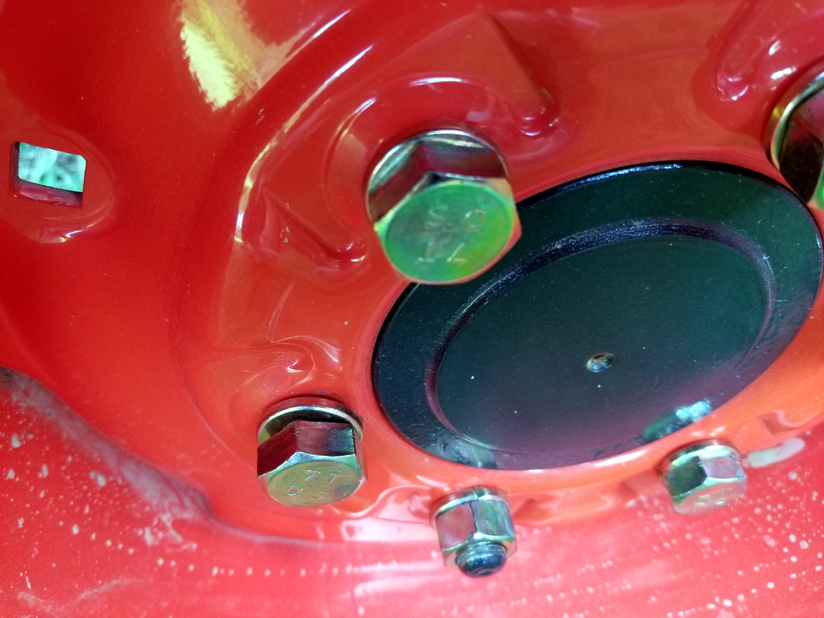

This will sound really stupid but maybe it will save someone some aggravation or even injury. I 've always checked my lug nuts when I change the oil but about six months ago I discovered that the large axle bolt that holds the hub to the axle was loose (Yanmar 240D). Discovered it by way of the rear wheel falling off! Lug bolts were nice and tight though...:laughing: Fortunately, I had a box scraper hooked up at the time so it just stopped moving and the rear end was held up by the scraper. I jacked it up and put the wheel and bolt back on with out problem but I'll be checking it with the lug bolts now!

I got the new rim today and took it to my local tire shop. They were not able to put one of the new studs in place because the threads in the hub are messed up and need to be cleaned. But, now I have a new rim and 5 lugs holding it on. I even went back over the 5 lugs with a breaker bar after I got it home, just to be sure.

After going to 2 hardware stores, 1 auto parts store, checking with 3 mechanics and one machine shop, I finally found a 14mm x 1.5 pitch thread tap to clean the thread so that I could install the last stud. My wife had one at the place she works. (She reminded me I should have checked with her first)
Now, I have all 6 studs and lug nuts back in place. I will be checking them often. I should replace at least one more of the studs, because when I went to take the lug nut off, the whole stud came out, which means the threads on it are bad and the lug nut is stuck on the stud.
