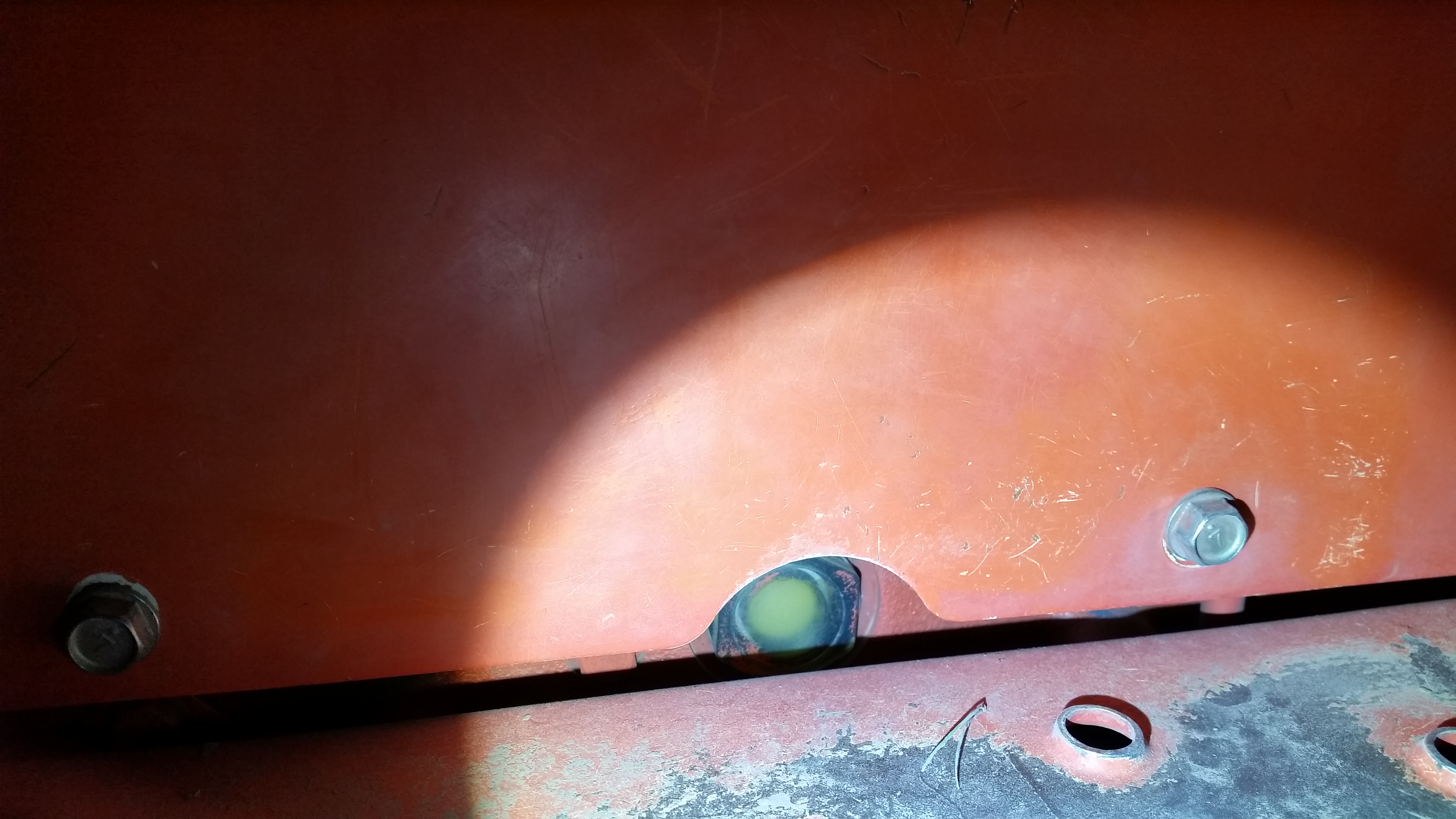

My 2009 L2800HST has had some really heavy use in the last two days and this morning I went out to grease things and check fluids. A week ago my transmission oil was mid-level and seemed clear against the white background, but this morning it looks more cloudy and is off the top of the sight glass overfull. Here is a picture with the bucket down and the 3 point raised:
It has been dry, the tractor is always stored in the garage and it has not been washed recently, so the only thing I can think of is the heavy gravel lifting and box dragging I put it through up until dinnertime last night really foamed the oil and it has yet to completely settle down, or if there is water in the oil, the oil cooler has failed. The coolant level is at 1" above the "Low" line on the bottle. I remember it being fuller, but it may also have been warm. Note that I have only owned this tractor for three weeks.

The jury is in this morning and the problem was not a problem. The verdict indicates the owner (me) missed some important clues that might have helped him avoid getting all worked up.
When I first bought the tractor four weeks ago, from the owners manual I learned where the sight glass was to check transmission fluid. It made no mention of how the attachments should be positioned, and my guess is when I looked at the sight glass, I had the tractor outside and probably did not have the bucket on the ground. I noted a line of fluid within the window and gave it no more thought. Skip ahead to yesterday morning with the tractor in the garage, bucket on the ground and no line of fluid, rather a full glass of what was now looking to me using a high intensity flashlight like it was milky (remember the flashlight part). My first thought was that the fluid level had increased beyond the acceptable range and it also looked contaminated. Alarm bells were ringing all over the place.
As the day wore on, some of your thoughts above forced me to think more about what might be going on here and I am grateful for that. From the file the previous owner left me, I noted he had had the dealer do a full 800 hour service in May of 2018, including a Super UDT2 and new filters fluid change, and now I'm thinking the dealer probably filled the system a bit to the high side, pushing the fluid level up out of the sight gauge with the loader completely down and 3 point up. Secondly, and most likely what really got me going, years outside sitting in the Arizona sun had lightly crazed the sightglass lens and while not a severe condition affecting fluid observation outside in the daylight, when I hit it with the flashlight inside the garage, the oil now looked milky and contaminated through the sightglass (see the picture in my first post above). Milky fluid made me think water or coolant in the fluid and with the level now appearing overfull plus a previous couple days of really heavy workload preceding this new feedback, well, I was off and running. Dollar bills were no doubt waving good bye!
