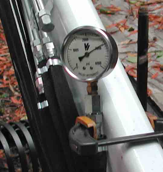

Where can I find pressure guages and where do I attach them?
This is the simplest way....just connect to one of the work ports on your
loader. This photo illustrates why I always test pressures on new
equipment. This is a $10 fluid-filled 4000psi guage from AgriSupply.
Harder to find is the system relief valve for adjustment. You need the
service manual for that. You also need the manual if you have no
loader or AUX valves.

If you go to the McMaster Carr site and look up guages they have similar verbage and show higher accuracy for mid scale readings. Looks like a good guage can be had for about $130.
