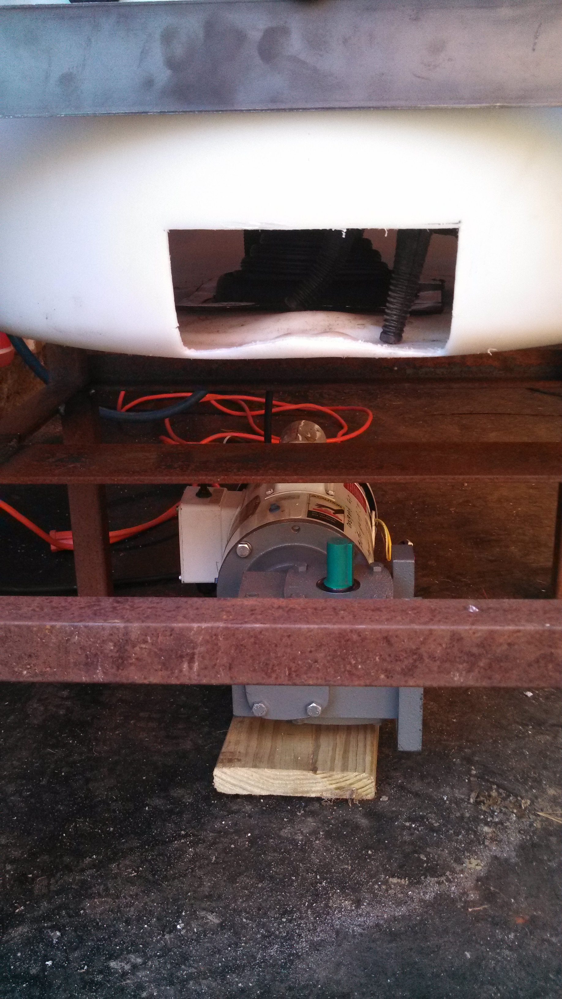

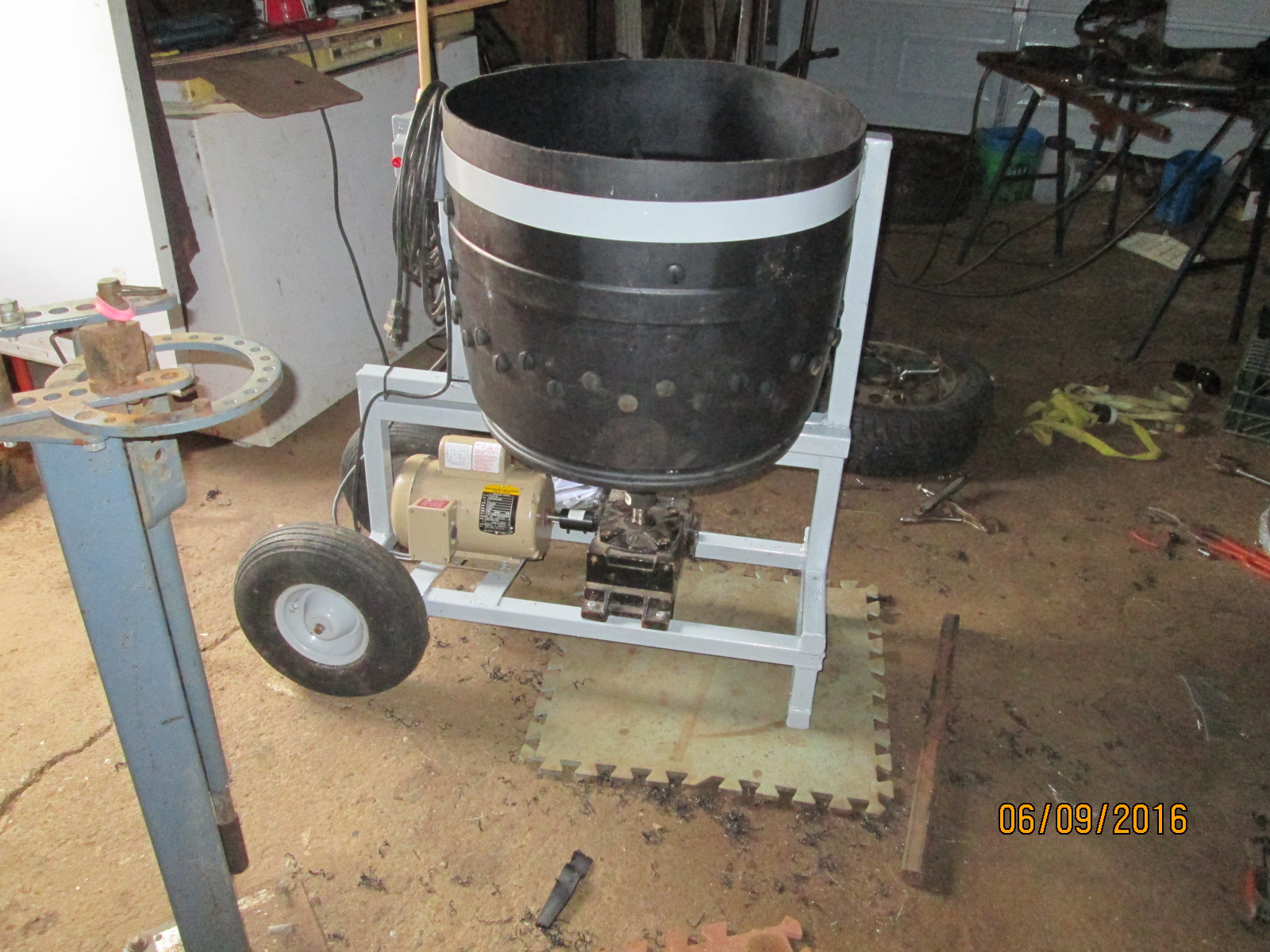

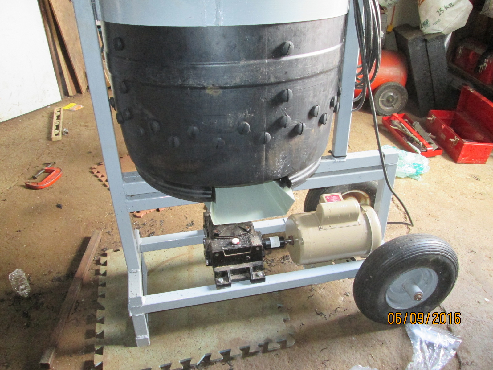

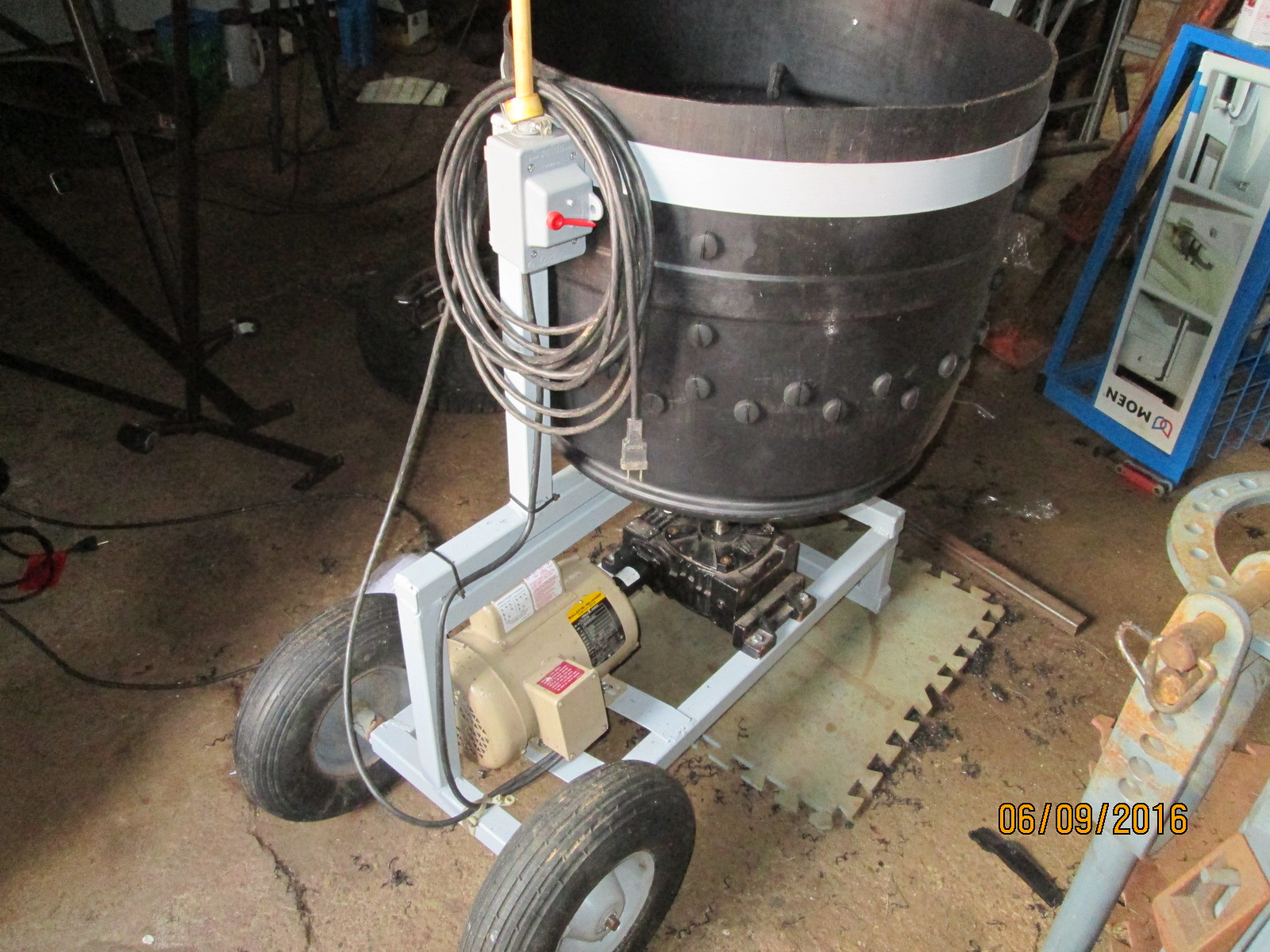

Well new season and new plucker built. Since I had a spare gear reduction 10:1 and a 1725rpm 1 hp motor that was new and not able to be used on my big plucker . needed 30:1 and a 3450 rpm for that one.
I built it added a couple better mods Then I sold it for $900 only after 66 meat birds through it.
As soon as it sells I get a couple calls to pluck chickens . Mad rush now to get a 3450 motor Did find one at 3/4 hp that seems to work . Sunday will tell a better story if it does.
   / Chicken plucker biuld #56

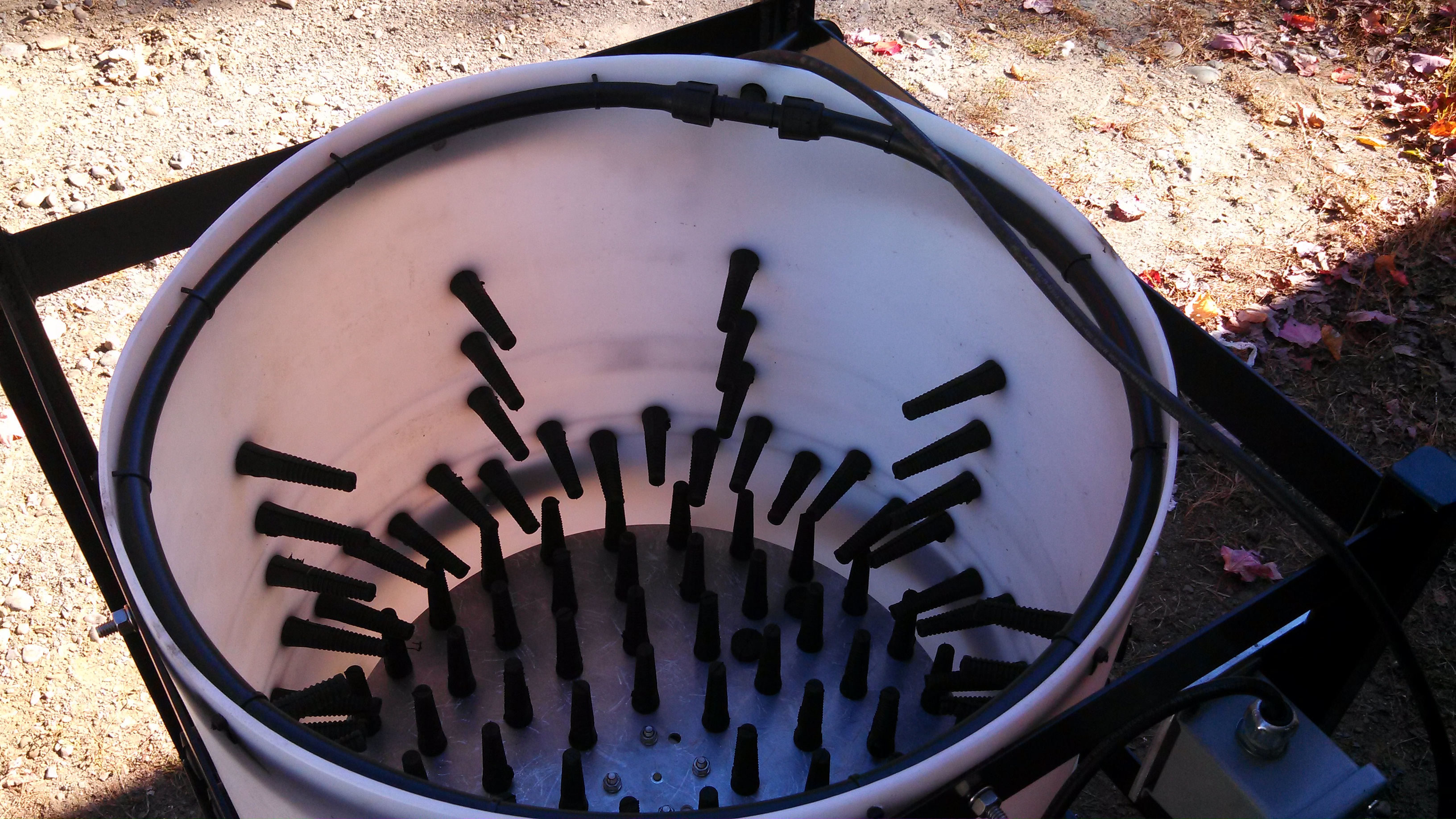

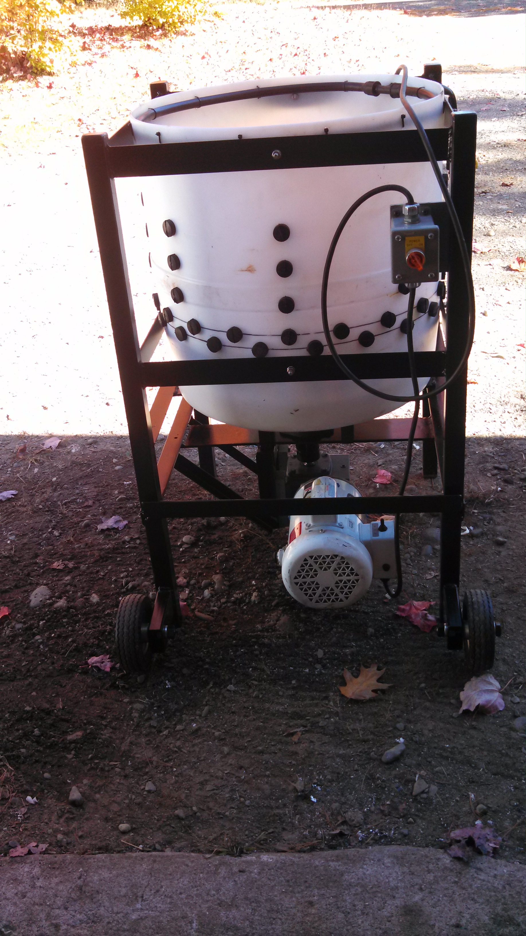

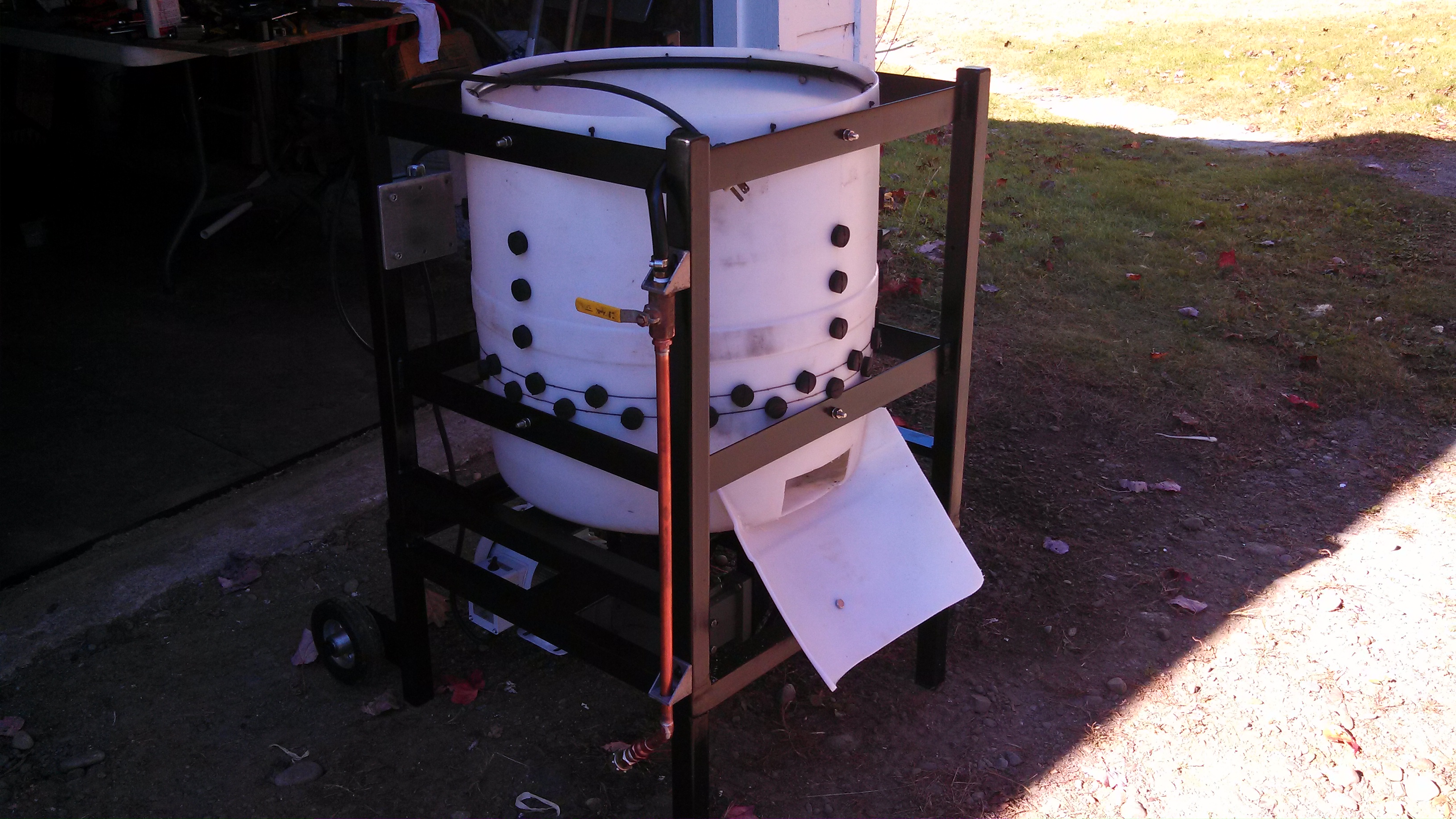

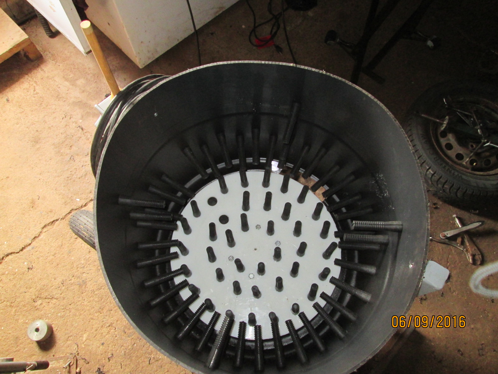

I went with the direct drive as well found a washdown motor and a bolt on gear box on ebay. I put a few fingers pointing down under the plate it really helps to fling out the feathers also did a spray around the rim helps a lot. Used a roof stink pipe seal around the shaft to keep water off the gear box. No Problem plucking chickens, turkeys, ducks, or geese.
