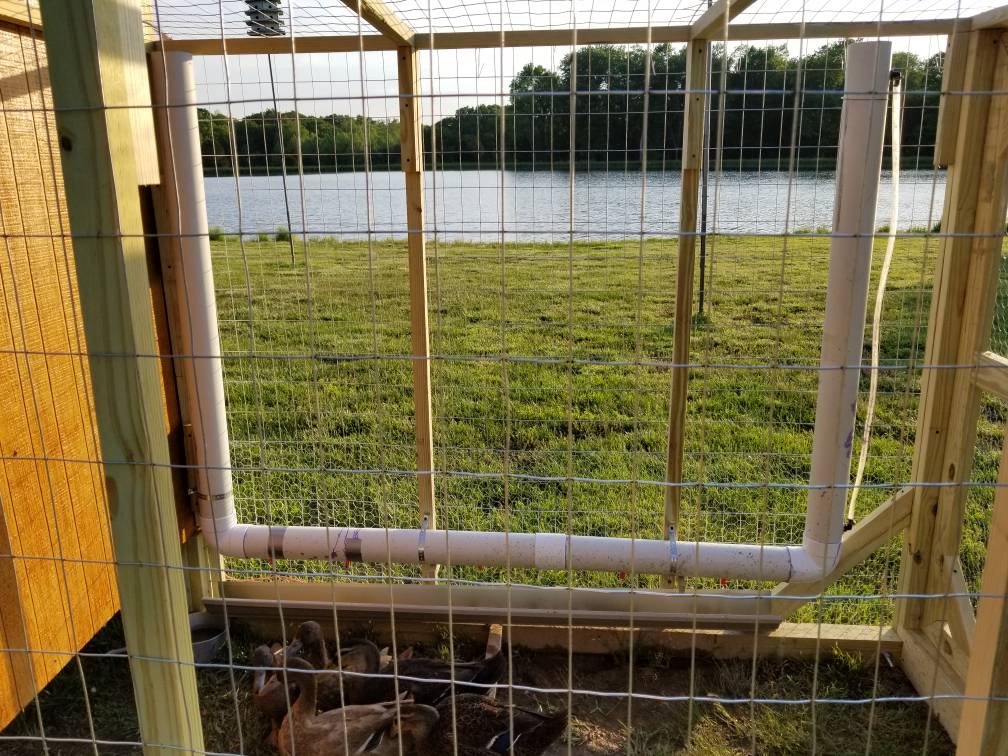

This spring bought a few ducks and some guineas. I setup to vertical pvc pipes to feed one horizontal pipe with nipples along the bottom. Got that ideas from the internet.
Think it would be a good setup...but it leaks. Got screw in type nipples from Amazon, and used thin wall sewer pipe.
The thin wall pipe might be the issue, the nipples did not screw in securely. I did put sicilone around the bases. I need to redo this, but those who use, advice please on how to setup. PVC sch 40? A better different nipple, note some use gormets. Or use a completely different setup?

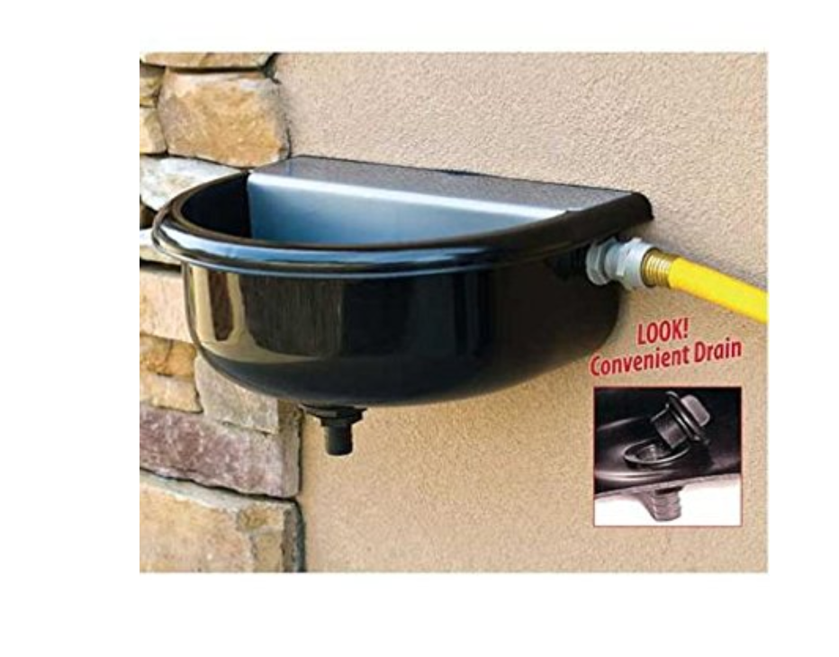

I stumbled across the tough guy auto waterer on Amazon for $16+...it's a fair amount more elsewhere. Anyone used this item?

I just set up a system with a bucket filled from a hose via a float valvle; a short nipple (MPT/MPT PVC nipple, not chicken watering nipple) on the bottom of the bucket going to a PVC T, then a more-or-less horizontal run of 3/4" PVC from below the bucket. Nipples are drilled in (11/32 if I recall?) to the 3/4" sched 40 PVC line; I used teflon tape but no silicone. No leaks at all.
Part of your problem may be excess pressure - no kidding. These things are meant to have almost no water pressure; if your 2" verticals are full, that's probably too much water pressure. The top of the water level in my bucket is maybe a foot above the nipples.

I used thin wall sewer pipe, and believe it is an issue. I tried 11/32, could not get them screwed in. Used 23/64...and believe it was just so slightly to big. After finding this setup leaking, I had a small piece of sch 40, drilled 11/32, and they screwed in.
I bought the same nipples. I also used a couple in the bottom of a thin plastic 1 gal jug in a brooder area it worked fine....something about that sewer pipe I think is the issue.
   / Chicken waterer nipples #9
Could be. My proof-of-concept bucket was really thin, not sure how it compares to sewer pipe as I've only seen black ABS sewer pipe - if it's sched 125 pvc, I'd be surprised if my crappy test bucket was any better, but then it was a flat surface vs your 2" round - mine are now screwed into a 3/4" round side but it is thicker.
I couldn't screw the nipples in by hand; I used a nut driver and let them spin and then they finally grabbed and went in (I've heard of people tapping a thread, but I'm lazy enough to try without the first time and it seemed to work).
