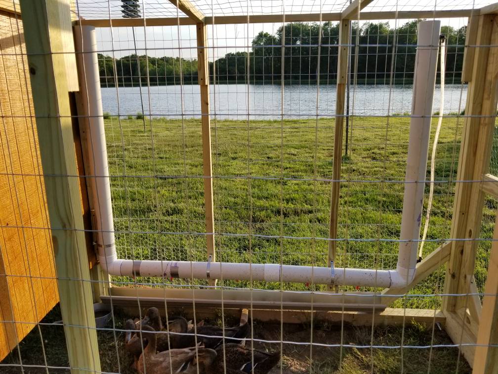

This spring bought a few ducks and some guineas. I setup to vertical pvc pipes to feed one horizontal pipe with nipples along the bottom. Got that ideas from the internet.
Think it would be a good setup...but it leaks. Got screw in type nipples from Amazon, and used thin wall sewer pipe.
The thin wall pipe might be the issue, the nipples did not screw in securely. I did put sicilone around the bases. I need to redo this, but those who use, advice please on how to setup. PVC sch 40? A better different nipple, note some use gormets. Or use a completely different setup?
Here's what I setup.View attachment 508864
Use what the pros use: Ideal poultry equipment for broiler growing | Poultry growing | Big Dutchman
If you have any commercial poultry operations around you they should be able to set you up real quick.

Watering - VAL-CO
Our water system is from this company. We use the roaster style nipple on 10 inch spacing. If your water lines are kept at the correct height very little leak and mess. Current number of birds is 90,000.

Those commercial watering system pretty fancy. Like Eddie says...need it a littler simpler.
One thing I notice, the nipples are on square tubing, and also little catch cups for dribbles of water.
