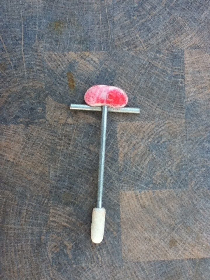

What I have done with ours is to set up a trigger feeder. That has a piece of steel flat stock that is about 1 inch tall and 4 inches wide with a piece of all thread 6 inches long welded to it to make a T shape.
Then, I drill a three-quarter inch hole in the bottom of a 5-gallon bucket (or I've also done it with a 35 gallon drum).
Then I have a 4 inch circle of plastic bolted onto the bottom of the all thread where it sticks through the hole and when the chickens peck on it it makes the flat stock in the bucket move and drops feet out through the hole. Then they eat the feed, peck again and more food comes out.
We have seen a lot less wasted feed this way and also a lot less other birds in the chicken coop (starlings, grackles, barn swallows, etc).

Need a picture of that!
Here is a similar one:
Mine is just a straight piece of flat stock instead of the shaped piece that they have and I have a disc held on with nuts on top and bottom rather than the plastic "stick" that they use.

I just made one of these using a 2 gallon bucket. Haven't had much time to watch the chickens to see if they've figured it out. I've seen them playing with it but don't know if its constant. I may color the white PVC spacer red to draw their attention more to it. I do like the concept though
   / Chicken waterer nipples #30
The discs on mine are red, I had white tubes for a little bit but they didn't seem to be using it but they used it much more when I switched to red disks.
