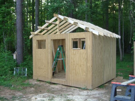

Progress on the coop. Although I didn't get started until after lunch, I did make some visible (but not amazing) progress today. My wife was able to help some this afternoon. This is always appreciated.
I got all except the last rafter in today along with notching the end rafters for the gable end extensions. Cut and notched the gable extension for 3 of the 4 gable sections. The attached photo shows where I left off today.
The gable extensions are not yet nailed in - I think I'm going to put the 2x6 subfacia up before I nail the gable extensions. Then, I'll put up the Hardie fascia and rake boards, add the sheathing, drip edge and roofing paper.
The good news is that my brother is in town to visit his daughter and he has offered to come over after church tomorrow and help for a few hours before he drives back to FL. As much as I appreciate my wife's help, my brother knows how to handle a saw, nail gun, etc. He thinks we can have the roof completed tomorrow before he leaves (except shingles). We'll see how fast it goes with him on board.
I'll update tomorrow after the taskmaster heads home to FL.

   / Chickens, and things related #518
bmac,
It looks great. You still need to do the corners the same way, just be sure to change your angle so that the flat side of the board is flush with the end of your rafters to attach your fascia boards.
You sure know how to enjoy a three day weekend!!!
Eddie
   / Chickens, and things related #519
EddieWalker said:
bmac,
Eddie
Thanks, Eddie. For the corners, I was just going to run a 2x6 along the end of the rafters, but long enough so that the fascia on the gable ends (what I have been calling rake boards) would have something to nail to on the ends. This also will satisfy Hardie's recommendation for having the fascia supported by wood. The term they use is subfascia. Wouldn't this work for corner support?
On the gable ends, I was going to forego the 2x6's per your earlier comment that it is not really necessary to add the wood backing to the Hardie fascia and doing so would have really messed up my measurements.
Please tell me if I'm about to screw up.
And, BTW, this is how everyone should spend a 3-day weekend. So, if anyone is without a fun project like this for Memorial day, I am accepting volunteers for Monday. :D
   / Chickens, and things related #520
bmac,
Yes, a 2x6 "subfascia" will give you the support for the corner of your decking. I forgot about that, but it's a good idea and method to attach the Hardi.
I've been framing all week for a job that I'm doing, so for my three day weekend, I'm moving dirt. Framing is allot of fun, but so is moving dirt!!!!
Eddie
