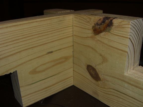

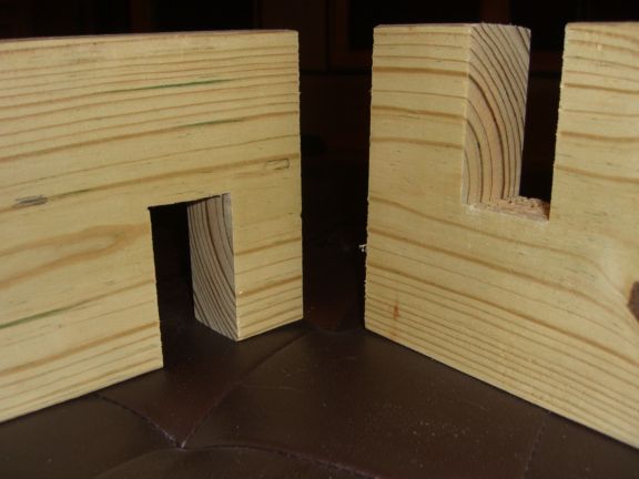

OK, Eddie. The above quote is from an earlier reply about framing out the gable end of the roof. Although it was too late to work on the coop when I got home this evening, I thought I'd make a test run of what I think you meant on some scrap wood.
The first photo shows the notches (the first set was too deep so I made an adjustment and cut another set).
The second set shows the assembled product. The edges actually are flush despite the appearance of the photo.
I asked the guy at the lumber yard what he'd recommend for fascia and soffitt. His reply was HardiPlank so that's what I bought. I think I should have researched this before buying. Had I done my research first, I would have known that the Hardie fascia requires a solid wood "subfascia" Which means I have to put up 2x6's on the rafter ends before I put up the Hardie fascia. I'm committed to this now as I've shortened the rafters enough to account for the extra thickness. It also now means that I'll have to shorten each end of my ridge board 1 1/2 inches. I can do this with a hand saw or a circular saw - either way I'm doing it while atop a tall ladder - not something I'm looking forward to.
As far as the Hardie soffit material, I think I'll be forced to install it horizontally and add some 2x4 framing from the walls to the ends of the rafters along with a nailer board running the length of the 2 side walls. Essentially, a conventional houe soffitt. With the 2x6's added to the ends of the rafters, I don't think I'll be able to fasten the soffit material to the underside of the rafters as there will be a large gap between the soffitt and the 2x6 subfascia. Am I making sense?
Oh well, I'm learning from my mistakes.

Hey bmac,
You can do the gable ends a few diffrent ways. The way I do them is to cut the end rafter short and rest the 2x4 on top of it. Then I cut lengths of wood to fit between them to make it solid. Then I put my stud into the space under the rafter so that I can fasten my siding to them, and of course, so they help support the roof.
The notches look good and are better then nailing to the ends of the rafters. Just about anything is better then that. I've never actually done it that way, but I've seen it done by others. It's more labor intensive in my opinion, but the finished results are probably going to be allot nicer.
Your choice of Hardi for soffits and fascia is a suprise. Guess it was a suprise to you too!!!!!!
I might catch it for this but you really don't need backer for Hardi for your soffits and fascia boards. What you do need to do is rip them down to a reasonable size. 8 1/4 inches is WAY too big for a fascia board.
How big did you buy your Hardi for your soffits? Did you buy the vented Hardi designedfor soffits? It already has the holes in it with screen on the back of it. I don't remember the price of it, but it's rediculous high. You can also use the 12 inch Hardi, but again, it's too expensive. I like the smaller soffits that you can get with the all grained 8 1/4 Hardi. Of course, you need to like the look of a small soffit.
The house I'm working on now has 2 foot soffits. For this, I'm using an exterior grade 4x8ft sheet of luan that I'll rip in half. This is how most soffits around here are made. It's easy to add a vent to, it holds pain well and it's nice and smooth. For the fascia, it's going to be hard to beat Hardi.
How are you attaching it? I use a roofing coil nailer.
