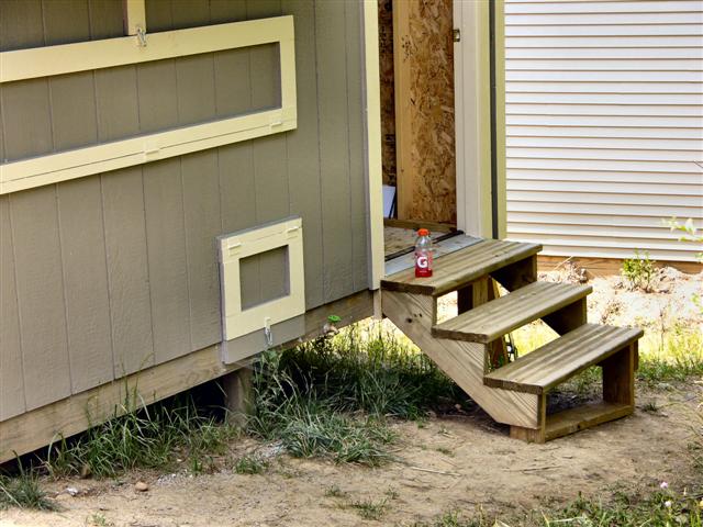

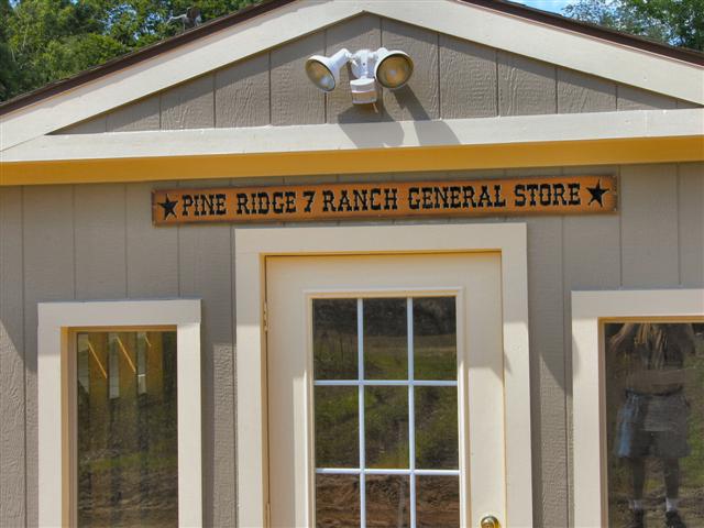

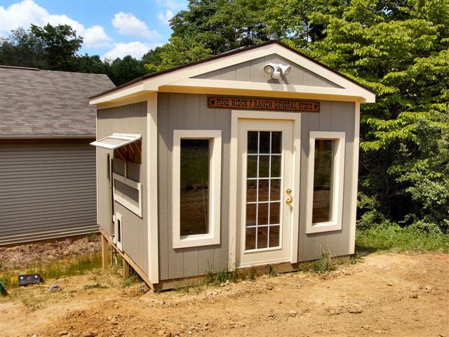

The exterior of the coop is almost finished. I need a few small details inside finished, then I'll turn my attention to the run. Here's a couple of shots I took today.
The wife is really liking how its all coming together.

Wow that coop looks nice. It really came out great, and the sign is a nice touch. I had hoped to have my coop started by now, but have had some health issues so I put my plans on hold. It's nice to follow your progress since I don't have a project going.

The sign was actually left over from a retail store that we closed. I figured that I might as well use it. Thanks for the nice complement. :D

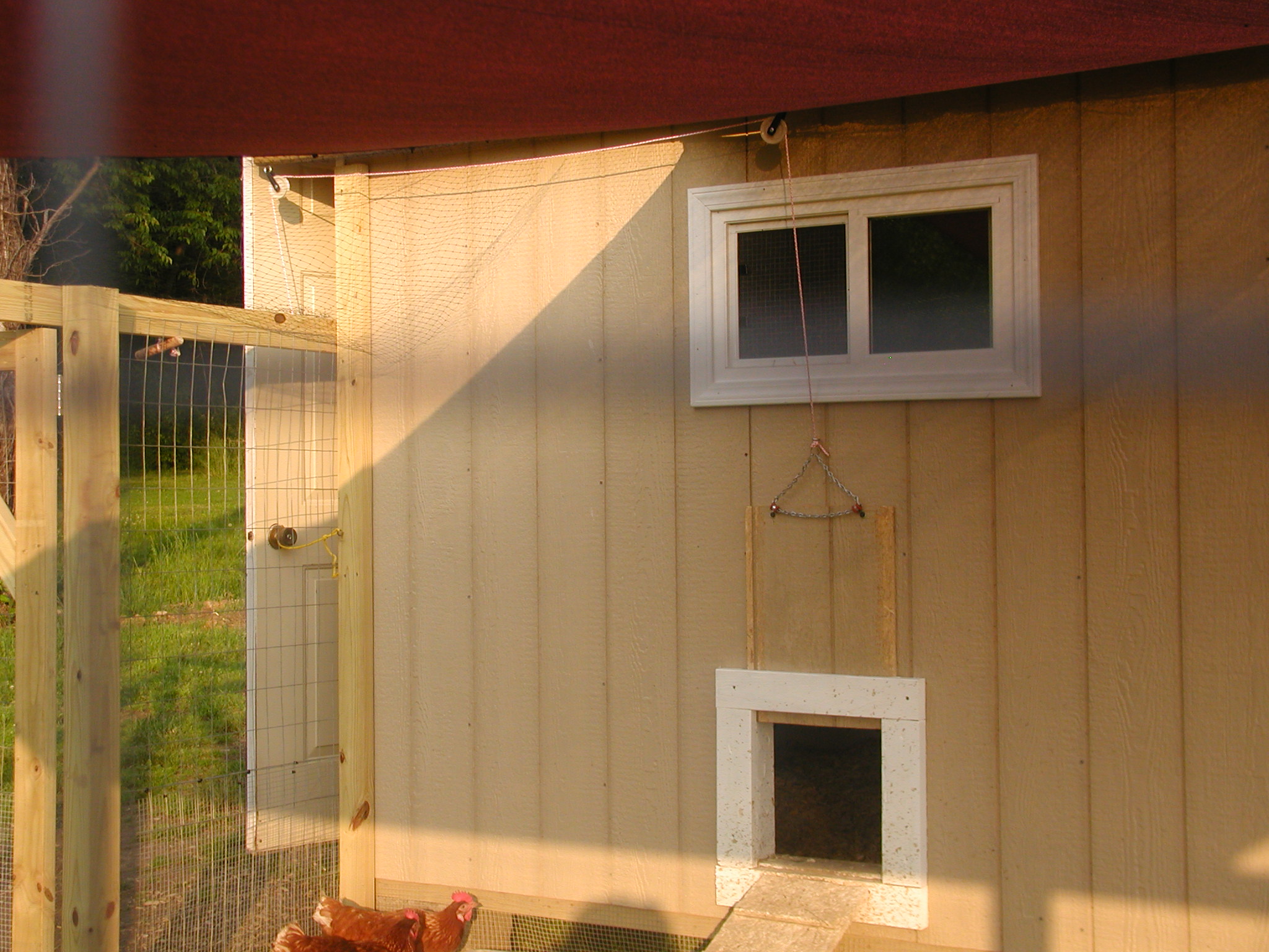

Here's how we handle the pop-door. I wanted a way to secure it from the raccoons. The first rope you pull lifts the hinged 2X4 and the 2nd rope lifts the door. When you drop both the weight of the horizontal 2X4 keeps the prop secure against the sliding pop-door. Simple but it works.
Mike-
That's an ingenius solution that I intend to copy. I was thinking that you could raise both the lock and the pop door with a single rope if you left a little slack between the lock and door. That way, pulling the rope would lift the lock out of the way first, and, once the slack was taken up, the door would rise.

Jerry I think your idea would work just as well with a single rope. Sometimes the best things turn out to be the very simple things. I saw one guy experimenting with electro-magnets for locks on pop-doors and I said yeah, right.....

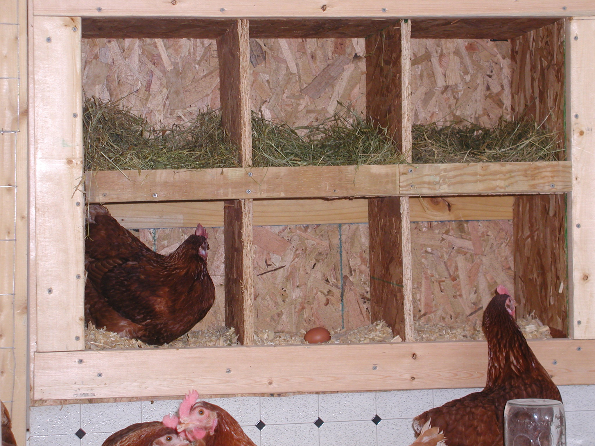

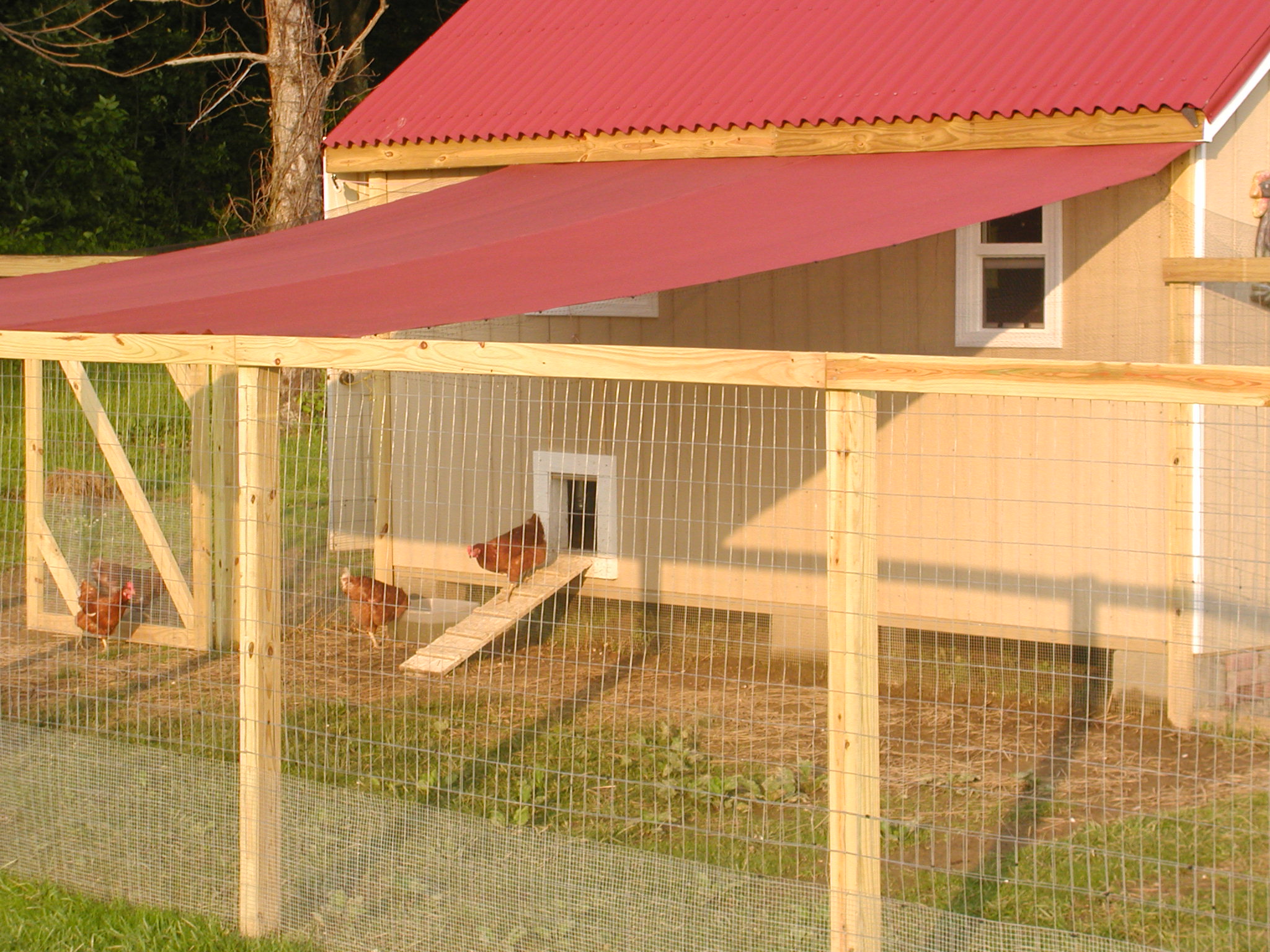

Pine,

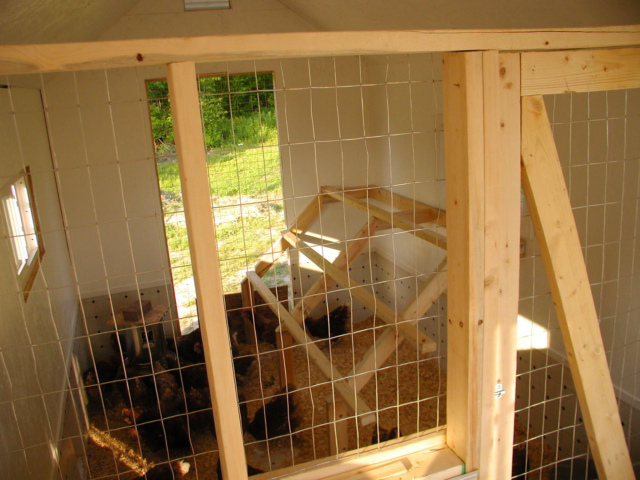

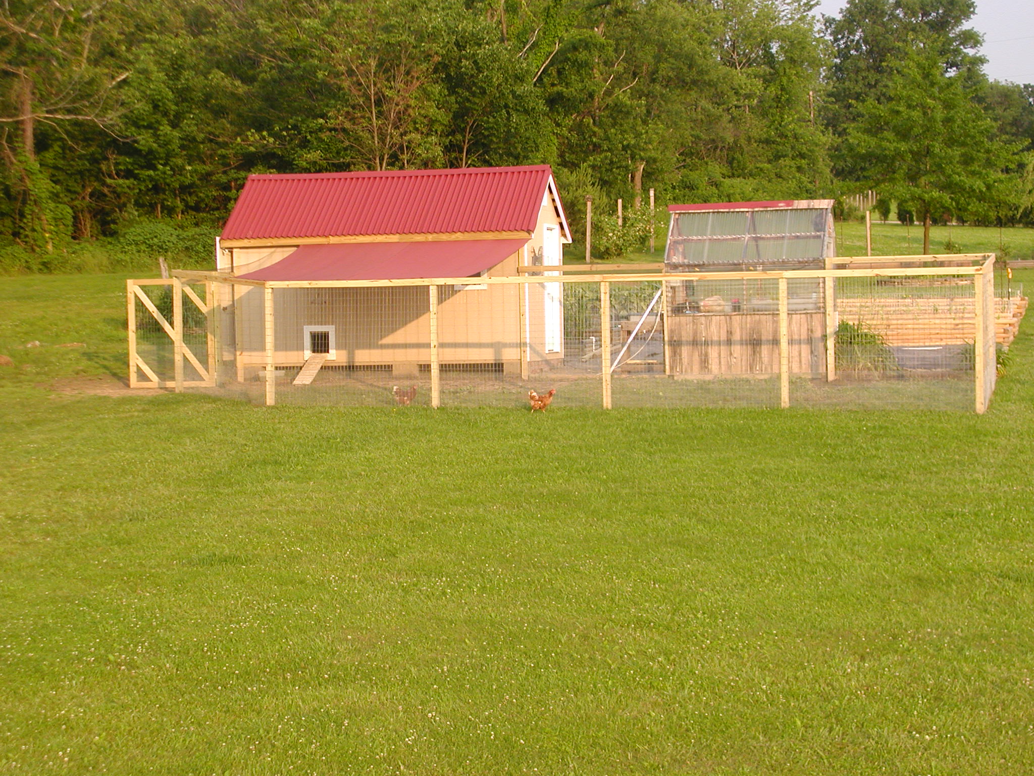

Nice looking coop. Here are some picture of our coop we just built. I don't know why I didn't do it sooner. We love having the chickens around.

Ray that's really a great coop. Very clean!
Can you post a few more shots of your fenced run? That's my next job and I really like your design. Did you use wire on top?
What is the smaller structure that looks like a greenhouse?
