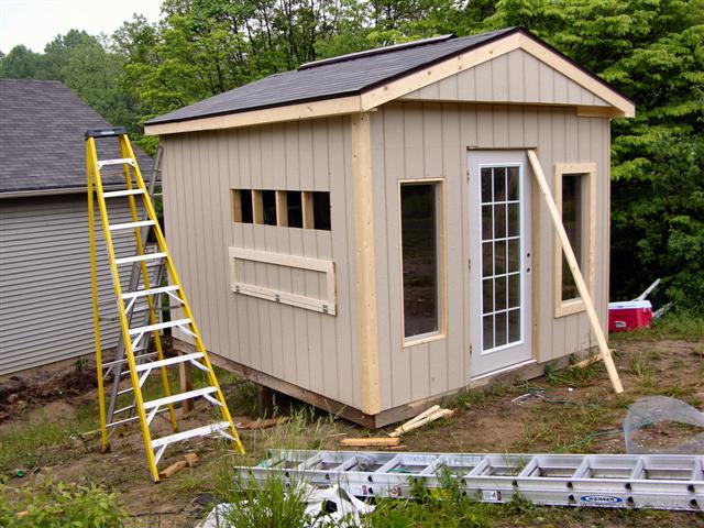

Well for the past couple of days it's been raining here but we managed to make a bit of progress running between the rain drops.
BTW: How do you all secure a hinged compartment against predators without using a padlock? (this is not a quiz)

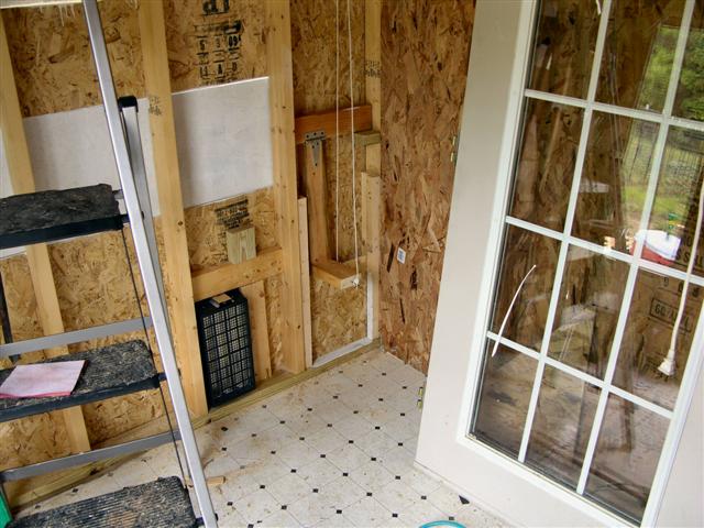

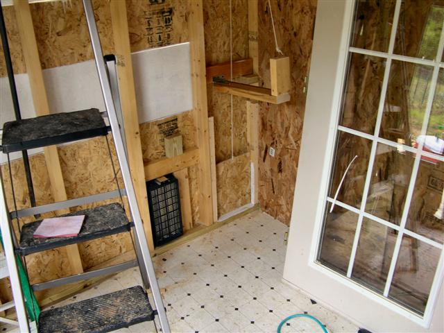

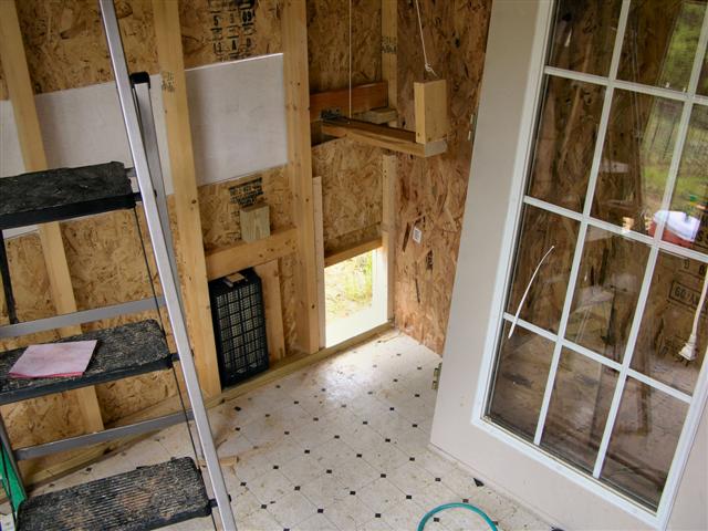

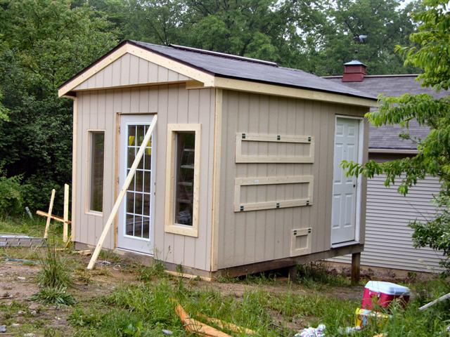

I can see the light at the end of the tunnel, we're almost home on the coop.
Here's how we handle the pop-door. I wanted a way to secure it from the raccoons. The first rope you pull lifts the hinged 2X4 and the 2nd rope lifts the door. When you drop both the weight of the horizontal 2X4 keeps the prop secure against the sliding pop-door. Simple but it works.

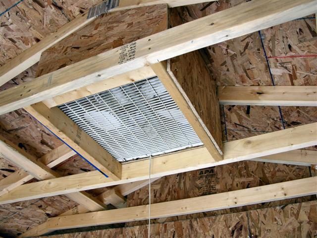

The Black box that you see in the picture is a foundation vent that we mounted in the sidewall. It has a bi-metal that opens a set of louvers at 70 degrees.
We then took an old box fan that we got for free at Craigslist and boxed it in overhead to draw air through the coop. I am looking for an old furnace fan control that I'll wire into the fan so it automatically starts as the temperatures in the coop rise. The fan really moves a lot of air through the coop when its on.

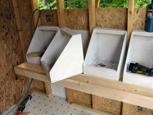

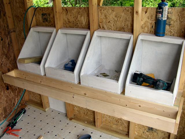

We finished up the 1st of two banks of nesting boxes with perch. We wanted the boxes to lift out for easy cleaning.
The eggs can be collected from outside the shed via a hinged door.
The door you see below the nesting boxes will aid in sweeping out the coop at cleaning time.

I didn't see where you had roosts located for them to sleep on. Keep in mind that they poop a TON when they are on their roost. So watch what is below the roosts. The higher the better on the roosts too. They love to be up high.
   / Chickens, and things related #928
If you didn't already have them designed in I would tell you to skip the additional nest boxes. 4 will serve a load of hens. They tend to all lay in the same box. I think I have 5 boxes for about a dozen hens. I could easily get by with 2, and that would probably be plenty for 15 hens.
   / Chickens, and things related #929
Thanks for the tip Shawn. I'll most likely put off making the second set of nest boxes at your recommendation.
I plan to make roosts from 2X4s turned on end and at different heights. Most likely they will fold up so cleaning will be easier. I have also been kicking around the idea of putting one of those large plastic drip pans that you put under a car in the garage to catch oil drips, guess what it will catch... :rolleyes:
