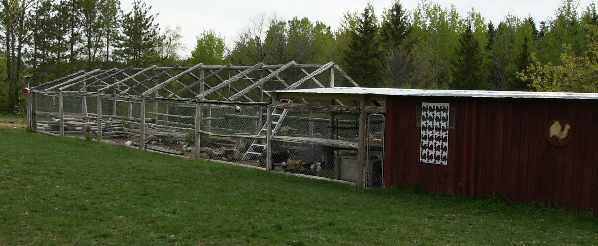

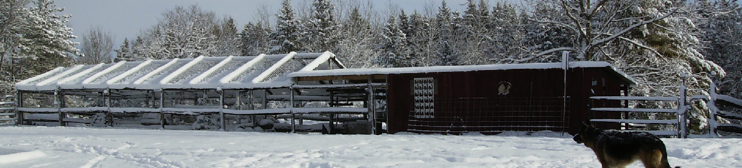

No question it is daylight hours. They will lay more with artificial light.
I have quite a few different birds (mostly chickens) and keep them in an aviary and chicken coop that are attached together. The coop building is 24' long and 16' wide. It has a 6 foot roof overhang on the one side (you can't see it in the pics) and a 12' roof overhang on the side that attaches to the outdoor aviary part. The aviary part is 62' long and 16' wide and is divided up (with welded wire) into multiple pens that can be left open for community housing or closed off (we use closed pens for meat birds in the summer or sometimes if some birds fight or need to be isolated). The whole thing is surrounded with chain link 6' high and covered in pheasant netting. There are a couple of strands of electric fence that go around so any critters that try and climb in get zapped and fall off (run a hot wire around and the chain link is the ground). The construction of the building is OSB with wood siding and OSB on the roof with tin over top. The aviary is made from cedar posts and rails that go into the ground about 2' - there are over 130 of them altogether. Note on the pasture side there are horizontal extra rails so the livestock cannot not scratch or rub directly against the chain link and ruin it. There are multiple doors to get into and out of both the building and aviary part so if ice and snow get too high we can still use it. The building itself has a small 8'x8' "feed room" with old freezers in it and the rest is divided into 2 large rooms. One of the doors to the building is a dutch door and we can leave the top half open so the birds can go in and out in the summer when we let some of them free range. Sometimes we close one door to half the building and keep sheep in that part. Most of the doors in the building slide to open so we don't have to worry about them being blocked by snow or bedding build up. There is electicity and a water hydrant too for ease in the winter.
It works great. The best part is it was under $1000 to build as I scrounged and traded for a lot of the materials. It was built in stages over a few years too (as the budget and time and materials permitted). Next summer I will extend the roof overhang on the other side of the building too. No problems with varmints except for weasels once and it's about impossible to fence them out. The weasels were not a problem until they ran out of mice and then started on the chickens. You know you have a weasel if the mice suddenly are gone!
NOTE: The only mistake I would say we made is I cannot clean the thing out with equipment. It takes a lot of shoveling and that is a drag.
