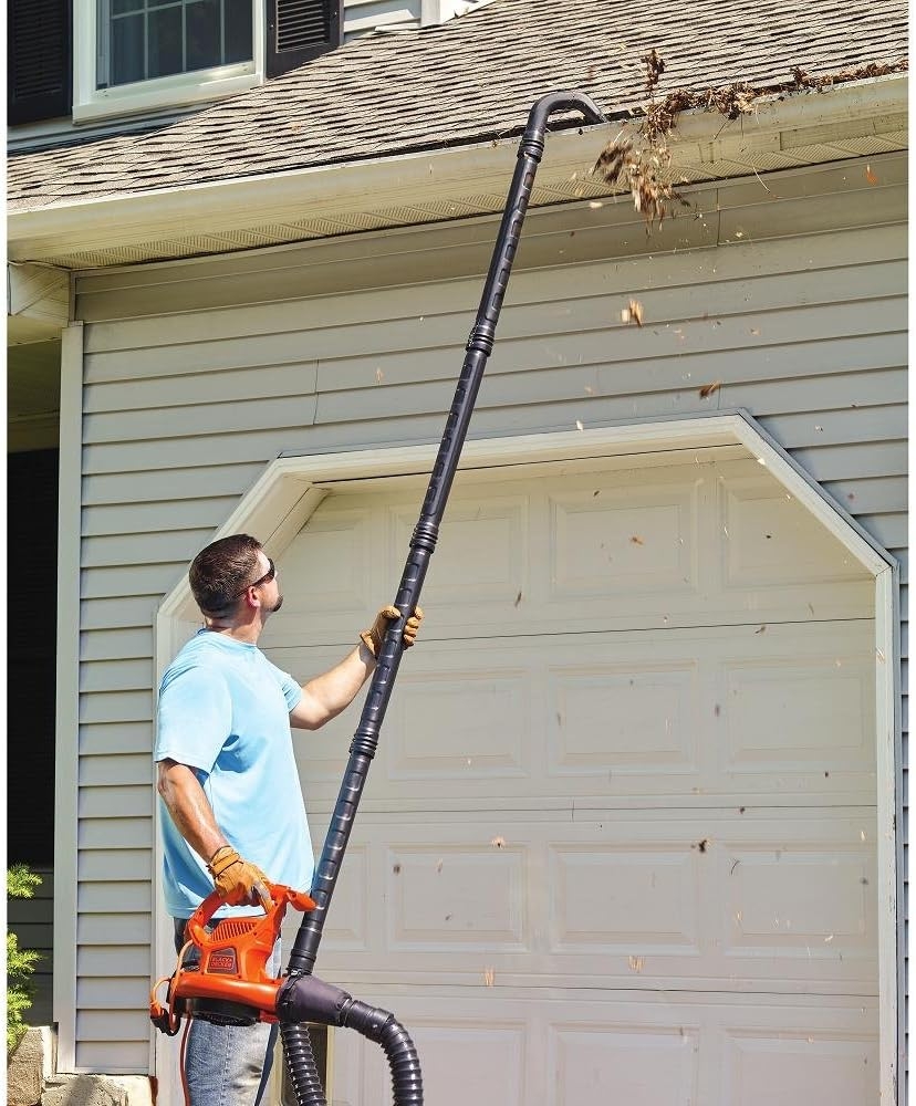

Getting pine needles out of roof gullies and other traps is definitely a chore, but an important one. FWIW: I have moved to cleaning the gutters from the ground with an extended nozzle for my leaf blower. They are brand specific, but there are universal ones, too.
(No, that's not me...)
I also use the long nozzle from the ground to blow leaves off the roof.

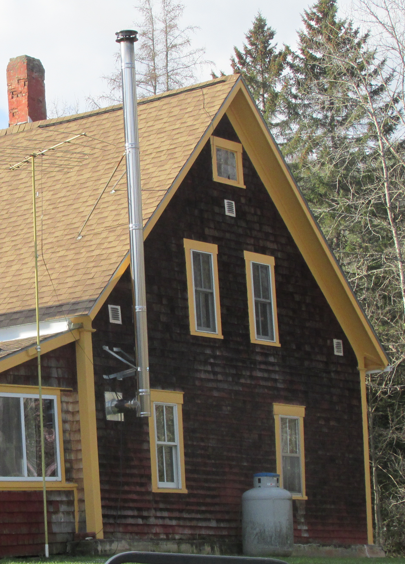

As you can see in the photo, there's no way to clean the SS chimney from the roof, nor would I want to given the steepness (the brick chimney is no longer in use), but there's a cleanout cover on the bottom. I'll just throw a tarp on the ground and use an 8" round brush with fiberglass rods to clean it and all the mess stays outside. Inside pipes come apart easily enough to bring outside, but generally stay relatively creosote-free.
