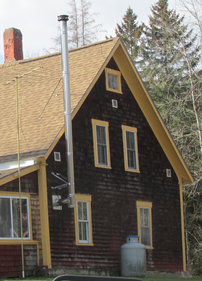

As you can see in the photo, there's no way to clean the SS chimney from the roof, nor would I want to given the steepness (the brick chimney is no longer in use), but there's a cleanout cover on the bottom. I'll just throw a tarp on the ground and use an 8" round brush with fiberglass rods to clean it and all the mess stays outside. Inside pipes come apart easily enough to bring outside, but generally stay relatively creosote-free.
That new chimney is impressive! How old is the house and the brick chimney?
Best as I can determine, the house was built in the 1830s, and I'd imagine the chimney is original to the house, bricks look pretty old. We don't use it anymore...it's not lined and has a couple offsets in it. When we bought the house the oil furnace vented into it, but fumes were getting into the house. New furnace (backup heat source, woodstove is primary) is a power-vent model that exhausts on the back side of the house.
Those 4' SS chimney sections are heavy. The $500 it cost to have it installed was money well spent. Couple of 30-ish guys who did it got quite a workout!
