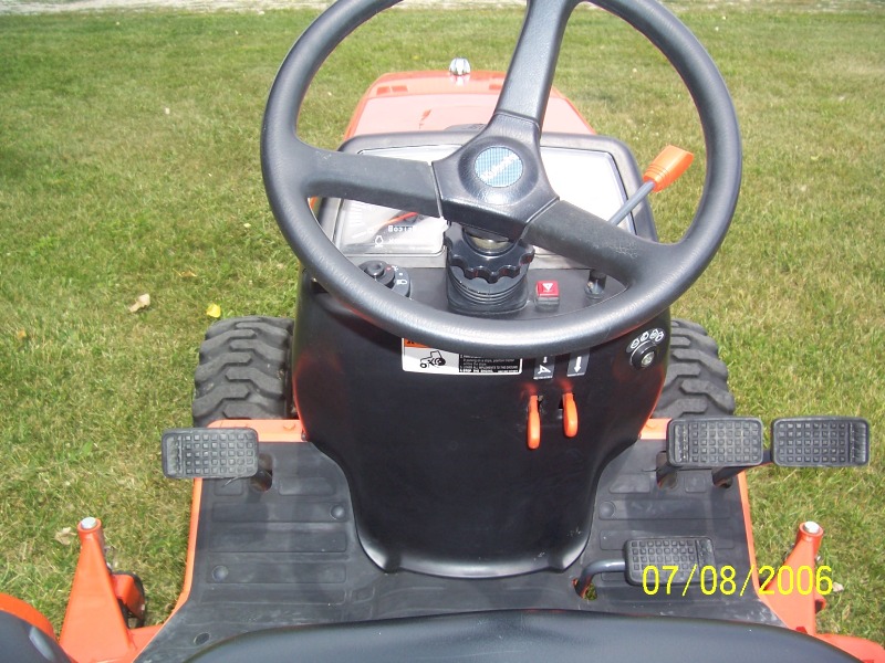

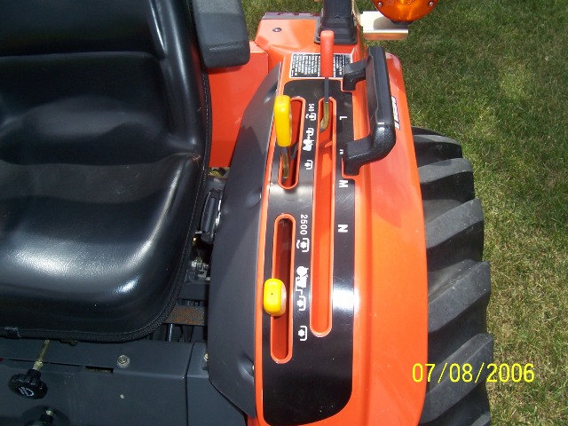

B2910 also has tilt/telescoping steering wheel, suspension seat, cruise control, clutch pedal to control PTO startup, telescoping 3pt arms with telescoping pinned stabilizers. They are actually better equipped than their successor, the B3030. You'll soon learn how valued they are if you start shopping for one. They rightfully bring a good price. :)

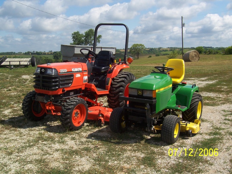

Here's some pics of the B2910 I used to have.
Here it is parked beside a JD455 for size comparison.
