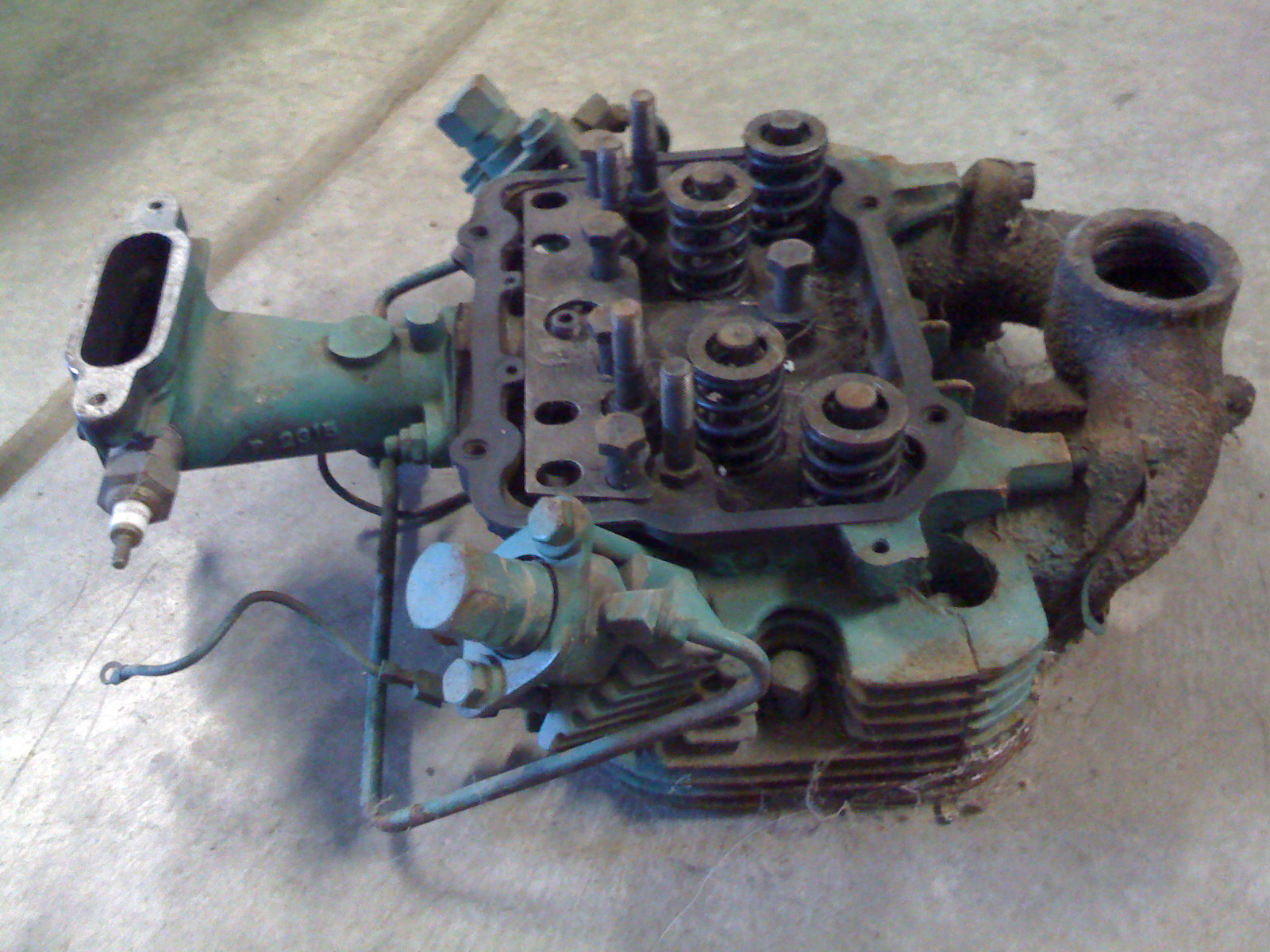

Wow, your Onan must be completely rebuilt with a new generator head on it. I have 2 of the orange 6KW 2 cylinder Onan generators. They leak oil like crazy, make as much noise as a freight train and put out terribly 'dirty' power. I happily sold both during our last power outage due to the ice storm. I had stainless steel half barrel beer barrels for fuel supplies and 2X2" square tubing with wheels on each. They were okay back in their day, mostly designed to run lighting, but are incapable of running any modern electronics.
I don't know where you get 25 hour oil changes on gas units either. :confused: I can post pages from my Honda generator and my Yamaha powered generator and they both have 100 hour oil change intervals. The very first oil change is due much sooner due to the break in process, but after that it's 100 hours for standard oil and 200 hours for PAO synthetics. My Honda generator ran 24/7 for almost 14 days straight and would run right at 14 hours per tank of fuel. I only shut it down to refill the fuel and check the oil (which it never used any). I did go ahead and change the oil at about 100 hours. It took all of 3 or 4 minutes to change.
I think you're a bit overboard on busting the guy's chops who had to buy some sort of generator in recent disasters. I'm sure there may be some completely junk Chinese made generators that don't run well, won't last long and put out as dirty of a power supply as my old Onan diesels, but it would be the exception rather than the rule. I'm 100% certain that I upgraded in generators from the old Onan diesel. BTW, if you need parts for the 6KW Onan 2 cylinder diesel generators, I have almost enough spare parts to build another one sans the block. They were good in their day, but they were only designed to put out power clean enough to run light stands. One of mine came off a road construction site and the other out of a Peabody coal mine. Since they were at auction, I bought plenty of spare parts. Unfortunately, with today's finicky electronics, they aren't that useful for me.
Hey, I just noticed that I had a good head for one sitting in my garage. Look familiar? This is a good head with the heating grid for one of those Onan generators.
