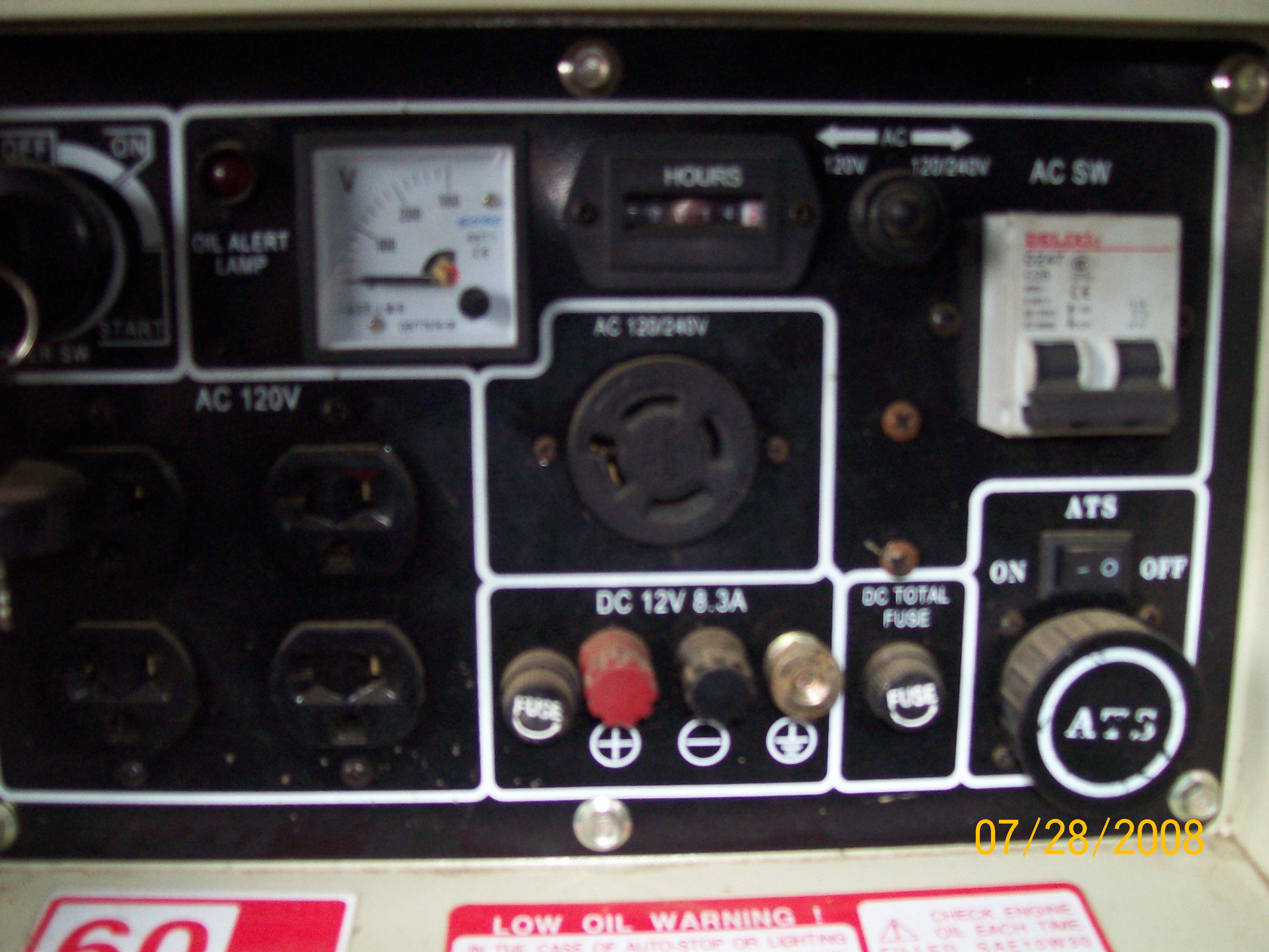

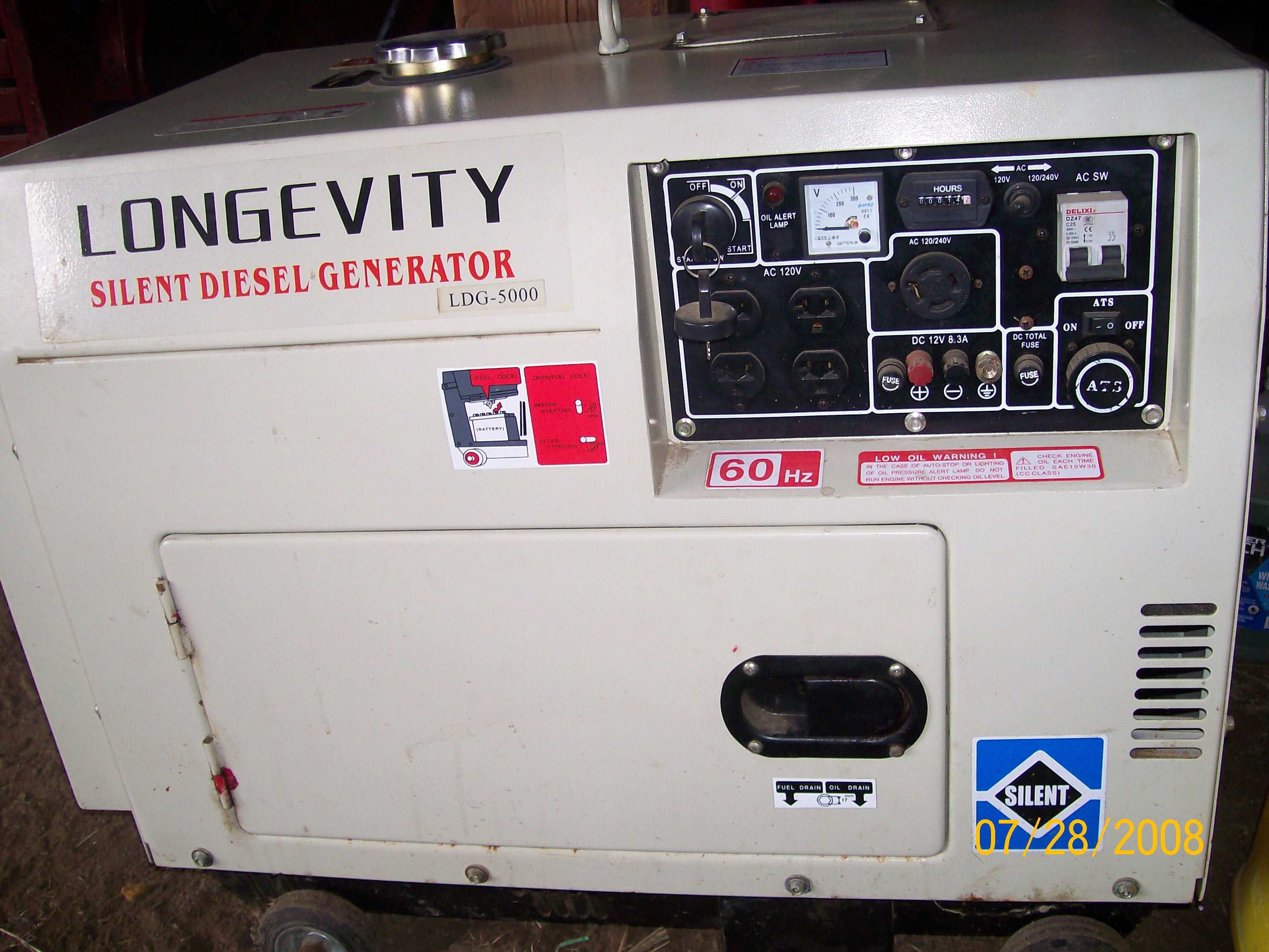

I know im looking at an old thread here but I have some input on a china made diesel generator that I own. The name on in is 5KW Longevity silent diesel generator I bought on ebay for 800$ delivered. The generator would blow the total DC fuse everytime it came off of higher revs. After some perseverence the california based company that was importing them sent me a whole new electrical panel including all of the wiring, I removed the enclosure cover and replaced the entire panel. I have pics of the generator torn down also if anybody is interested. That fixed my fuse issue. I want to say to anybody shopping for a china diesel engine, needs to change the oil very frequentally during break in peroid. I have 30 hours on my 2007 (year) generator and have changed the oil every 10 hours including blowing out the oil filter,fine metalic shavings were flushed out every time. But the engine starts and runs very nice.
