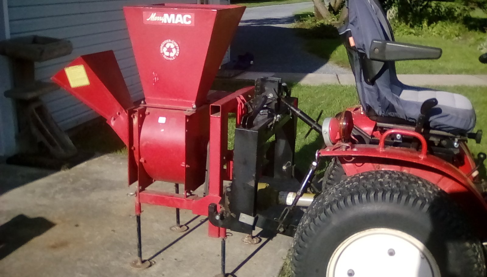

They now carry another brand, MerryMac. Less powerful for a higher price.
https://www.northerntool.com/shop/tools/product_39811_39811

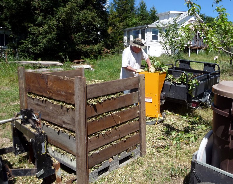

I bought HF's shredder with the 5.5hp gas engine when I had a major landscape pruning project, and more than a trailerload of material to convert to mulch. I found it would only take soft green material up to about 3/4", a size you could break over your knee or cut with loppers. Larger material had to be fed very very slowly. Maybe several seconds per inch. The thing was more a frustration maker than a useful tool. I spent most of an afternoon mulching the heavily loaded trailer in the photo below.
I also learned it was suitable only for the long straight green material I bought it for. This is an orchard, with lots of pruning debris that is larger and generally has a crooked shape that won't go in the mouth. So its useless for orchard work.
Finally this particular HF design had a low-oil shutoff that made it impossible to keep running. That was so sensitive that as engine vibration made it settle slightly into the ground it would shut down. It needed a sheet of plywood beneath it, carefully shimmed to perfectly level, to run at all.
Hopefully HF's more recent model works better!

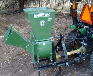

The YM 155D at 1146 # is a bit light to carry the WM WC46 chipper unless you only run it on level ground. It's very noticeable back there on the 1600ish # 2025R.
A lighter chipper/shredder would be the MacKissic TPH-123. I had a TPH-122 for 16 years. It's one of the lighter weigh ones. A guy bought it and is using it now on his 3 series JD.
That "Merry Mac" that others posted a picture of looks like the Mac TPH-122.
