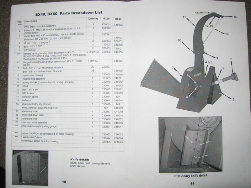

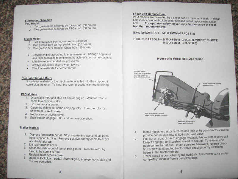

Hello all, I am a newcomer to tractoring and have a question about a used Wallenstein BX 40 chipper that I've been trying to use. There is of course no manual.
When chipping branches up to around 2" everything is OK. But when I try something near it's rated capacity of 4" the shear pin shears. I've gone through 3 pins in less than an hour's work.
The first question that I have is what are the shear pins supposed to be made of? I've been trying to play it safe by using grade 3 (no lines) 5/16-18 bolts that are mild steel.

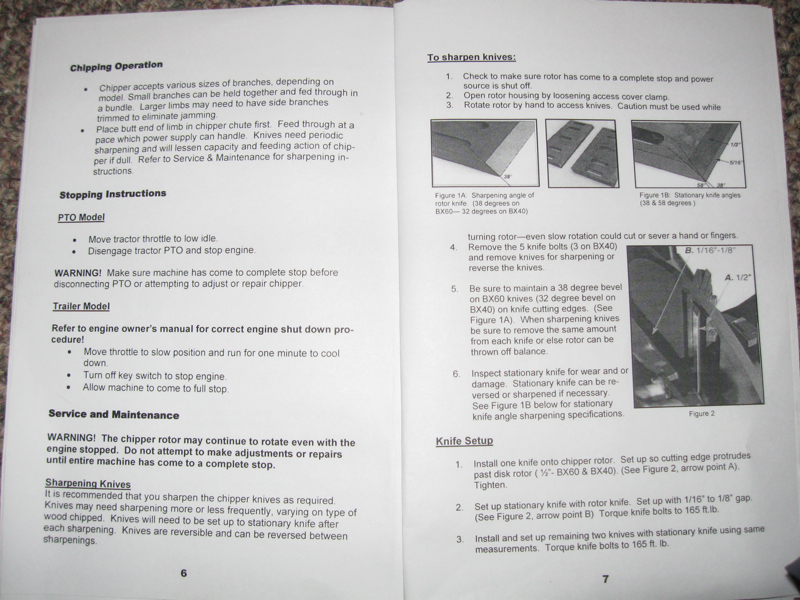

The second question is what is the procedure for setting the blade clearance? I read that it should be 1/32 to 1/16" but I don't know where that is to be measured at. The chipper seems very aggressive and whacks off about 1/2" per blade. Could that be too much? Does blade clearance effect chip thickness or is it determined by the amount that the blades protrude through the disc?
Any suggestions would be appreciated.

I also bought a used BX40 this summer. I have a kubota B3200 and I can bog down and stall out with full capacity spruce. No shear pin issues.
I also have a wallenstein manual and what looks like the original shear pin in the PTO shaft. Is the PTO shaft original to the unit - no idea!
The manual seems to suggest the shear pin is Gr 8.8 M8 x 45mm.
Two photos attached that may help, one of the manual and one of my possibly original bolt that has no markings.
Craig
/ Chipper Question From Newbie #10
Mike
Just noticed the rest of your question and realized I should read my manual properly. Attached are 2 more pages that should help...
Soon I'll have photographed the whole manual....

I have had a Wallenstein BX42s direct drive chipper, NO drive belt, NO hydraulic feed, for three months. I have used it quite a lot, maybe 50 hours?
I run it behind my Kubota B3300SU 33 engine hp/ 25 PTO hp with no issues.
This is really basic, but have you inspected the chipper blades? There are four blades on the drum and one stationary blade that is adjustable for chip thickness....my manual recommends 1/32" clearance.
I think it is likely your blades are dull, chipped and or rusty and that is where your chipper stress is coming from. On my current model you only have to remove one bolt and loosen two nuts on the rotor housing to get a good look at the four chipping blades. Another possibility is that the chipping blade to stationary blade gap is too wide.
The four chipper blades have two usable edges. The stationary blade has four cutting corners. If any of the blades do not look really good, see if the other end is better. In a used chipper, all the blade edges could be dull. Your local machine shop should have the equipment to sharpen chipper blades. But if the blades are banged up do not try to sharpen them.....buy new blades and attachment hardware together. You may find the existing blades are not from Wallenstein or for another model of Wallenstein......and the basis of your frustration.
